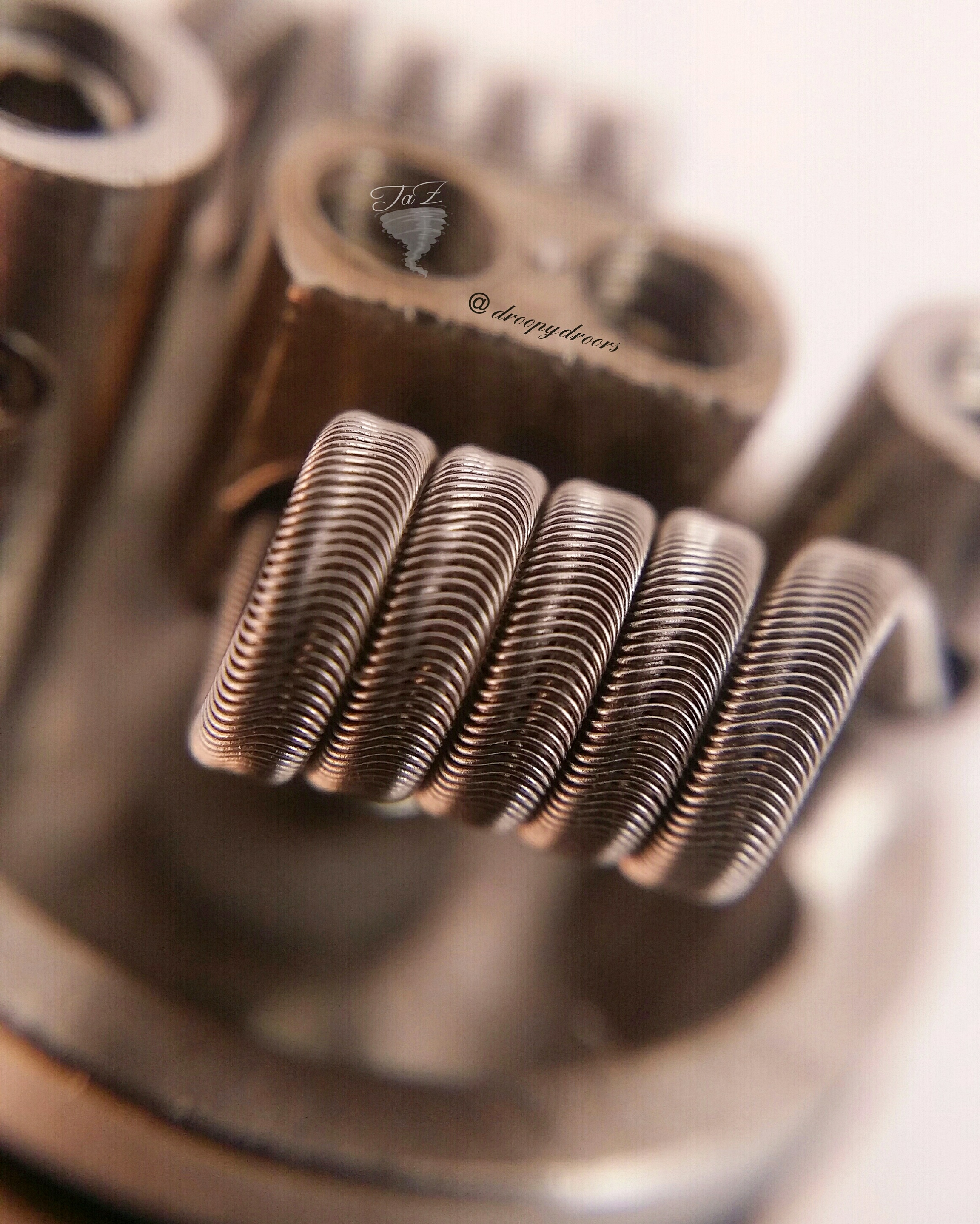

Droopydroors Posted September 23, 2015 Author Report Posted September 23, 2015 Remember back in the day when we had to use that really thin wire and have spaces in between each wrap!!!!????? Those days are over!!! First custom temperature regulated coil I made for my DNA200. Specs Dual2x28 Ni200 Core / 38 N80 Fuse / 3.5mm id / 8-9 wrap / .04 ohms / custom TCR from Steam EngineThis thing runs like a dream with zero dry hits and hella flavor!!!

mcrg8630 Posted September 24, 2015 Report Posted September 24, 2015 Droopydroors said:Remember back in the day when we had to use that really thin wire and have spaces in between each wrap!!!!????? Those days are over!!! First custom temperature regulated coil I made for my DNA200. Specs Dual2x28 Ni200 Core / 38 N80 Fuse / 3.5mm id / 8-9 wrap / .04 ohms / custom TCR from Steam EngineThis thing runs like a dream with zero dry hits and hella flavor!!! On your next build, can you please capture on vid and share? I would love to recreate your work to try something new. I just want to see the pain and effort it takes to make one. It'll probably motivate me to try something and/or point of reference in the even I run into an issue.
JaySoCal Posted September 26, 2015 Report Posted September 26, 2015 Not a hard build once you get the hang of it per say. Just Google fused clapton tons of vids on how to do it. Just practice and patience. Awesome coil btw.
Droopydroors Posted September 26, 2015 Author Report Posted September 26, 2015 This is the coil I am running in tc at the moment. Mostly all the bugs are worked out. Specs on Dual coil 2x22g SS 316L core / 38g n80 wrap / 3mm id / 4-5 wrap / .053? Escribe settings .053 ohm locked 380 F 90 watts Preheat 150 watts for .8 sec Punch 5 Custom TCR Video to come.
