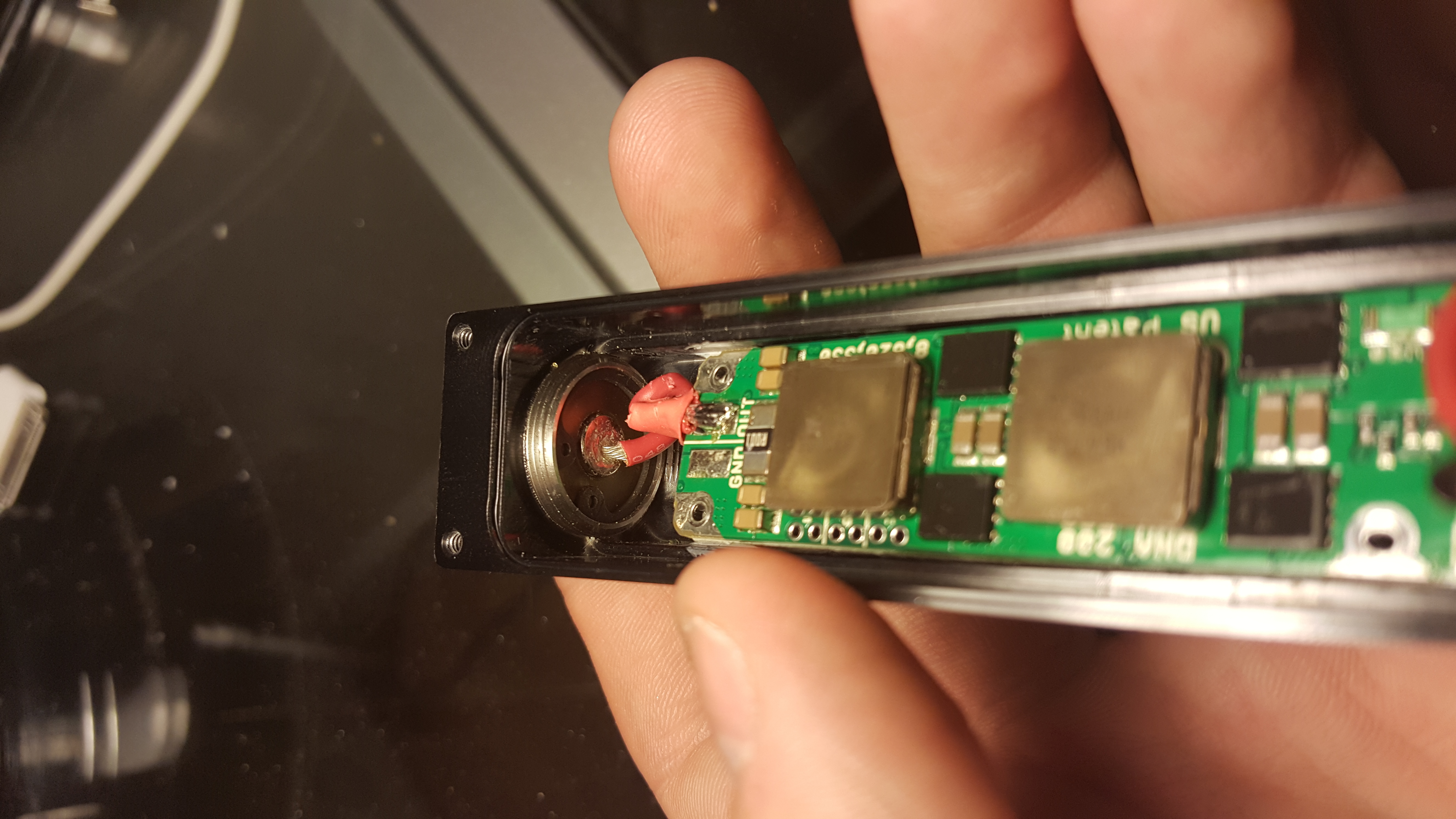

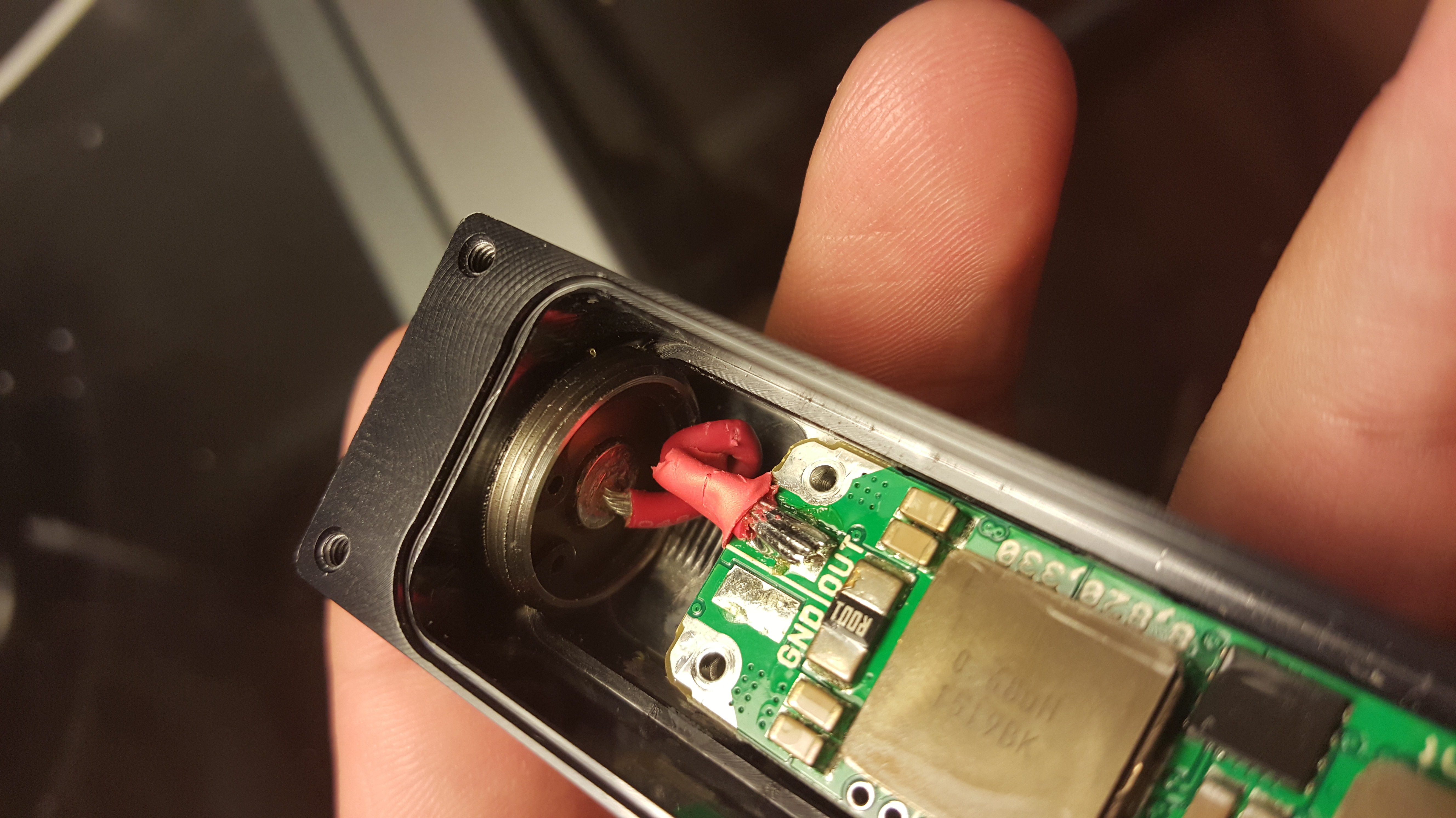

monster92 Posted August 6, 2015 Author Report Posted August 6, 2015 Tomr1088 said: [QUOTE=Wake-N-Vape]Monster, yep, so far my screen seems to be ok... I did not take the board screws out to physically check it out, but I would guess that it is probably ok seeing the positive and negative leads are soldered to the board. Hopefully they started doing that after fixing the screen issues? But, I am definitely on the look out for any weird happenings with the screen. Expand Can u confirm if removing that circlip will allow me to side the 510 pin out for soldering a new wire [/QUOTE] Tmor more then likely because as stated when the c-clip wasn't in place the 510 was practically out. Take note there's probably a spring on top of it. Possibly...
Wake-N-Vape Posted August 6, 2015 Report Posted August 6, 2015 Tomr1088 said: Can u confirm if removing that circlip will allow me to side the 510 pin out for soldering a new wire Expand I did not try to pull the whole assembly out when I had the case open since I did not remove the board. But, I do believe that it would allow you to slide out the 510 pin assembly with the circlip removed as long as the wire is flexible enough to slide it out without damaging the wire.
Tomr1088 Posted August 6, 2015 Report Posted August 6, 2015 Wake-N-Vape said: [QUOTE=Tomr1088]Can u confirm if removing that circlip will allow me to side the 510 pin out for soldering a new wire Expand I did not try to pull the whole assembly out when I had the case open since I did not remove the board. But, I do believe that it would allow you to slide out the 510 pin assembly with the circlip removed as long as the wire is flexible enough to slide it out without damaging the wire.[/QUOTE] I am going to be changing the wire and properly soldering it in hopes of fixing my resistance reading problem. I have snap ring pliers so I'll prob do that later today and report back. I may have to actually go buy some de soldering components and a new soldering iron now. Hopefully locally I can get one
monster92 Posted August 6, 2015 Author Report Posted August 6, 2015 Wake-N-Vape said: [QUOTE=Tomr1088]Can u confirm if removing that circlip will allow me to side the 510 pin out for soldering a new wire Expand I did not try to pull the whole assembly out when I had the case open since I did not remove the board. But, I do believe that it would allow you to slide out the 510 pin assembly with the circlip removed as long as the wire is flexible enough to slide it out without damaging the wire.[/QUOTE] One thing that I'm not happy about is no matter what atty I screw on it doesn't sit flush. I mean it's not that big of a deal but still. Pretty sure I know why. It's one of two things. Because of the size of the battery the 510 hits the battery. Or there's just so much solder over flow that it makes it difficult for the 510 to "spring". Or a mixture of both.

Tomr1088 Posted August 6, 2015 Report Posted August 6, 2015 Update: re soldered my 510 wire. Tried 14 gauge silicone insulated but it was too thick so I used 16 gauge. I won't be going to 200 watts anyways. But still getting a base reading of .16 ohm on a build that reads .04 on everything else. I notice as soon as I fire it reads .06 tho and creeps up till I get to .12. I have the same settings for both mods. Maybe I need to run the case analyzer because the Hana maybe came with different settings? I'm not sure what's going on but it reads solid no matter what. Just way off.
