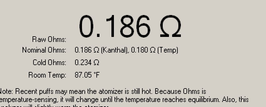

This has just come up in what has been an otherwise correctly working mod.
The above shows what the mod looks like when the issue arrives.  It is a .17 ohm build, but the board will occasionally see it as .23.  How can it read .186 and calculate a cold ohm value of .234?

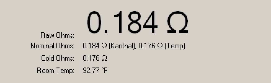

Giving it a hard reboot, resets it:
Is this a case calibration issue or????
The issue is a PITA as it requires a computer to overcome, or a manual change to the set temp to keep vaping.
I know my way around the board and building TC atomizers and this one has me stumped.
