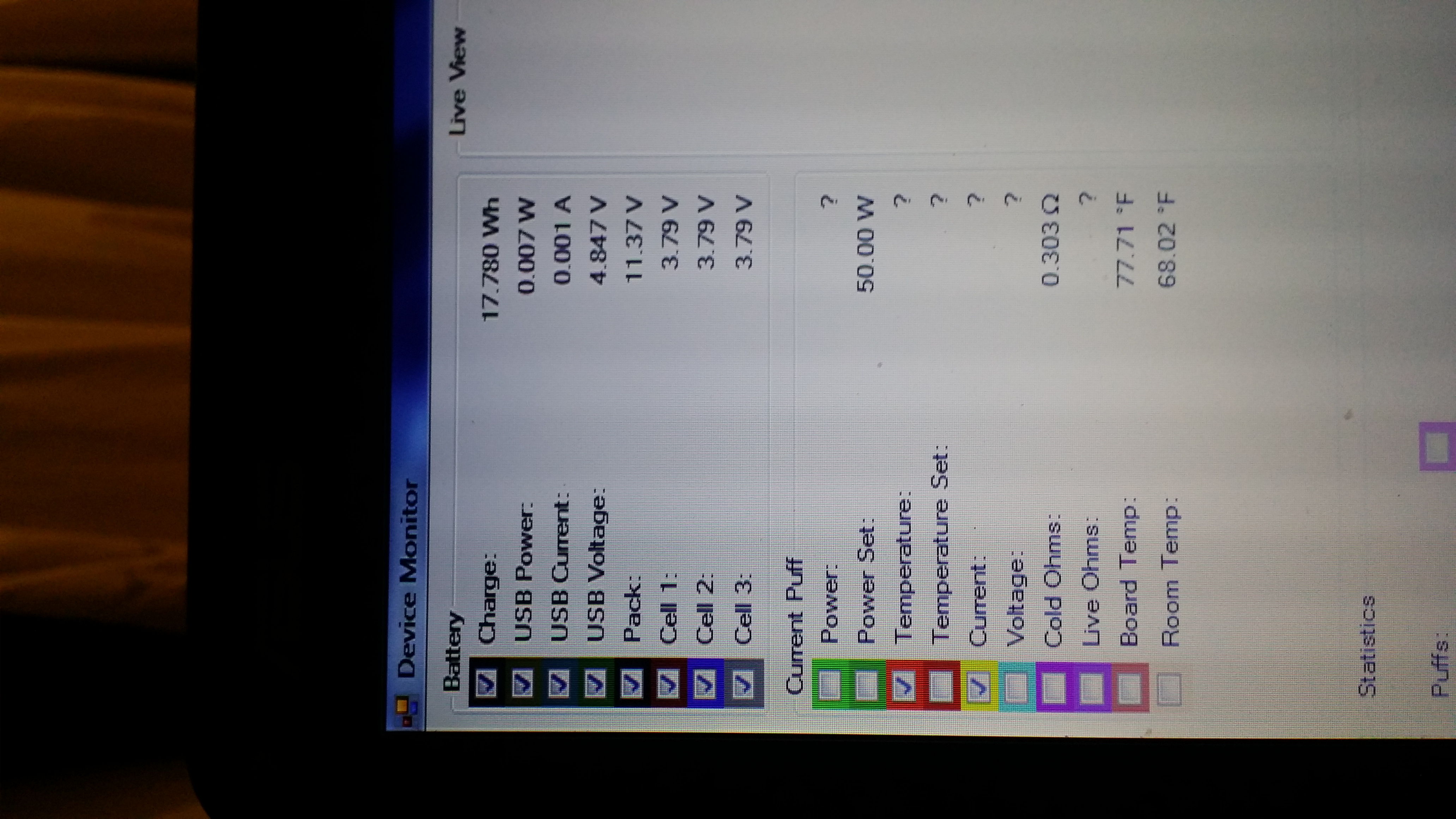

Tried to charge my wismec with a 1amp USB with LG HB2. They were about 40 to 50 percent. The charge symbol showed but after checking the unit aftet 6 to 7 hrs no change in charge. Any ideas? The unit had the battery test run on it with them in it so setting should be good.
The no change is disturbing, as mentioned not all USB cables are the same but connection, charging rate (Amps), Battery Profile and cell condition all can play a role. Ideally you want to see 0.9X Amps, and >4.X Volt charging.
In the Screen tab of Escribe, note the original settings, and for now I'd recommend: Battery Charge %, USB Voltage, and USB Current plus Charging Brightness of >25%.
Before charging more, connect and run Escribe, attach an Atty; click Device Monitor and in the bottom right click on the 'Puff' and run it for a few seconds as shown below. All 3 Cells 'should' have very close Voltage changes with no apparent big gaps.

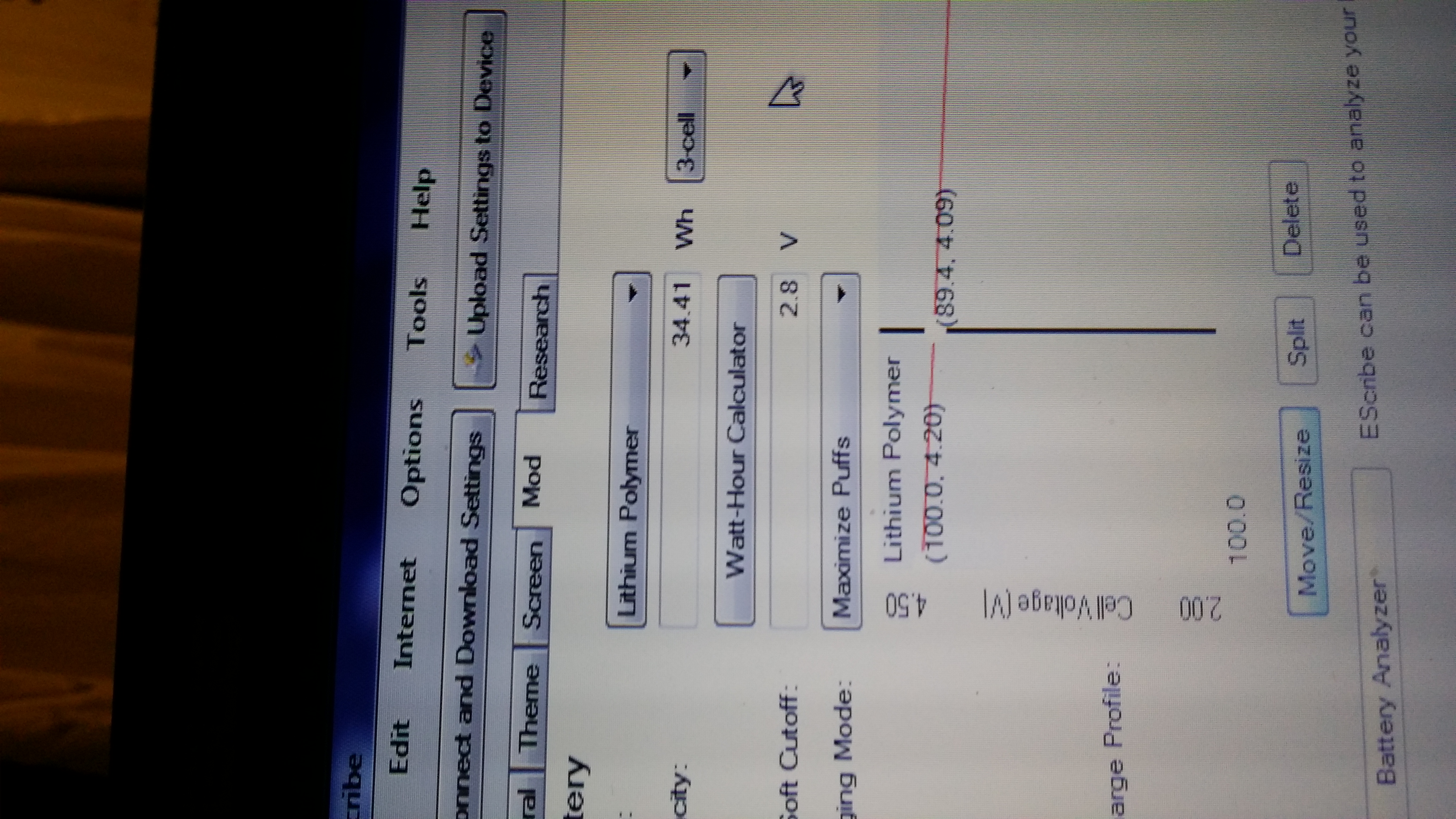

morgo said:
I have tried the reset USB current limit but I haven't tried to put 500 in I will try that next and report back
the thing is when you click the 'reset the usb current' option , it should do just that. go ahead and type in 1 for the usb current setting. once again don't know if this was mentioned further back........have you tried a hard reboot, reflash the newest firmware, or different batteries? could it be your usb cable? have a bunch more to try out with a 1 amp wall wart?
what kind of batts are you using that are coming out to over 34 watt hours?  if they're 3000 mah batts try 28 watt hours. see if that does something. you should run batt analyzer, (if u haven't already.)
Link to comment
Share on other sites
Hello mate I was using efest 3100 that come with it. I bought LG 3000 today waiting for them to fully charge then I'm going to try them. I have done a reflash with the newest firmware for some reason the hard reboot will not work. I've tried a number of different cables and wall charger I'm going to try the new battery's got my fingers crossed. Thanks for your help I will be lost without the help of you guys on here
