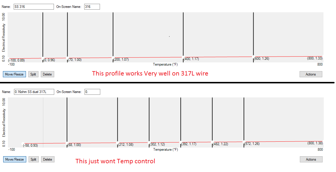

PipSpawn Posted February 16, 2016 Author Report Posted February 16, 2016 Sorry if its bad of me to start a new thread about SS but i have had something odd happen.Since i have done the recent update my SteamEngine CSV i made for my SS317L wire has stopped temp controlling.I go to fire it and the temp on the screen just goes to 'OFF', if i'm not mistaken this means its running in wattage mode, Its not sensing a temp control setup.Used to work fine...... It seems to now only behave on the preloaded 316 setting.The even odder thing is the preloaded 316 appears to behave 10x better than my original CVS.This is the wire i'm usinghttp://www.wireandstuff.co.uk/products/317L-Grade-Stainless-Steel-Wire---0.5mm--500-Micron---24-AWG----25-Metre-Spool-154.html7 Spaced wraps on a duel coming out at 0.16ohmAny ideas why this might be happening?Have attached an image of both profiles, only thing i can see is my custom profile doesn't seem to start at the start of the graph.

PipSpawn Posted February 17, 2016 Author Report Posted February 17, 2016 retird said: Can you post a screen shot of one of your profiles? Expand The wire profile?Its in the OP, the bottom half of the pic attached is my wire profile.
