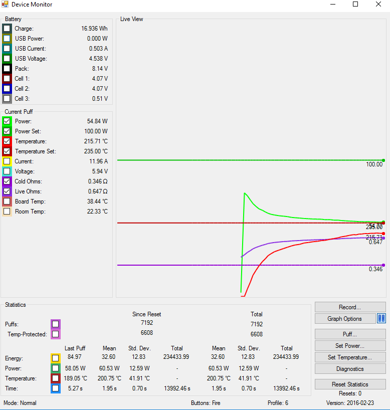

timbomfg Posted March 23, 2016 Author Report Posted March 23, 2016 Spirometry said:Check Cell #3Yea.....about that.....
VapingBad Posted March 23, 2016 Report Posted March 23, 2016 I think it may be hitting a 6 V limit for 2 cell operation, I have not seen that specified, but it's 9 V for 3 cells so seems logical to me.
dwcraig1 Posted March 23, 2016 Report Posted March 23, 2016 That comes out to 6.17 volts, looks like you nailed it VBEDIT: it appears that I plugged in some wrong numbers into the calculator...5.96v it is.
VapingBad Posted March 23, 2016 Report Posted March 23, 2016 Cheers, it said 5.96 V in device monitor, but it don't help the guy unless he has a 3 cell DNA as well.
VapingBad Posted March 23, 2016 Report Posted March 23, 2016 OP did say it was a VT133 as well, I only have 3 cell DNA200 so I must have just tuned that out and it just didn't occur to me until I saw the screen shot.

VapingBad Posted March 24, 2016 Report Posted March 24, 2016 timbomfg said:Unless i'm misinformed, shouldn't it be doing its voltage/amperage calculations based off cold ohms though, and regulating using the hot-ohm calculation? 0.4ohm at 6v is still 90w and it never even reaches that.I can now confirm it plays ball fine on 3 different Joyetechs, the XCube2, the Sig150TC (in power only mode), and even my old ratty BT65This has not been confirmed, but I am 99% sure it it your issue: the DNA 200 is a step down converter designed to run from 3 Li cells is series and is limited to a max output voltage of 9 V. After multiple user requests in this forum Evolv released firmware that allowed it to operate from 2 series cells at reduced power (133 W). It is the input voltage that has changed and it does not step up voltage the max output voltage has also changed to 6 V for 2 series cell implementations. So you need a resistance between 0.0532 ohm and 0.27 ohm for 133 W (max power) in this mode. You want 75 W in 2 cell the max res = 0.48 ohm, in 3 cell = 1.08 ohmV squared over power
