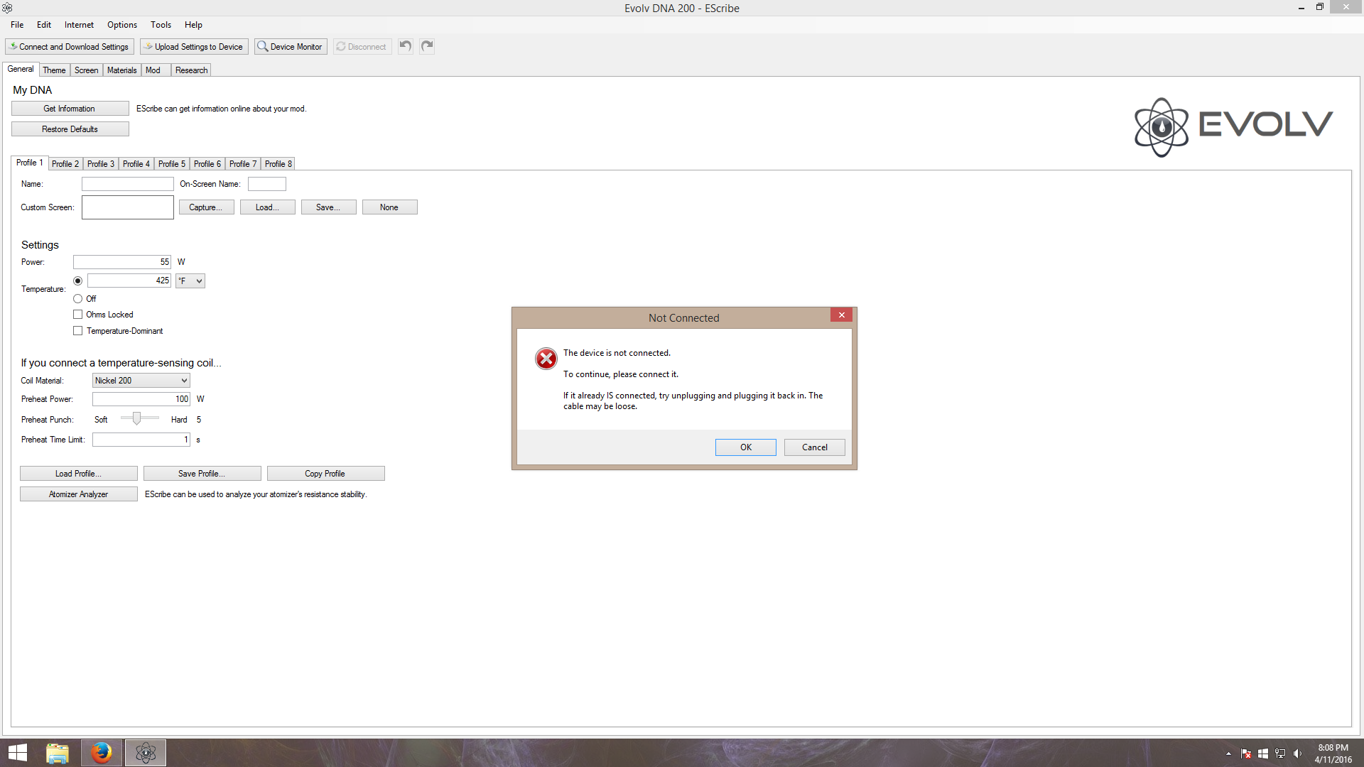

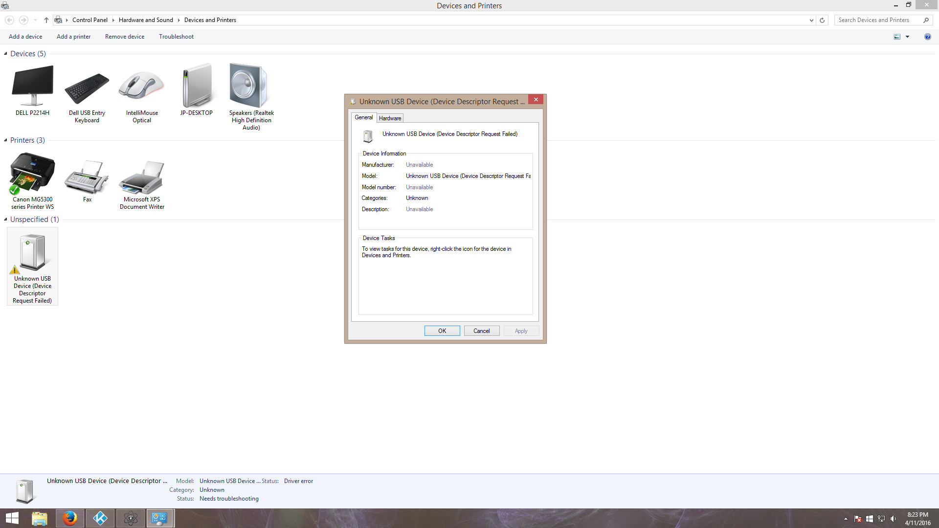

lifealert Posted April 11, 2016 Author Report Posted April 11, 2016 Device HCigar VT200, received ~Dec 1st 2015. Well, I've tried replacing the LiPo, connecting the board without the LiPo, older and newest versions of EScribe, and about 10 different micro-USB cables. When plugged in screen says 'Warranty Error' When connected to PC Windows gives an error 'USB Device not recognized' EScribe will not detect the device. Any suggestions?

lifealert Posted April 12, 2016 Author Report Posted April 12, 2016 Windows does not recognize the device, and EScribe cant connect to it.
lifealert Posted April 12, 2016 Author Report Posted April 12, 2016 Error in Windows when plugged in.
Spector NS5 RD Posted April 12, 2016 Report Posted April 12, 2016 even tho it says it's not connected, sometimes a firmware redo does work, and sometimes not. under tools - update firmware - keep hitting ok see if works.......if it keeps saying device not found then that means it's RMA time. not worth the trouble of trying to bring it back from the dead. i have heard of evolv taking in entire devices and replacing/repairing the board. just don't be surprised if asked to only send in the board.just to be clear, you have had escribe working with this mod before? as in, you remember what usb cable also has data and charge capabilities? make sure you're using a known escribe compatible usb cable.
black lace Posted April 12, 2016 Report Posted April 12, 2016 Can i add to what chunky said, if your sure it worked beffor, have you tried connecting anything els to the computer using the said same cable & port ect, most computers these days do so many things behind the screen its hard to tell when its fully booted up.. i share a computer, it could do with a tilt switch, ii dont have a problem with it myselfe, but i give it and programs plenty of time to load up.. i also notice the usb female sockets on all my mods are quite dusty even grimey and could do with brushing out with a tooth brush or somthing, to get more a sound connection.. But at the end of the day, flashing up warranty service, sounds like a get out of jail free card and ya need ta send it in..
blueridgedog Posted April 12, 2016 Report Posted April 12, 2016 Power off PC, unplug all non-essential USB, do a cold power up with the DNA200 connected, launch escribe and do a firmware update under tools. If that fails, fill out a form for an RMA.
