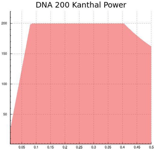

VapingBad Posted April 8, 2016 Report Posted April 8, 2016 Is the resistance near 0.18 ?, I'm just thinking that a small variation in the resistance reading of each mod could cause the 50 A output current limit to kick in before the output voltage limit.

VapingBad Posted April 9, 2016 Report Posted April 9, 2016 Opps I don't know how I put current limit that is the low end of res, it is the voltage limit at the high end and 0.4 ? is the max for 200 W in the spec sheet. So as some of the resistances are outside the spec for full power I imagine it is just sag, try it again with 0.3 ?.

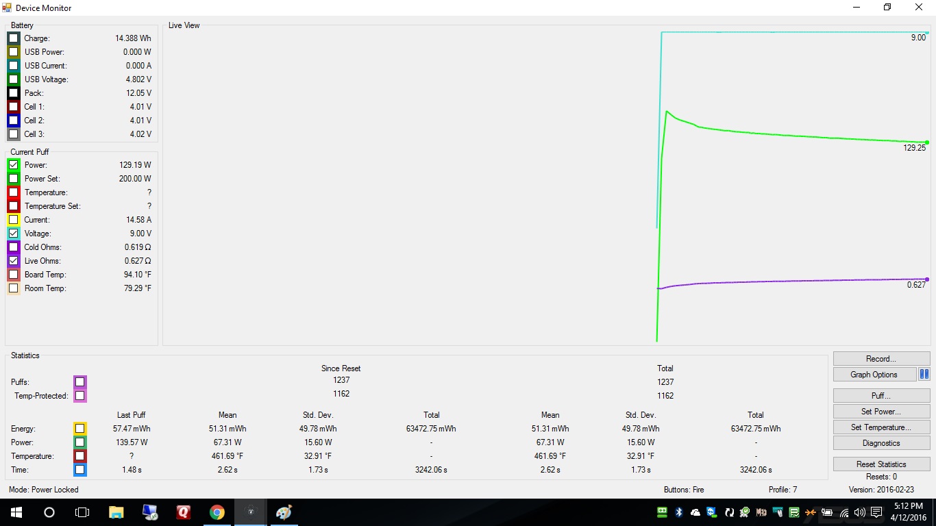

Spirometry Posted April 12, 2016 Report Posted April 12, 2016 I never said it would be recommended if you want an accurate wattage calculation. I'm just telling you how to get 9 volts output. The DNA board only outputs voltage, any adjustments for mod resistance or temperature protection has to be subtracted from that voltage. I don't quite understand why you want 9 volts so bad, if you want power, drop your resistance a bit and hit it at 200 watts. Maybe you have a possible bug fix where the 9 volt wall is based off of your raw resistance not the calculated resistance.
