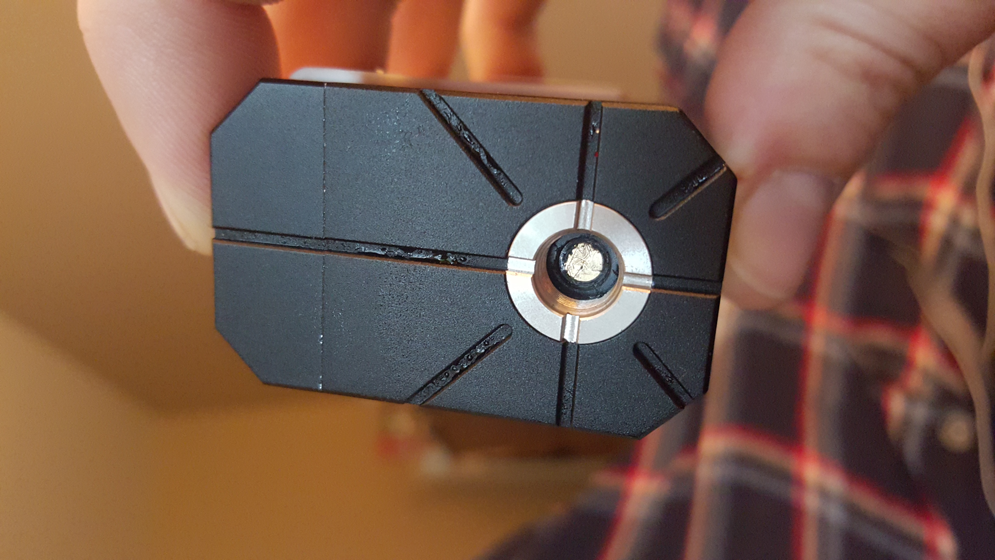

My friend dropped his Vapecig Vtbox200 with atty and the 510 got angled. If not too bad perhaps live with it. Try this at your own risk.
I placed the mod on a solid surface and using the correct size socket and a very small hammer and multiple light blows I drove it back into place.
I was worried about one of the inductors  coming off the board but all went well without a mark on it. I can't really say that I reccomend it but this is how I fixed it.

just wanna say thanks to dwcraig. didn't have a hammer handy, did have some padding and a moderately heavy screw driver.
Attached a 22mm atty, padded top and bottom to a solid surface and went at it. Removed the lipo before I did this obviously. It helped, if it was a 2mm gap now its down to 0.5mm
