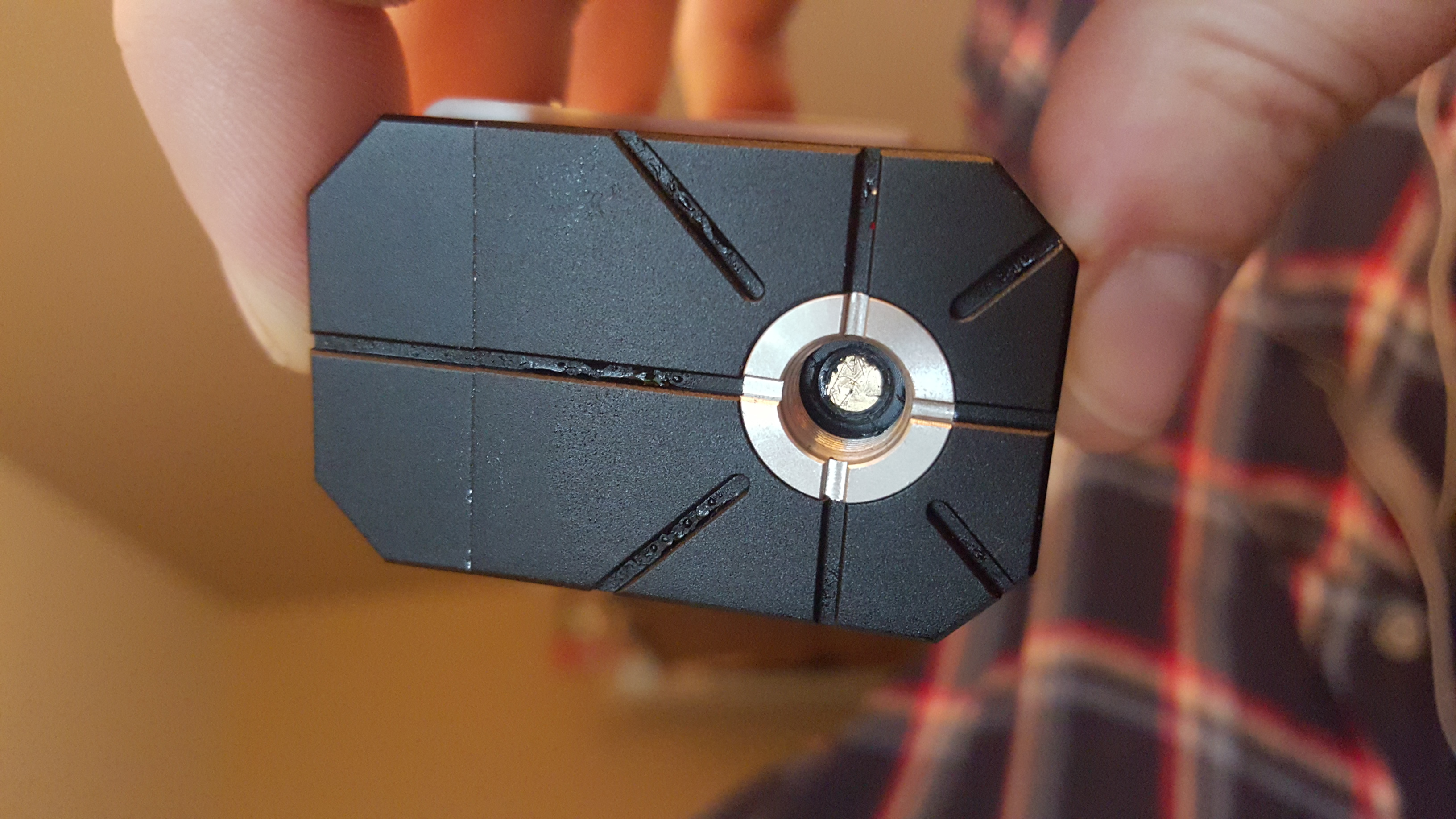

  1. Yes unscrew the white thing it will let the 510 loose. Then you can adjust it then re-tighten it down after you get it back the way you want it
  2. By just unscrewing all the screws and gently taking out the Lipo. Then pulling up the black piece covering the insides. When that's removed you can access the 510pin from the inside and unscrew it so it comes out.

  5. Yea I took it apart and the spring was stuck so I unscrewed the 510 from the inside and repositioned it back straight through the hole. Works great now. Thanks for the reply
  6. So I was screwing on my twisted messes RDA onto my lavabox dna 200 and to get it flush I screwed it down tight. Well when I unscrewed my rda I noticed the 510 pin was stuck down. So now if I put on my smok tfv4 it doesn't read it because my 510 pin won't touch it. Does anyone know how to get it unstuck? Or how I can fix this. Thanks.
