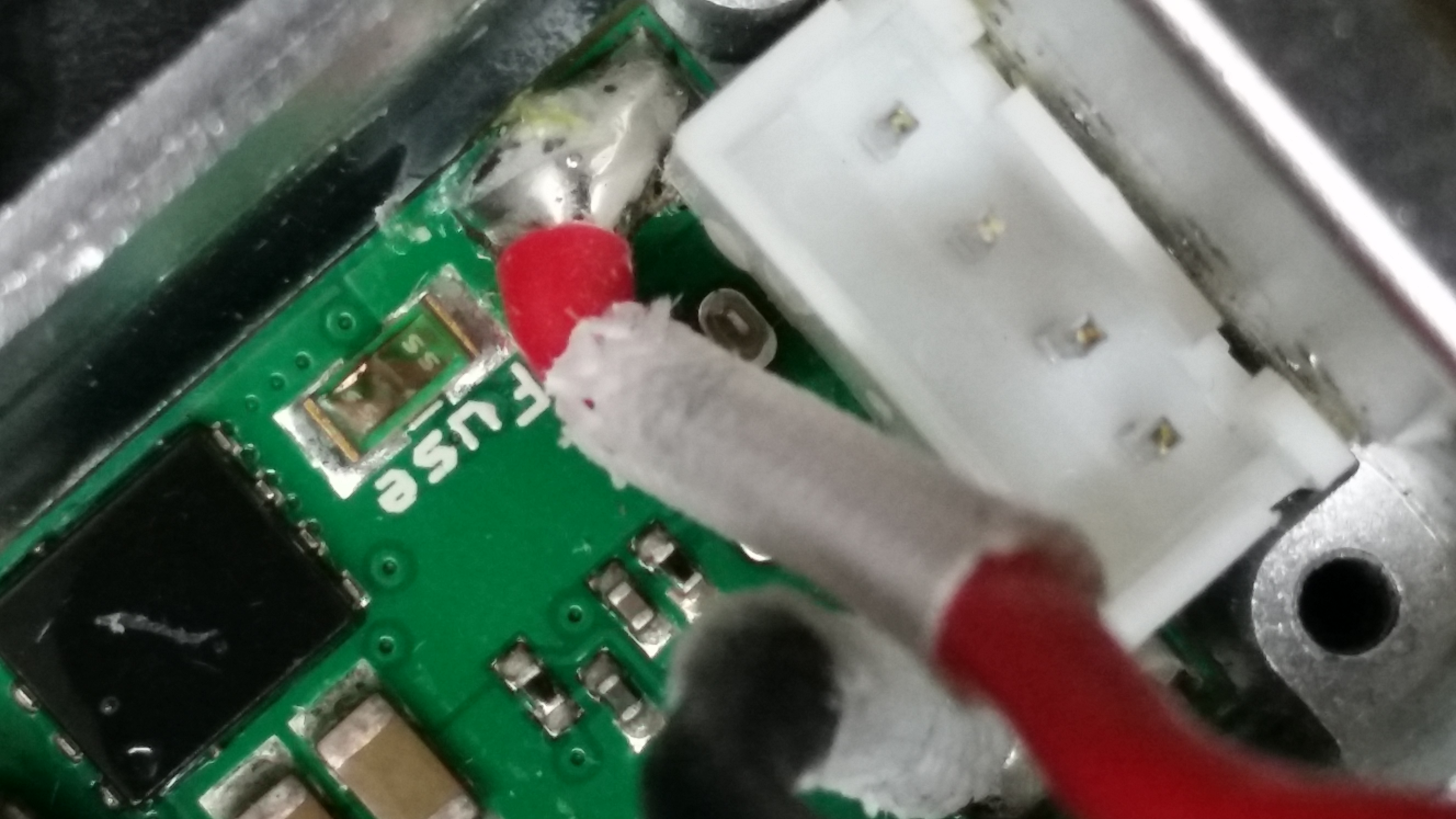

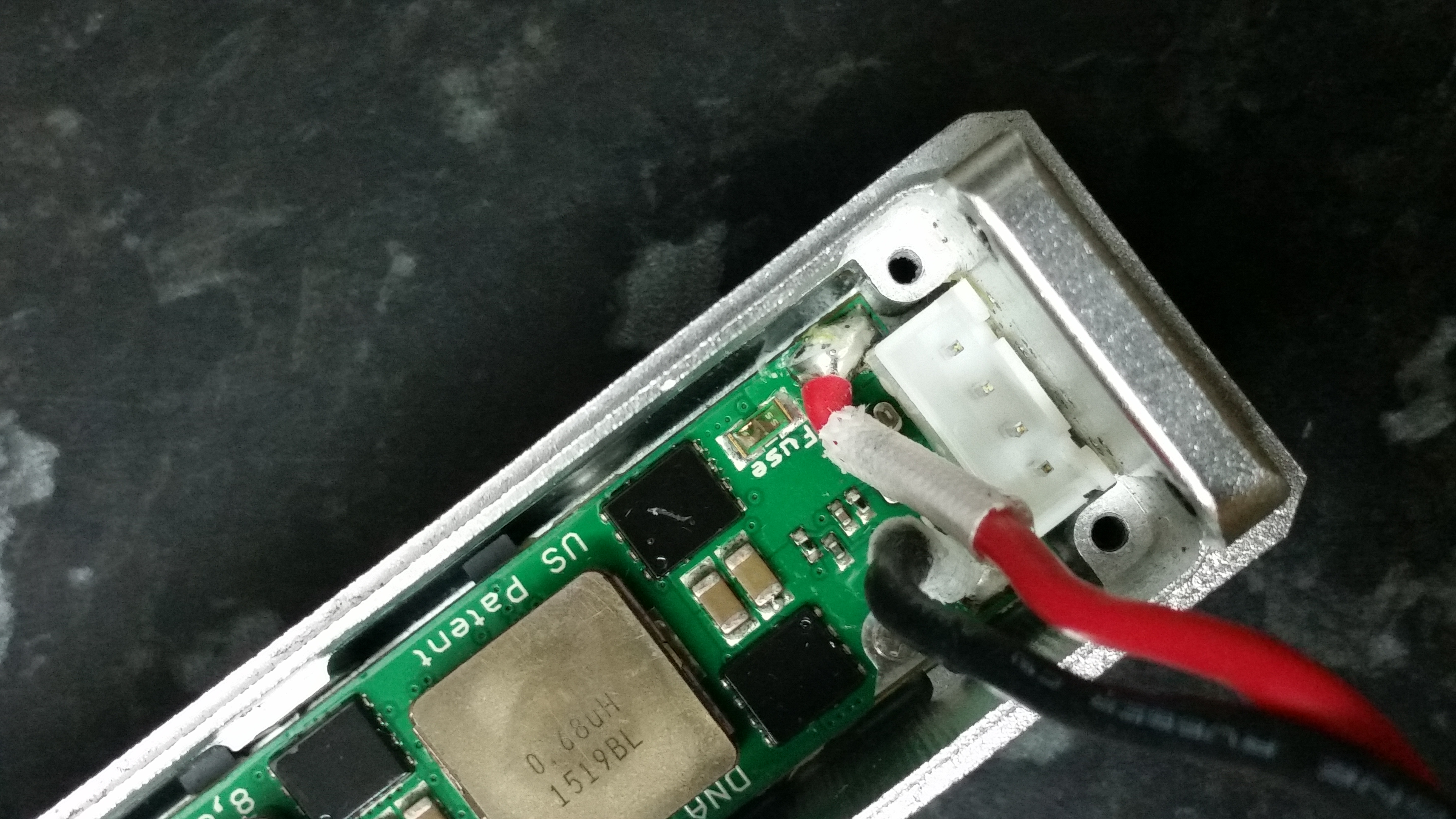

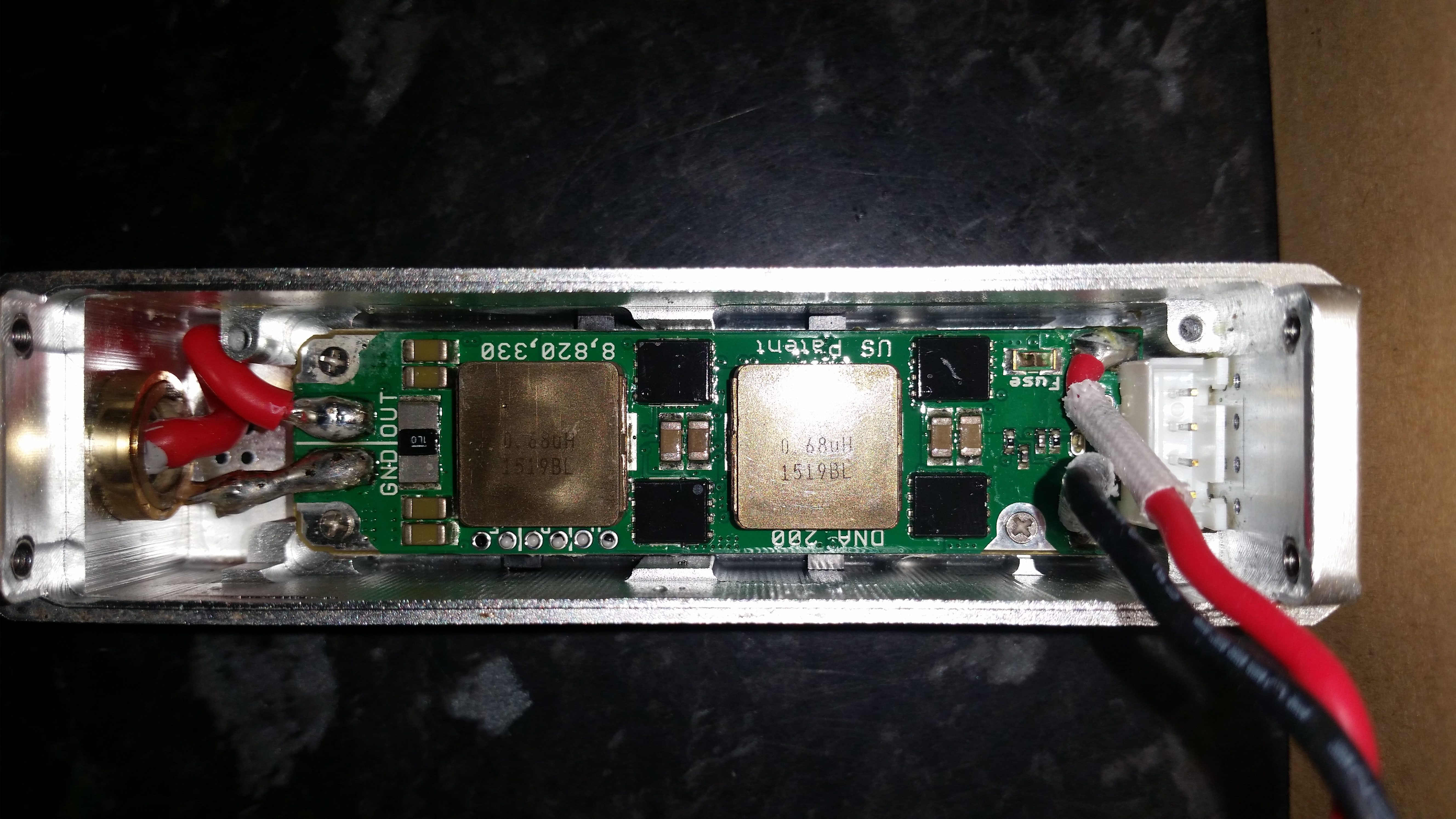

I decided to open it up and take a look inside, the board looks fine with no signs of damage but I think the fuse has definitely gone. Hcigar still haven't gotten back to me regarding this and from what I have read on the internet they seem very difficult to actually get a response from them so it looks like I am screwed, shame as I really liked this mod but looks like I'm back to using my old ipv4.

First I would try a few atties in case it's just the 510 pin sitting lower than normal, you should be able to feel it getting tight before it completely screwed in.  If it's in warranty the vendor you got it from should sort in out for you.  If it's out of warranty and you are confident with a soldering iron you could check the internal connections are all sound, if not you can ask Evolv to help by opening a ticket Help Desk - Submit a ticket.

I don't know if you get ohms too high with a blown fuse it has not happened to me, it makes sense in that there wouldn't be enough power from the USB to fire anything much.  If the fuse is blown the device will be dead when not connected to a USB supply or PC, is that the case with yours?
You can pretty much visualy tell if the fuse has now blown, I dont know how fiddly it is on yours to replace insitue, put an rma request in if your not confident,, ive done one on one of my builds, (fiddly) i never definatly got to the bottom of what caused it to blow, but the charger haddnt fully charged it for a few nights so i binned the charger and the mod is still fine after months of use..
