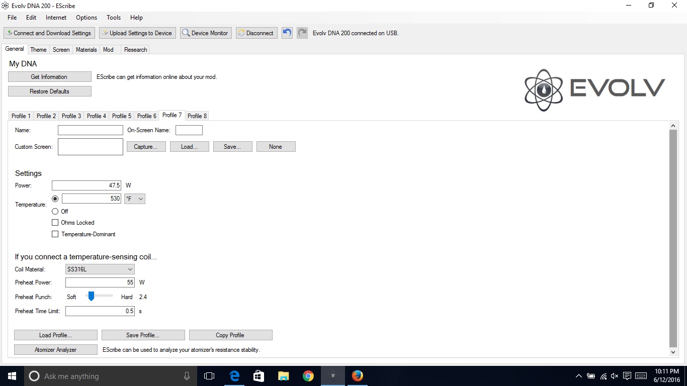

VapingDragon Posted June 13, 2016 Report Posted June 13, 2016 in my experience with temp control it takes a little tweaking to get the right vape. the dna200 is an amazing chip just takes getting use to. these are the settings i use for dual spaced coils wrapped on #6-32 machine screws 10 wraps each. flavor is great, i don't hit temp protection and don't lock my ohms.
