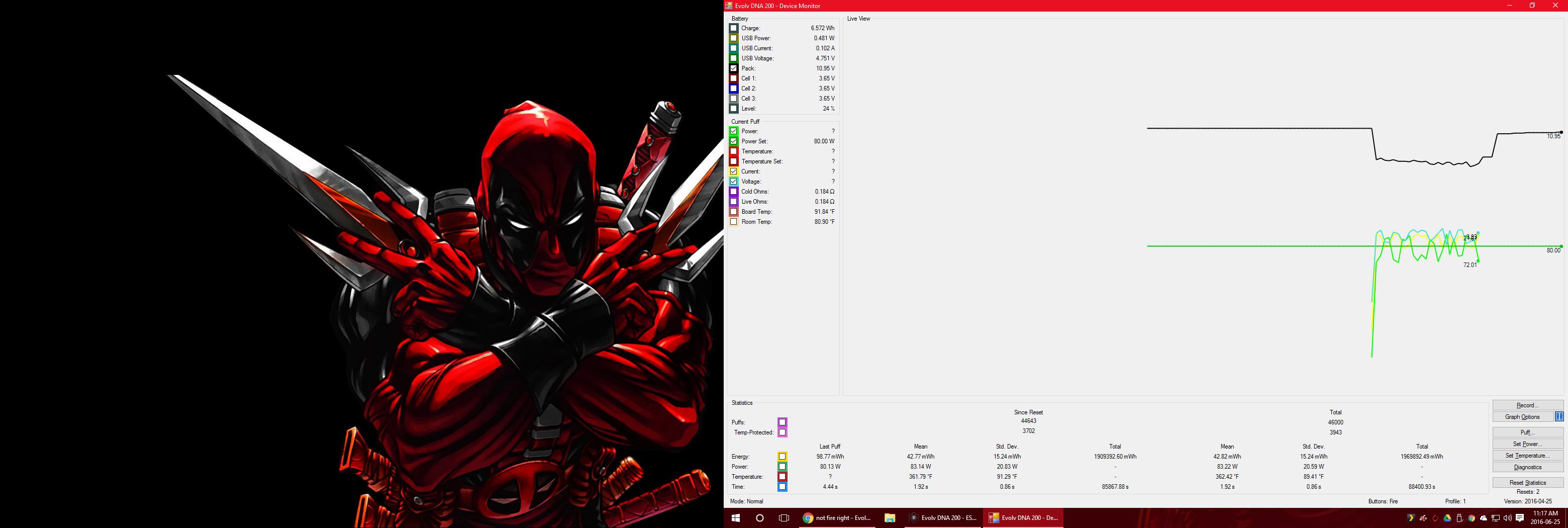

retird Posted June 25, 2016 Report Share Posted June 25, 2016 Can you put up a screenshot from Device Monitor while firing at 80 watts? Link to comment Share on other sites More sharing options...
MIsterious Vaper Posted June 25, 2016 Author Report Share Posted June 25, 2016 here is a screen shot Link to comment Share on other sites More sharing options...

retird Posted June 25, 2016 Report Share Posted June 25, 2016 From the graph it looks like the wattage is regulating with peaks above 80 watts and valleys below 80 watts so it is reaching 80 watts. Any hot spots in your coils and are they spaced coils? Coil connections tight? What results do you see if using just a single Kanthal coil? Link to comment Share on other sites More sharing options...
