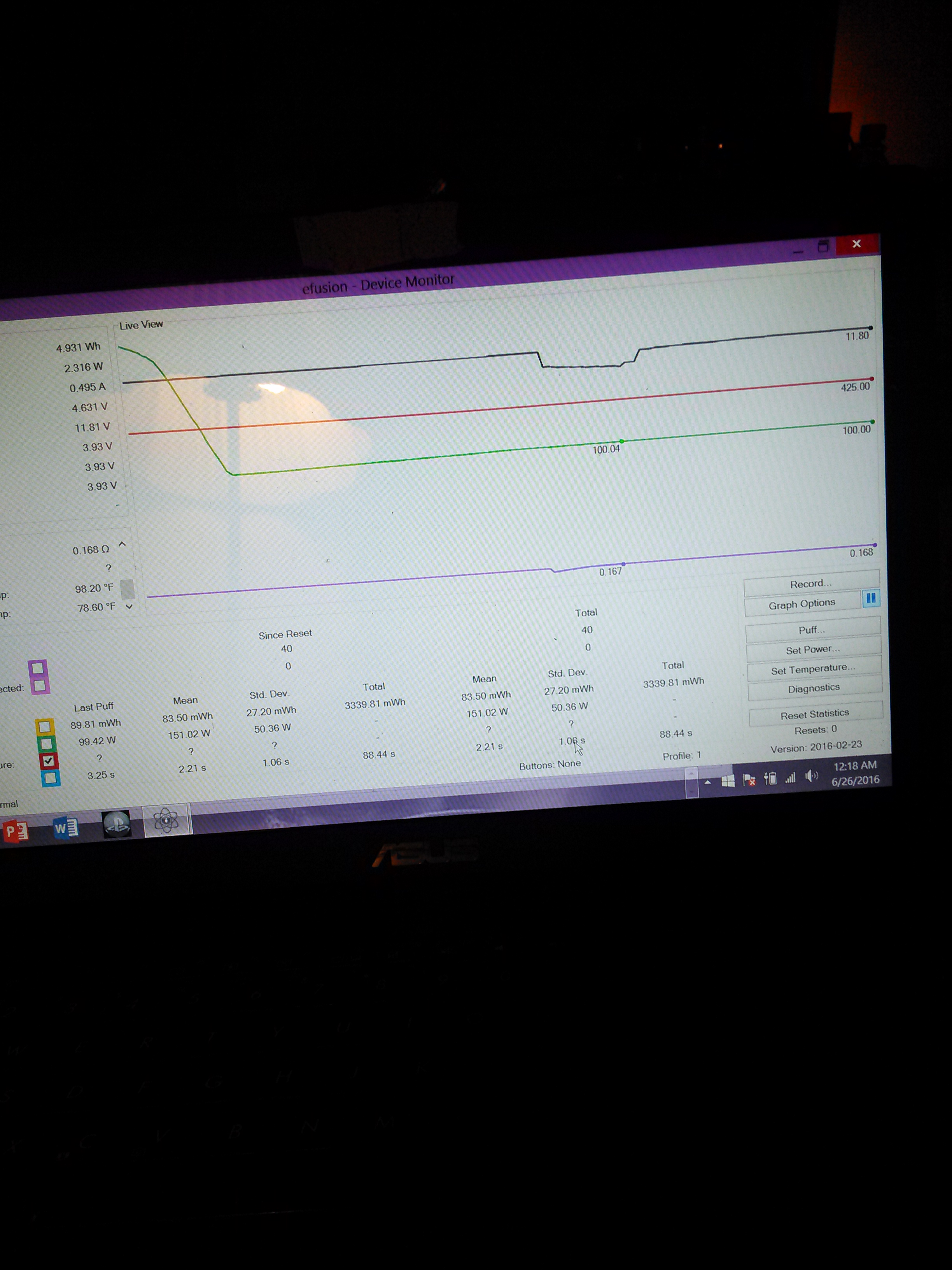

retird Posted June 24, 2016 Report Posted June 24, 2016 Can you post a screenshot from Device Monitor showing graphs while firing? You could contact the vendor where you got the device as it should be in warranty....

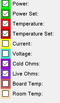

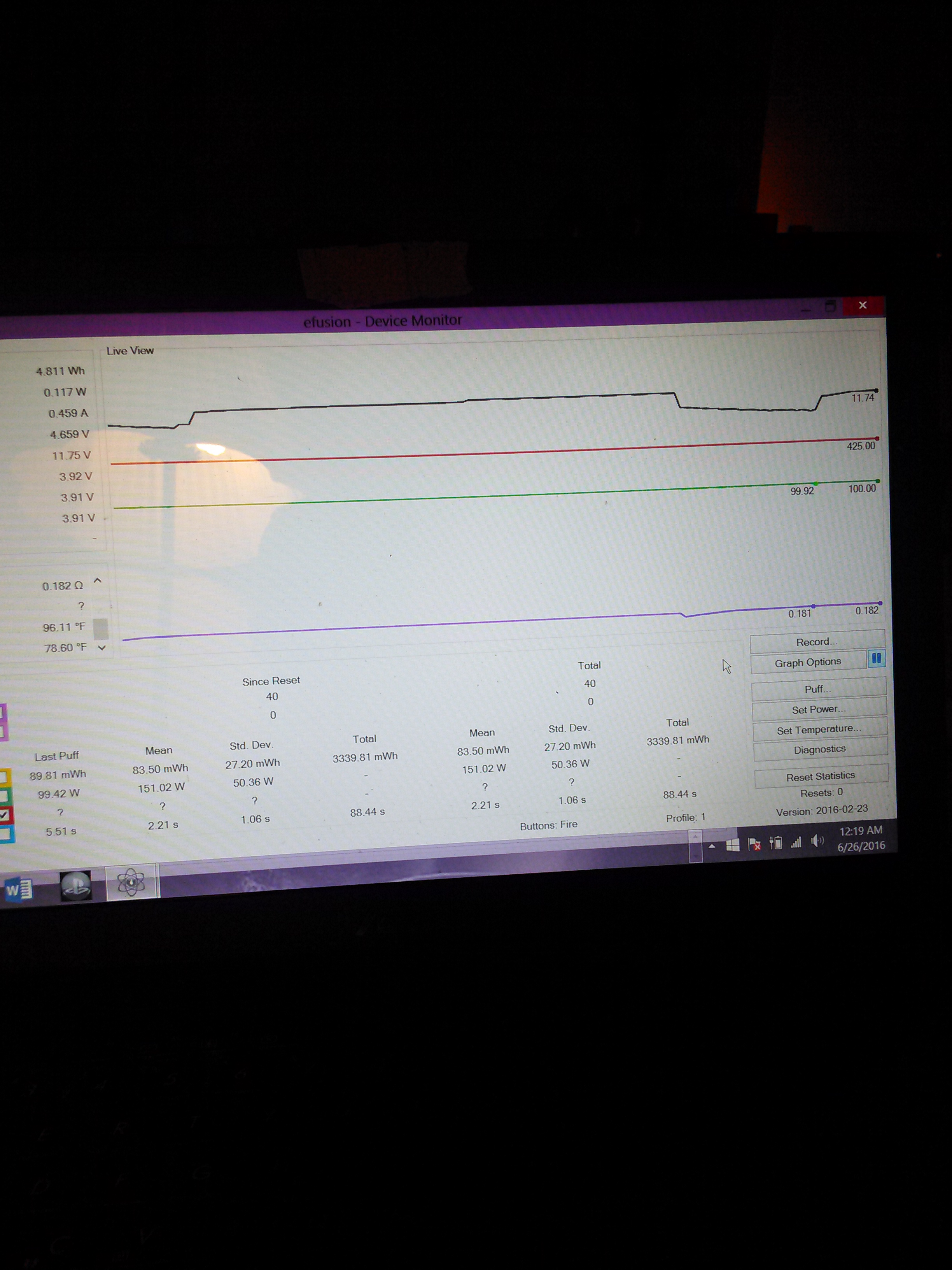

Spector NS5 RD Posted June 26, 2016 Report Posted June 26, 2016 like @retired stated, can you post a screenshot of device monitor while trying to fire the device in tc mode. it can tell us a lot of useful info. have these boxes checked while firing a few times. when using device monitor tell us what type of wire you're using and what csv/tcr as well.
Smokey1336 Posted June 26, 2016 Author Report Posted June 26, 2016 Using 22 gauge ti lighting vapes and titanium CSV from evolve used nickle wire same thing works fine on my vt200
Spector NS5 RD Posted June 26, 2016 Report Posted June 26, 2016 Smokey1336 said:Using 22 gauge ti lighting vapes and titanium CSV from evolve used nickle wire same thing works fine on my vt200 from what can see your live ohms go down slightly from your cold ohms when firing. as you know the resistance has to rise while being fired in order for the dna or any other tc board to do temp control. so you need to narrow down what causing your live ohms to be the same as cold while firing. did TC ever work on this mod? edit....wild guess without having the device in hand, something 510 related. either the 510 wiring, soldering or 510 itself.edit 2..... if you open "atomizer analyzer" in escribe with an atty (same atty you used for the screenshot) on the mod and wiggle it or shake the mod, does the resistance vary greatly (go up and down)?

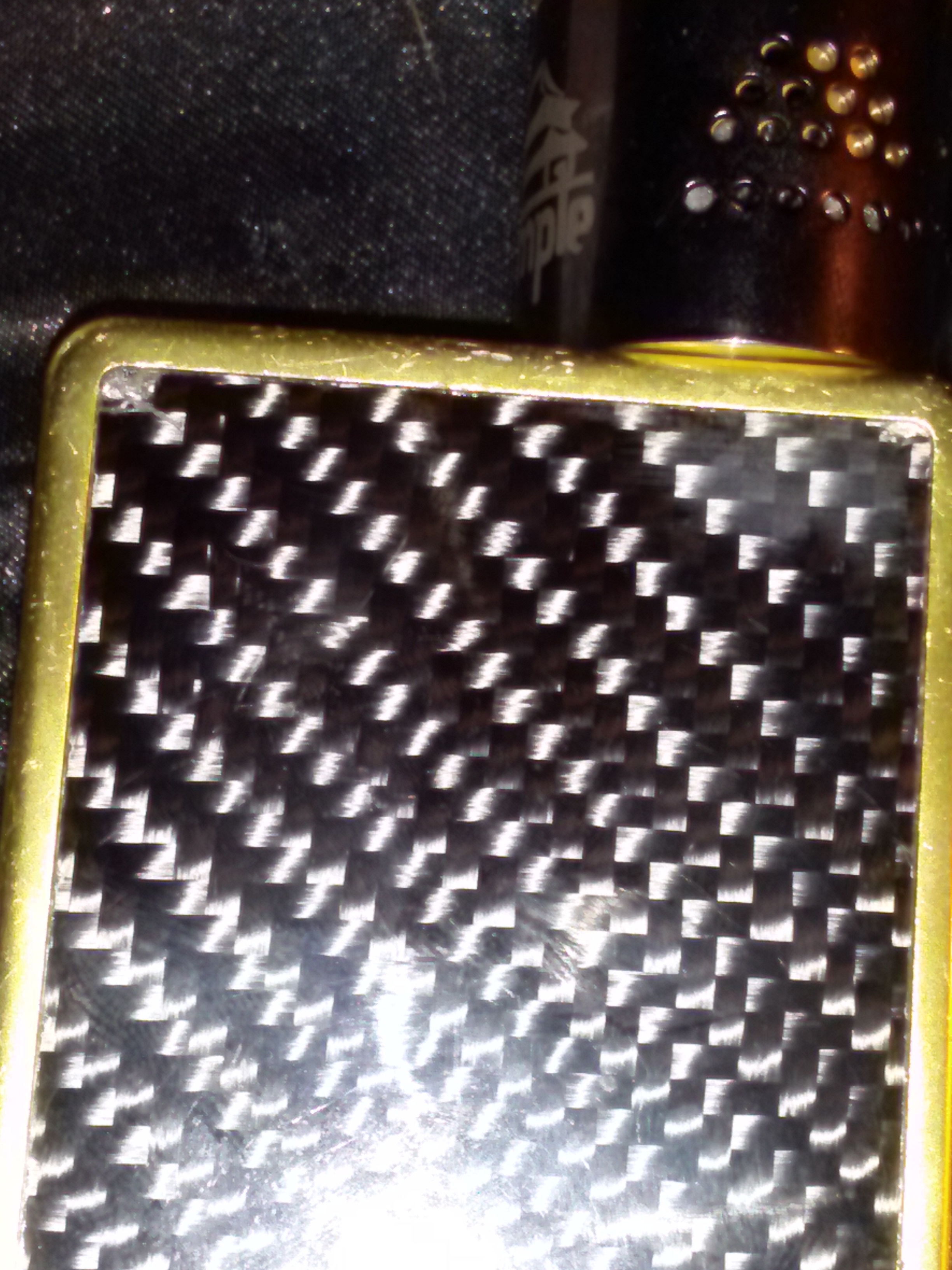

Smokey1336 Posted June 26, 2016 Author Report Posted June 26, 2016 It's fixed you guys were right opened up box messed up carbon panels a little but it was some gunk in the 510 took apart cleaned put back together is working like a charm... as you see side panels chipped corners alittle but who cares my mod is working again woot woot thanks guys

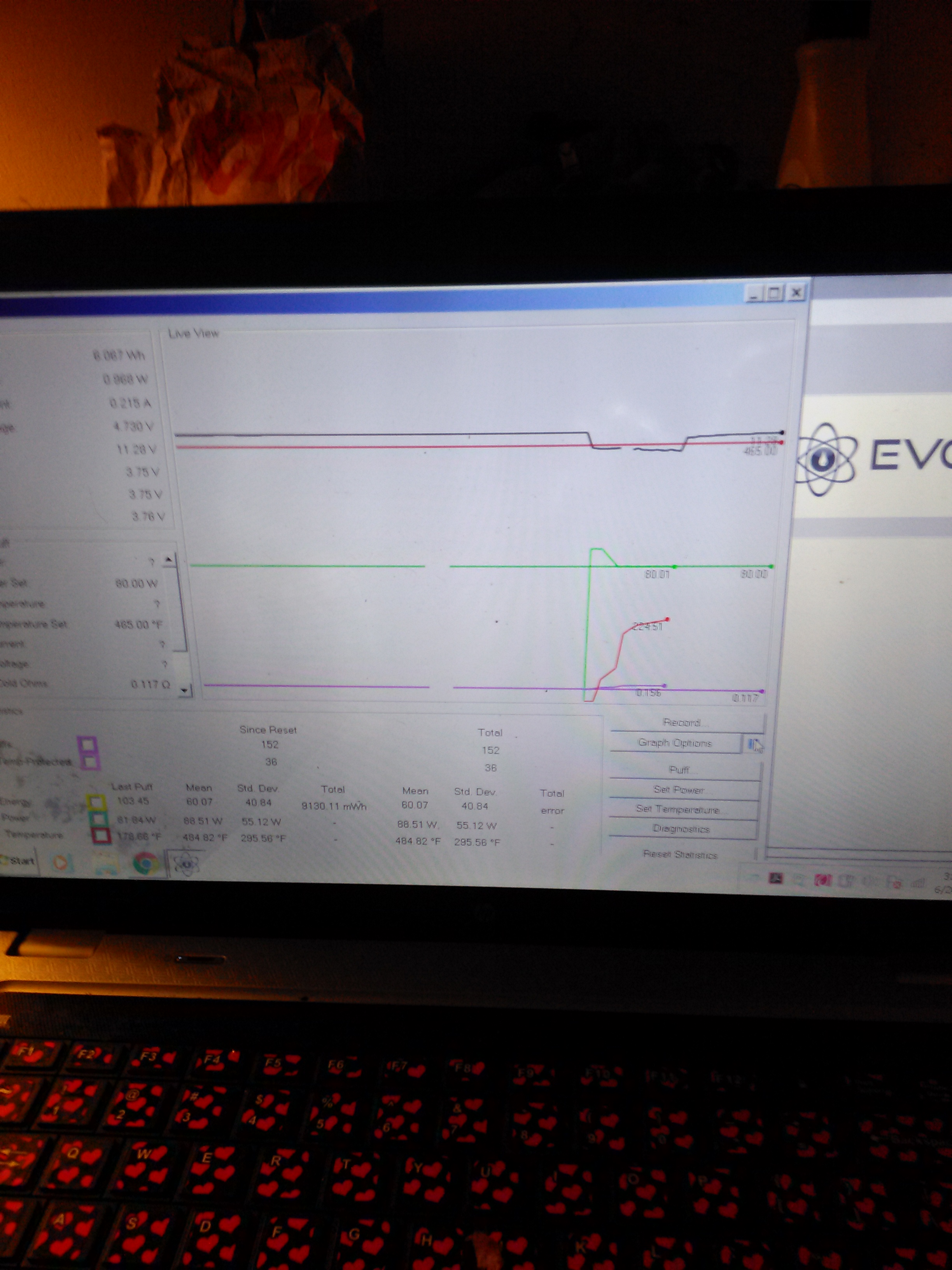

Smokey1336 Posted June 26, 2016 Author Report Posted June 26, 2016 Btw uploaded my vt200 mod settings at .003 mod resistance and same case cooling 287.72 Heating 301.48 USB charge 9.26 10.52 Min ambient -20 Max ambient 110 It's spot on even better then efusion ecig profile Atty ohm reading is perfect everything perfect Battery analyzer ran came out to 14.316 better battery then in my vt200 but still get about 4-5 hours bout half hour longer then my vt200

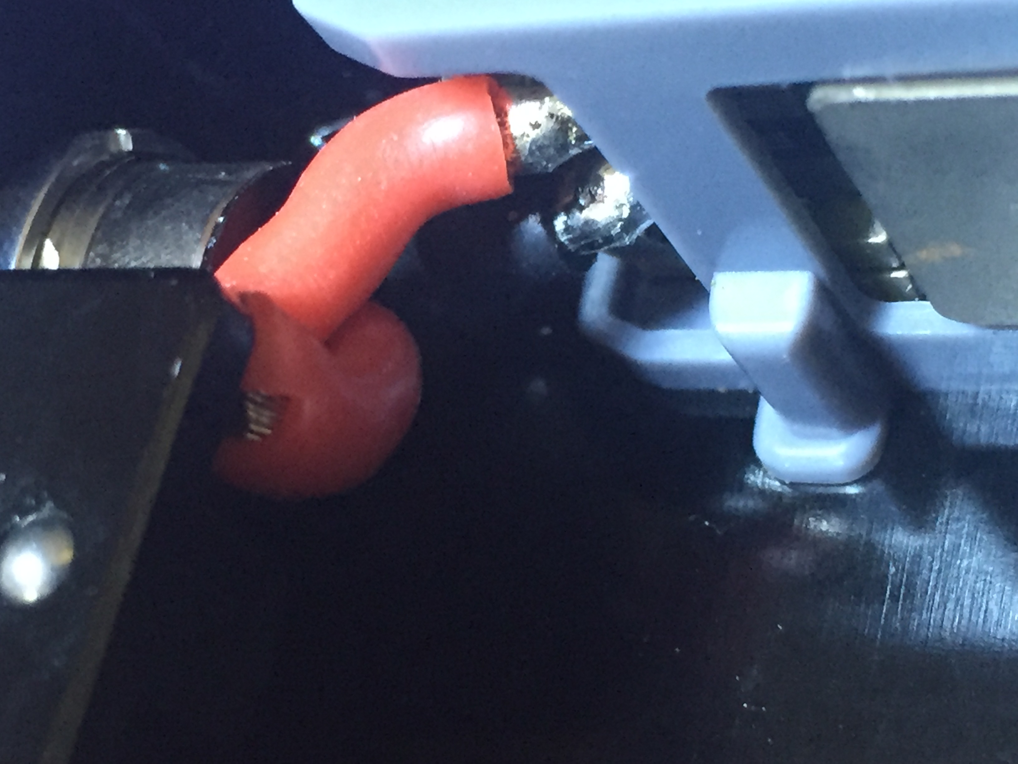

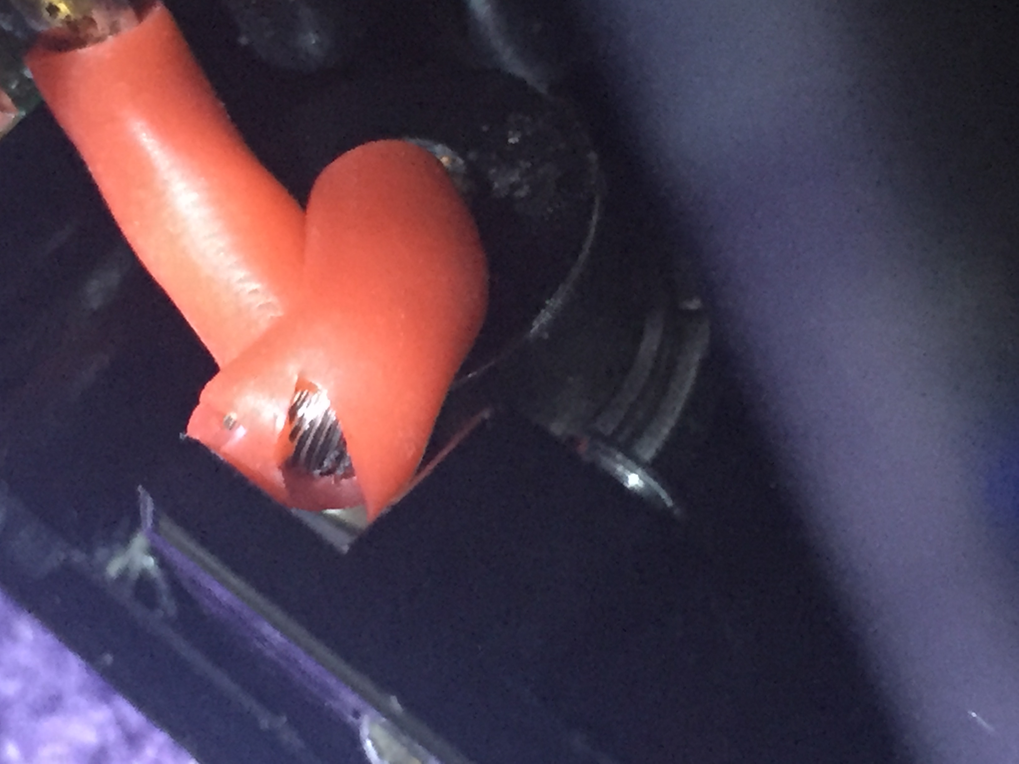

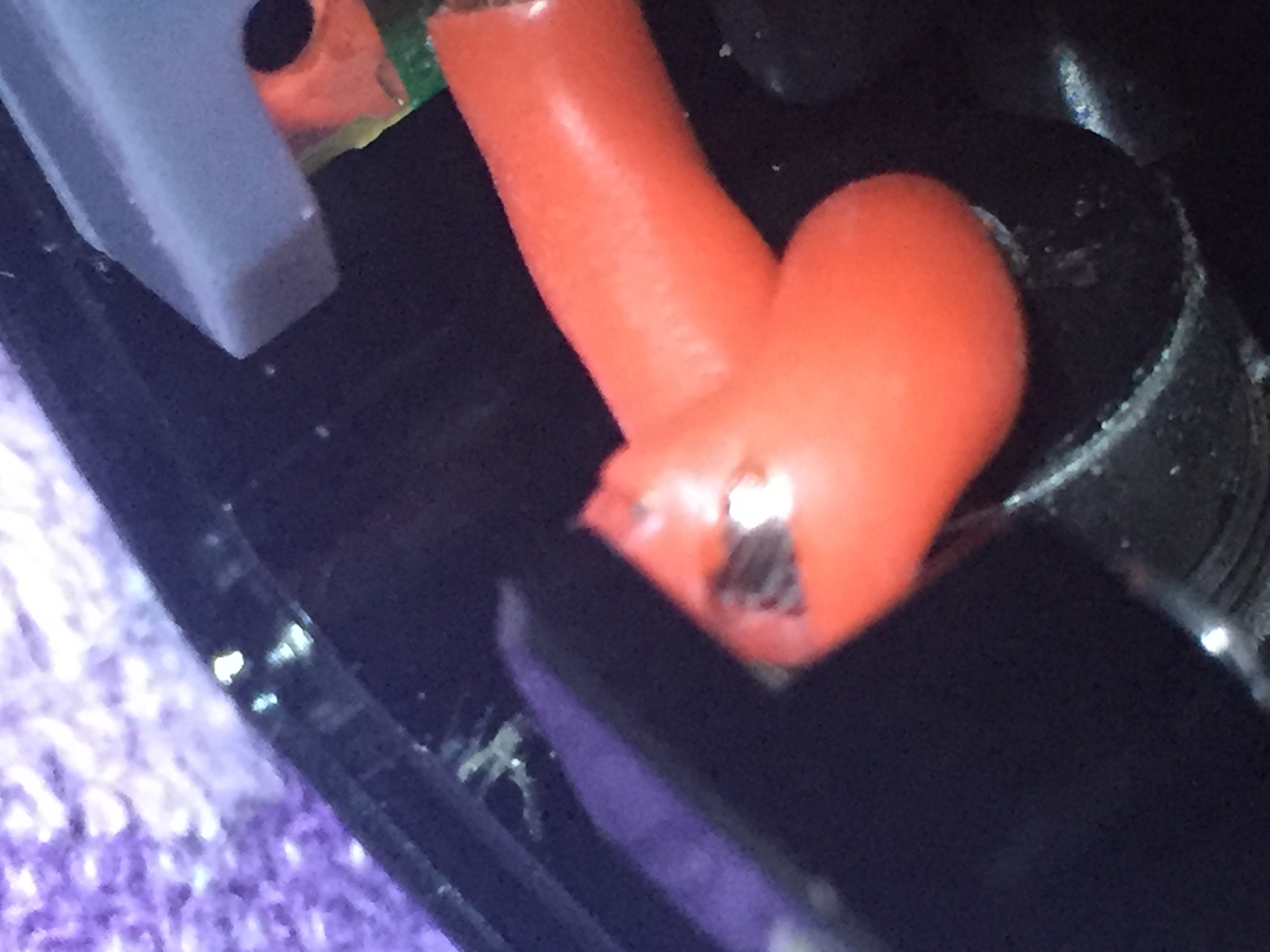

Jentz9517 Posted June 28, 2016 Report Posted June 28, 2016 I looked at the 510 positive and it has a cut in it looks to me what do you guys think? That couldn't be helping my cause. Any feedback appreciated
dwcraig1 Posted June 28, 2016 Report Posted June 28, 2016 Post a screen of it firing coil with the correct material selected. Be sure to tick the cold and live ohms, power, temperature set.You might try using atomizer analyzer checking that the ohms is stable, screw atty in and loosen just slightly, tighten,loosen slightly, jiggle ,tighten.....are you getting near the same ohms or is the readings going wild?
dwcraig1 Posted June 28, 2016 Report Posted June 28, 2016 Jentz9517 said:I looked at the 510 positive and it has a cut in it looks to me what do you guys think? That couldn't be helping my cause. Any feedback appreciatedAs long as the strands of the wire inside aren't cut and it's not shorting (or not about to short) that shouldn't matter. So if just a break in the insulation and isn't going to contact anything is OK, remember it moves slightly.Now is it touching anything, it appears that it may be?
Jentz9517 Posted June 28, 2016 Report Posted June 28, 2016 dwcraig1 said:As long as the strands of the wire inside aren't cut and it's not shorting (or not about to short) that shouldn't matter. So if just a break in the insulation and isn't going to contact anything is OK, remember it moves slightly.Now is it touching anything, it appears that it may be? ya I believe so which explains high ohms it is in contact with the tab
dwcraig1 Posted June 28, 2016 Report Posted June 28, 2016 Touching ground would cause lower ohms not higher.I doubt if the wire inside is broken but it's possible. Perhaps the "twist" of the wire is keeping the 510 from moving easily.Are you able to grab the 510 pin/wire and untwist and have it loop on the other side. It looks like maybe an atties 510 screw dug into your 510 socket's 510 and twisted it that way. Can it be untwisted?
Jentz9517 Posted June 28, 2016 Report Posted June 28, 2016 I can try it but as of now I'm returning it. It's pretty shabby. I do appreciate the feedback though
