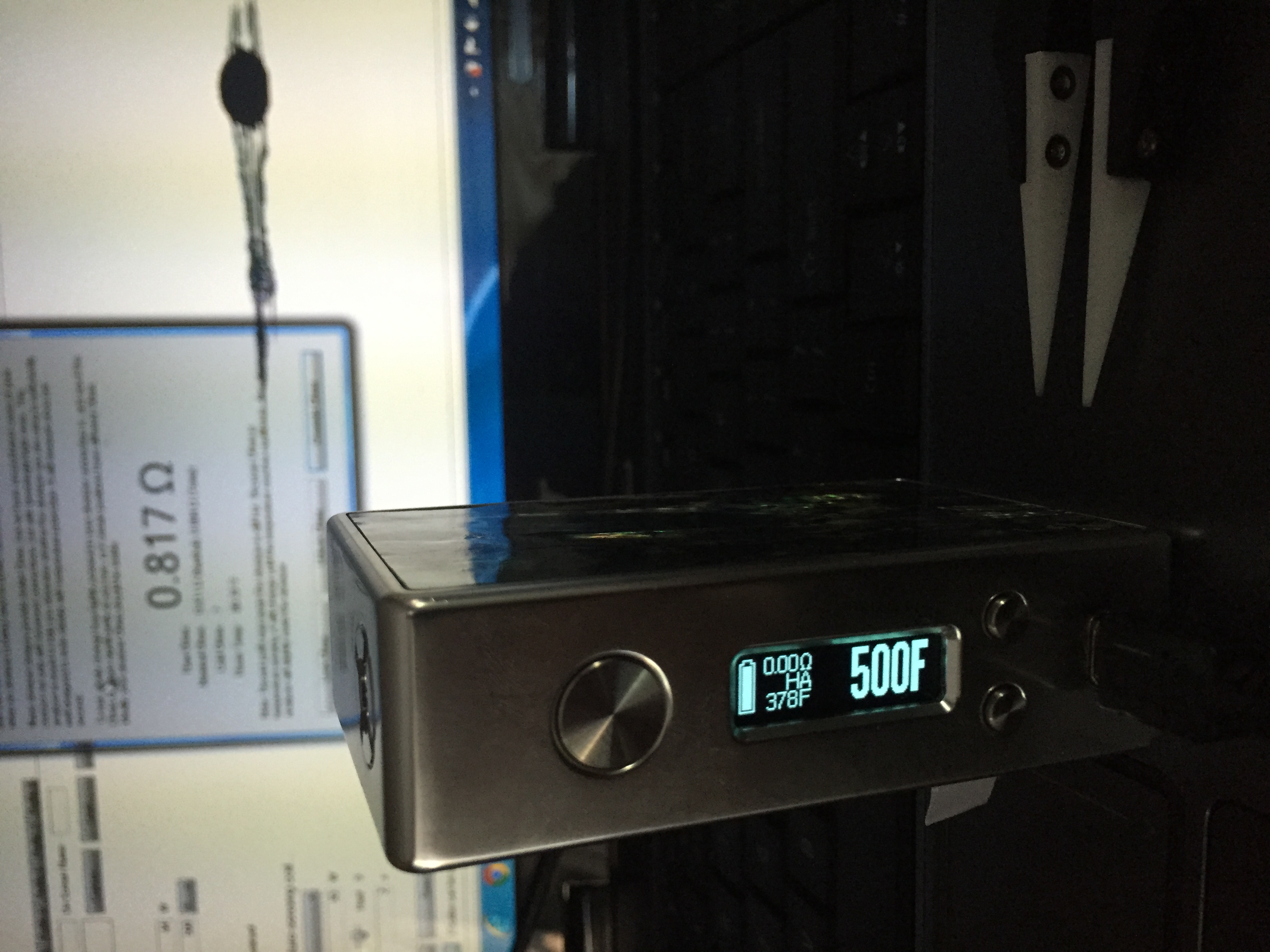

Jentz9517 Posted July 4, 2016 Author Report Posted July 4, 2016 See pic below : I have an issue with "ohms too high prompt" and towards end of vape temp protection now on most pulls. I don't seem to have a very strong 510 spring ? Usually lost vape is notorious for stiff springs. my question where can I get one to fix this because as of now in atomizer analyzer it reads resistance without anything attached or could it be something else? Thanks Edit: my other device does the same thing so maybe it keeps last reading?
VapingBad Posted July 4, 2016 Report Posted July 4, 2016 It is normal for AA to show a resistance when there is none.
Jentz9517 Posted July 4, 2016 Author Report Posted July 4, 2016 Ya my new one did this also. I should have checked before post.
Jentz9517 Posted July 4, 2016 Author Report Posted July 4, 2016 VapingBad said:It is normal for AA to show a resistance when there is none. do you know where I could get a replacement spring instead of sending device to lost vape?
retird Posted July 4, 2016 Report Posted July 4, 2016 Your picture shows 0.817 ohm's without atty ... is that the normal reading of your atty when attached?
Jentz9517 Posted July 4, 2016 Author Report Posted July 4, 2016 retird said:Your picture shows 0.817 ohm's without atty ... is that the normal reading of your atty when attached? It fluctuates between 0.765-0.774 good call I never thought of that. My other device runs this clone very well, maybe because it has a stiff spring. I just screwed on my authentic and it reads within 1 rarely 2
Jentz9517 Posted July 4, 2016 Author Report Posted July 4, 2016 Thanks for jarring my memory. I have been away from escribe awhile and forgot the tell tale signs of a wonky 510 pin. The smy75 runs it well since it's nice and stiff but I need a better spring on the lostvape.
VapingBad Posted July 4, 2016 Report Posted July 4, 2016 Jentz9517 said: do you know where I could get a replacement spring instead of sending device to lost vape?I don't know, I hear they use wave springs so you may have to pull the 510 apart and google for a matching spring. You could try asking LostVape or asking VapeGeek.co.uk if they could order one.
Jentz9517 Posted July 4, 2016 Author Report Posted July 4, 2016 VapingBad said:I don't know, I hear they use wave springs so you may have to pull the 510 apart and google for a matching spring. You could try asking LostVape or asking VapeGeek.co.uk if they could order one. Yes I'm certain it's what it needs since it goes of without a hitch on the other. It had been fired 1730 times before I bought from the kid and he ran mostly competition drippers on it so It's seen better days! Thanks a lot again Retird and VB
