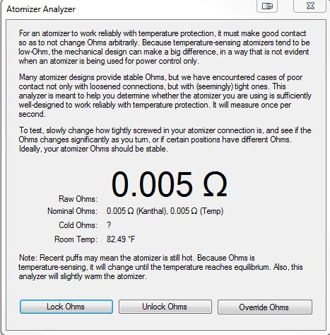

VapingBad Posted March 11, 2016 Report Posted March 11, 2016 You should find when testing that the Raw and both Nominal values are the same and that nothing at all shown in cold ohms in Atomiser Analyser. Take the test piece out, check the Mod Resistance is set to zero and that setting has been uploaded to the device, press fire while the 510 is empty then put the test piece in and only then view in Atomiser Analyser.
timbomfg Posted March 11, 2016 Author Report Posted March 11, 2016 Right, done that again, set mod resistance to 0, upload back to device, back into atomizer analyzer, and once i crank it down, its wavering between 0.004 and 0.005 tho the blank is night and tight.Split the difference and call it 0.0045?
VapingBad Posted March 11, 2016 Report Posted March 11, 2016 I would use the lower value 0.004 as if to high it can affect the temp sensing stability.
Jentz9517 Posted March 13, 2016 Report Posted March 13, 2016 VapingBad said:I would use the lower value 0.004 as if to high it can affect the temp sensing stability. So a few months back I had heard from one of the employees to go with 85-90% of the actual value should I use 0.0036?
VapingBad Posted March 13, 2016 Report Posted March 13, 2016 Jentz9517 said: So a few months back I had heard from one of the employees to go with 85-90% of the actual value should I use 0.0036? Yes, that is good advice and what I do for mods reading a stable 0.004, I'm assuming the one here alternating between 0.004 & 0.005 is about 0.0045.

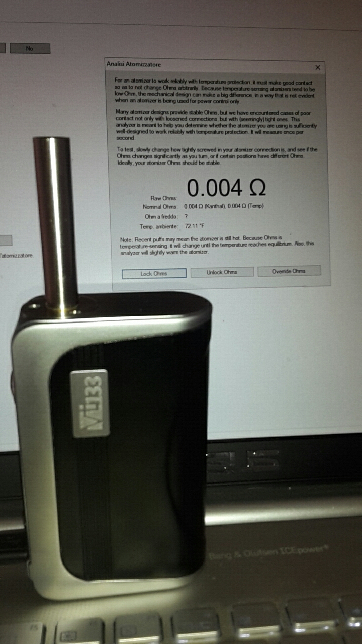

igipit Posted May 2, 2016 Report Posted May 2, 2016 could someone tell me what am I missing?Using the copper calibration tool does not reproduce actual vaping conditions. An atomizer 510 connector is not a full copper contact, it has a copper (or brass) central pin and an SS screw. Furthermore the static resistance of an atomizer is not determined by the 510 contact only but by the entire chain of contacts from the 510 to the resistance wire contacts.If I measure one coil resistance with a precision milli-ohmmeter i get 329 mOhm, but if I place that coil into the KFL deck and screw it into my Vt233, it reads 355 mOhm: 26 mOhm difference! But if I screw in a soldered cartomizer, than I get 4-5 mOhm, likely the same value I would get with the copper calibration tool.

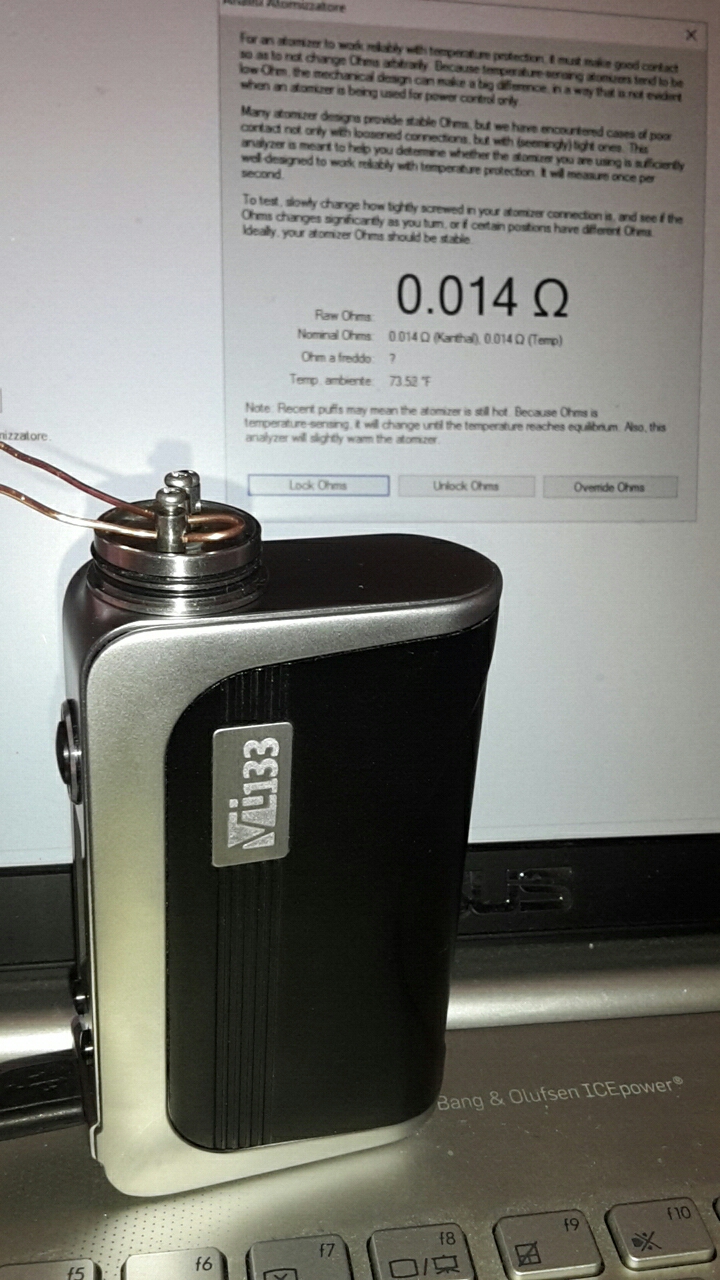

igipit Posted May 2, 2016 Report Posted May 2, 2016 Look at the two pictures. In the first one I measure the resistance of the soldered cartomizer and i get 4 mOhms. In the second picture i measure the resistance of a UD RDA deck with the two pins short circuited by a 1 mm thick copper wire and get 14 mOhm. Note that both the RDA deck pins and the RDA 510 connector were carefully cleaned before I placed it on the VT133. I think that the entire contact chain resistance should be accounted for as the device resistance and not merely that of the 510 cnnector.
BillW50 Posted May 2, 2016 Report Posted May 2, 2016 igipit said:If I measure one coil resistance with a precision milli-ohmmeter i get 329 mOhm, but if I place that coil into the KFL deck and screw it into my Vt233, it reads 355 mOhm: 26 mOhm difference! But if I screw in a soldered cartomizer, than I get 4-5 mOhm, likely the same value I would get with the copper calibration tool.I noticed for your first post, you didn't bother asking the easy questions first. igipit said:I think that the entire contact chain resistance should be accounted for as the device resistance and not merely that of the 510 cnnector.Why would you think this? All quality ohm meters always nulls out its own internal resistance. And how would TC work if it didn't know what was the TC resistance vs. the static resistance? What am I missing here?
igipit Posted May 2, 2016 Report Posted May 2, 2016 May be you misunderstood me, it is exactly what i'm saying : the whole static resistance must be known to precisely estimate the temperature variation.I have argued on the fact that the 510 connector resistance (that measured by means of the copper tool) is only a fraction of the whole static resistance. Which is the utility to know only the 510 resistance?
