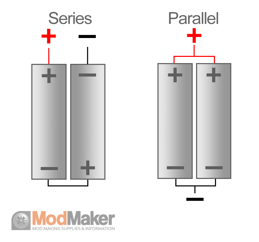

MaineVapes Posted August 6, 2016 Author Report Share Posted August 6, 2016 I have two dna75 mods. One is the vt75 the other is sdna75. I always use lg he2 or he4 in all my mods but in both the dna75 mods at 50% battery life is get weak battery and the chip cuts my power. So there's no way to keep a consistent vape. So I have a plan. I have a enclosure I was going to use to turn my DX200 into a 133. By pulling the board out but now I want to instead pull out one of the boards from my dna75s and due a parallel build. Just not quite sure of how to wire it in parallel. Also what about battery monitoring. Hopefully someone can help me out with a wire diagram. I've searched the net to no luck at all. I've built unrelated parallel mods before. I just don't want to assume I'm wiring the board wright and make an ass out of myself by frying it. Thanks Link to comment Share on other sites More sharing options...

MaineVapes Posted August 6, 2016 Author Report Share Posted August 6, 2016 So just a normal parallel wiring just to the positive and negative of the board straight forward then Link to comment Share on other sites More sharing options...

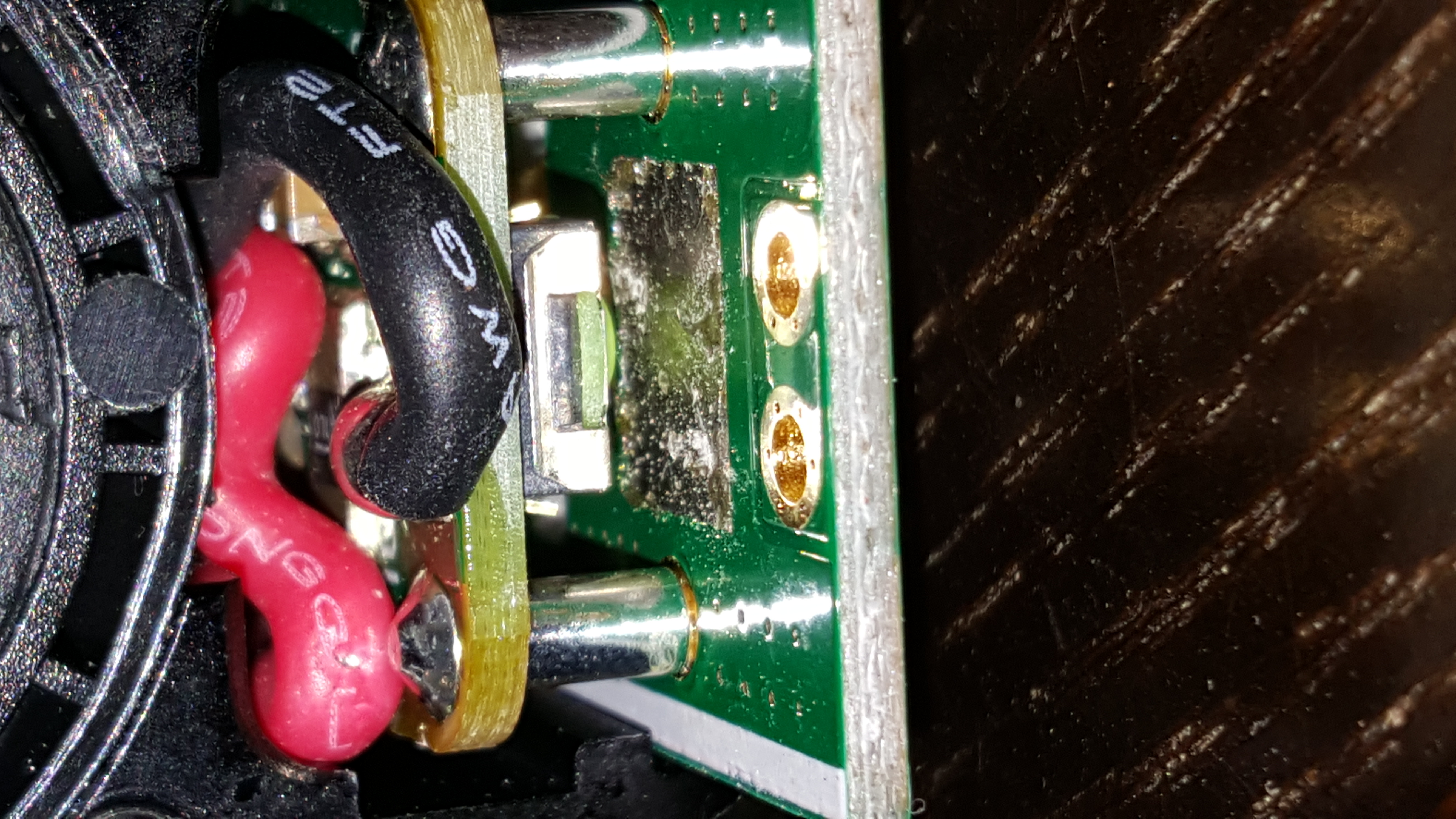

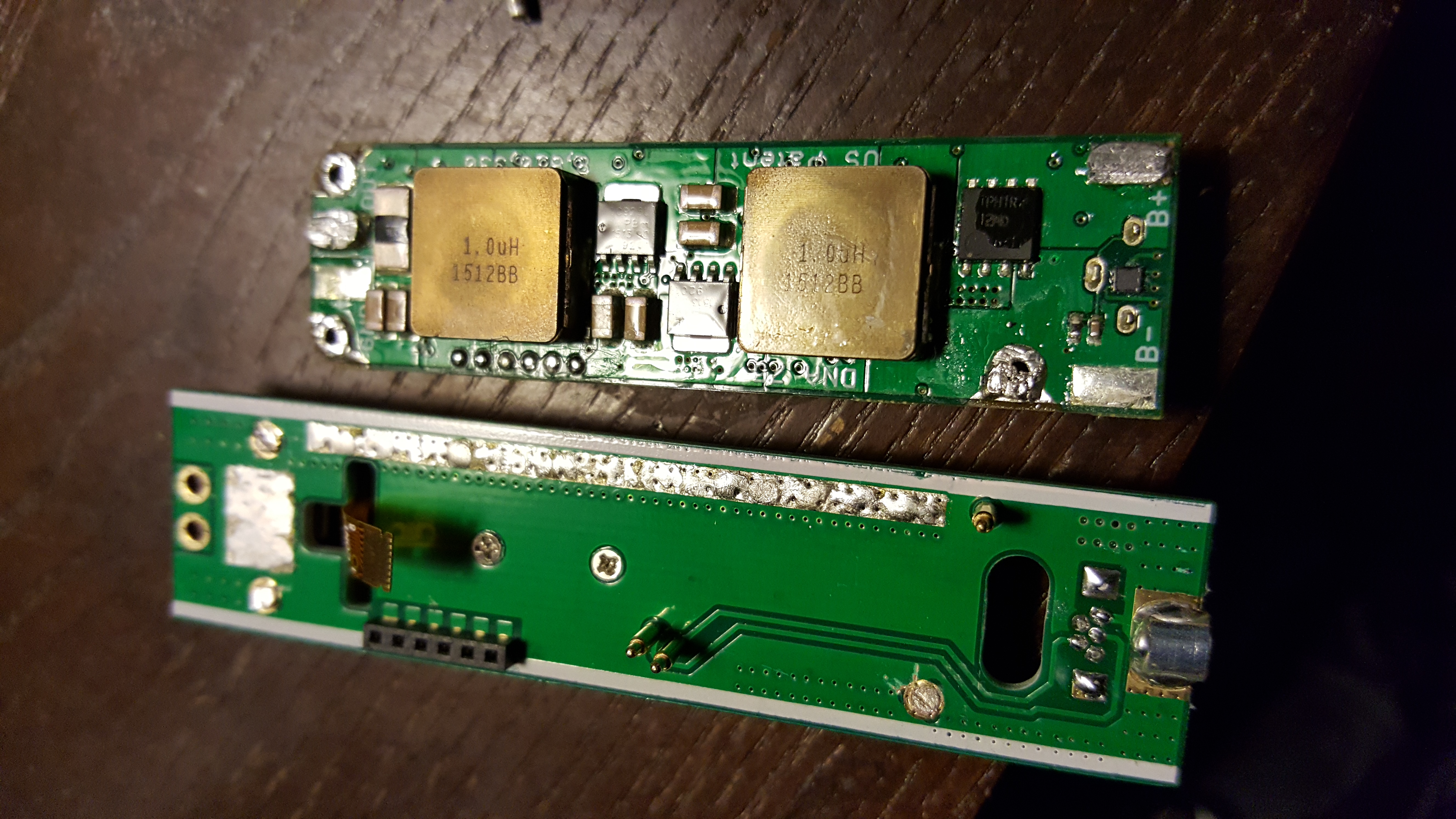

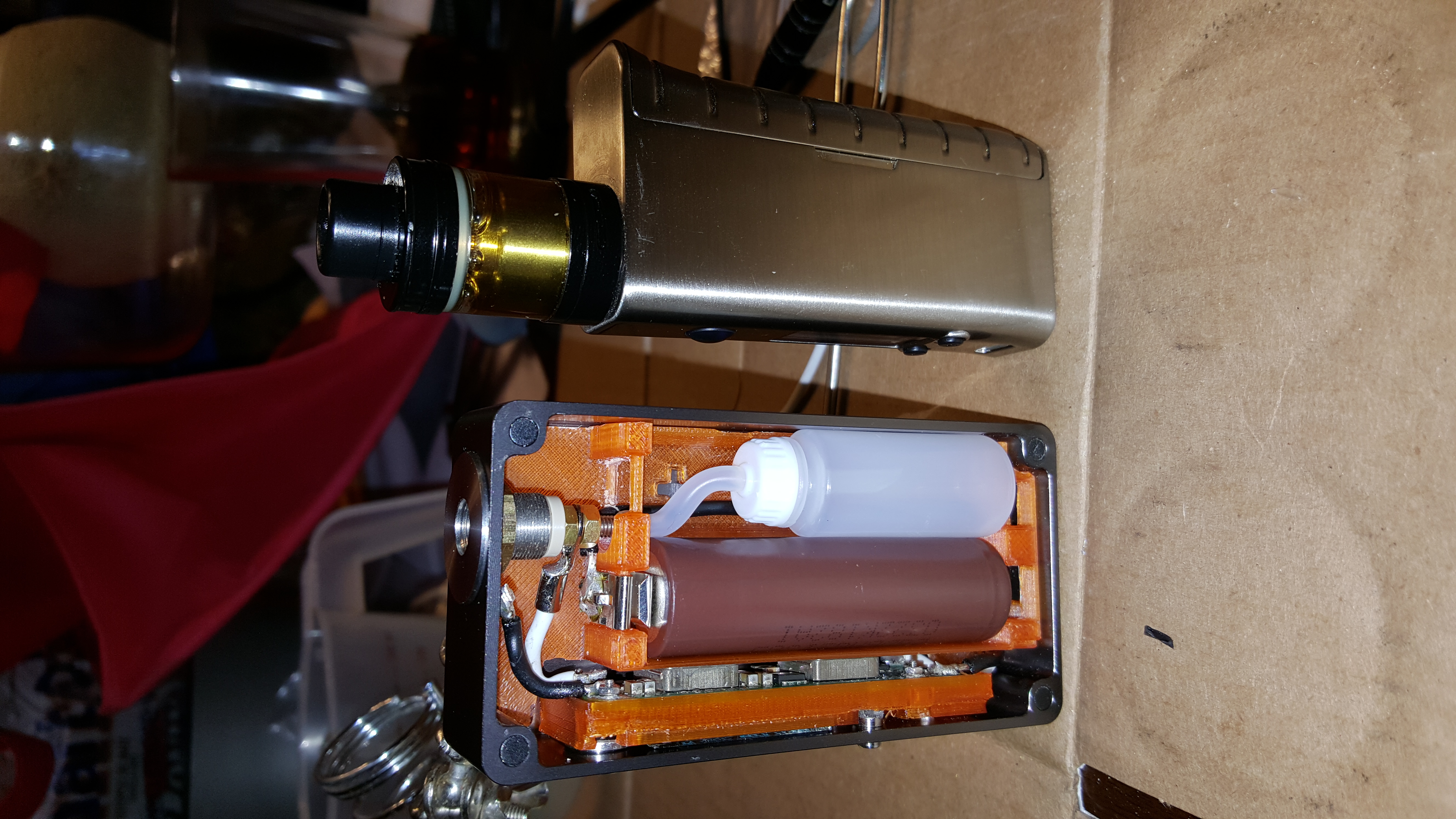

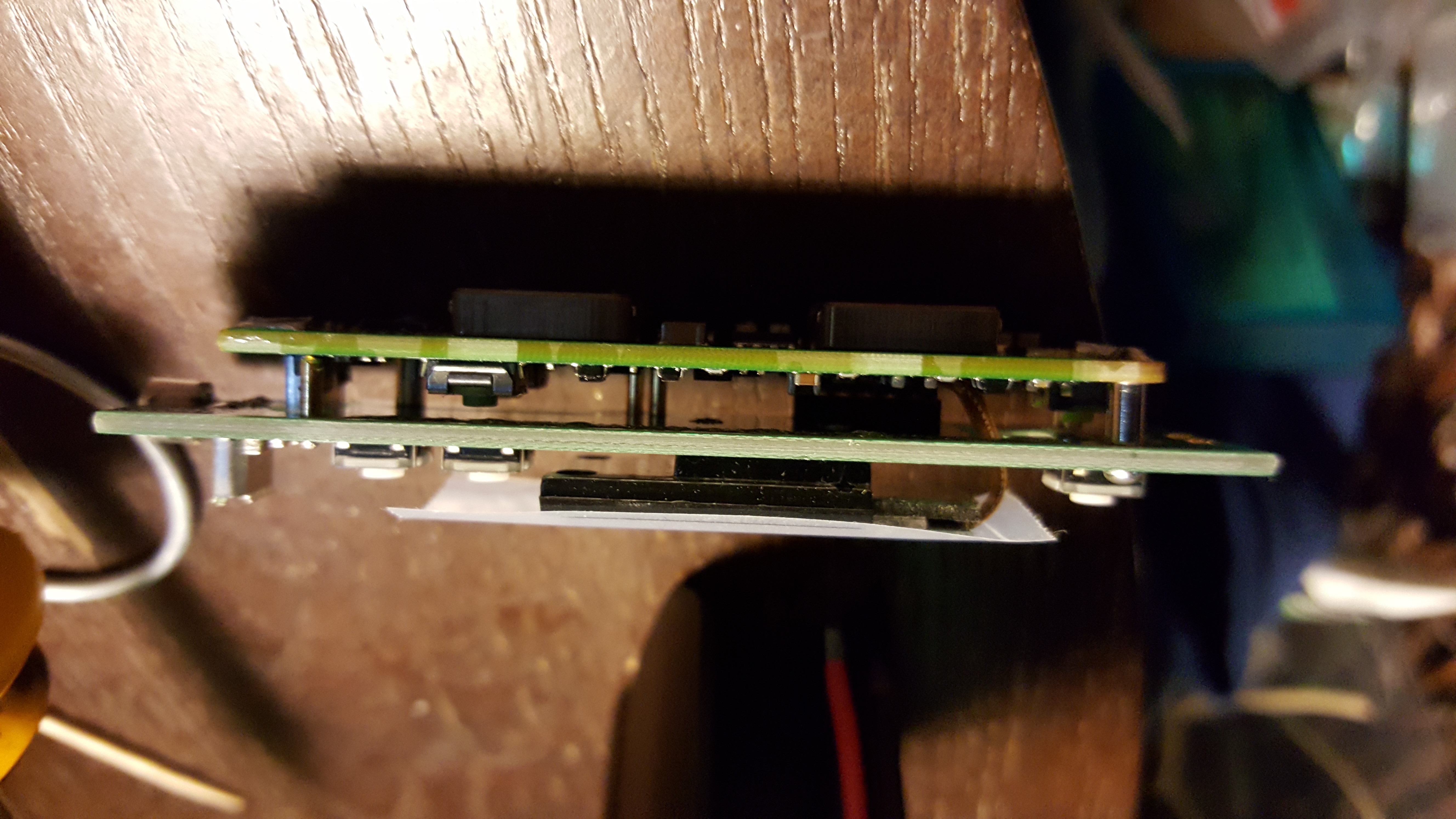

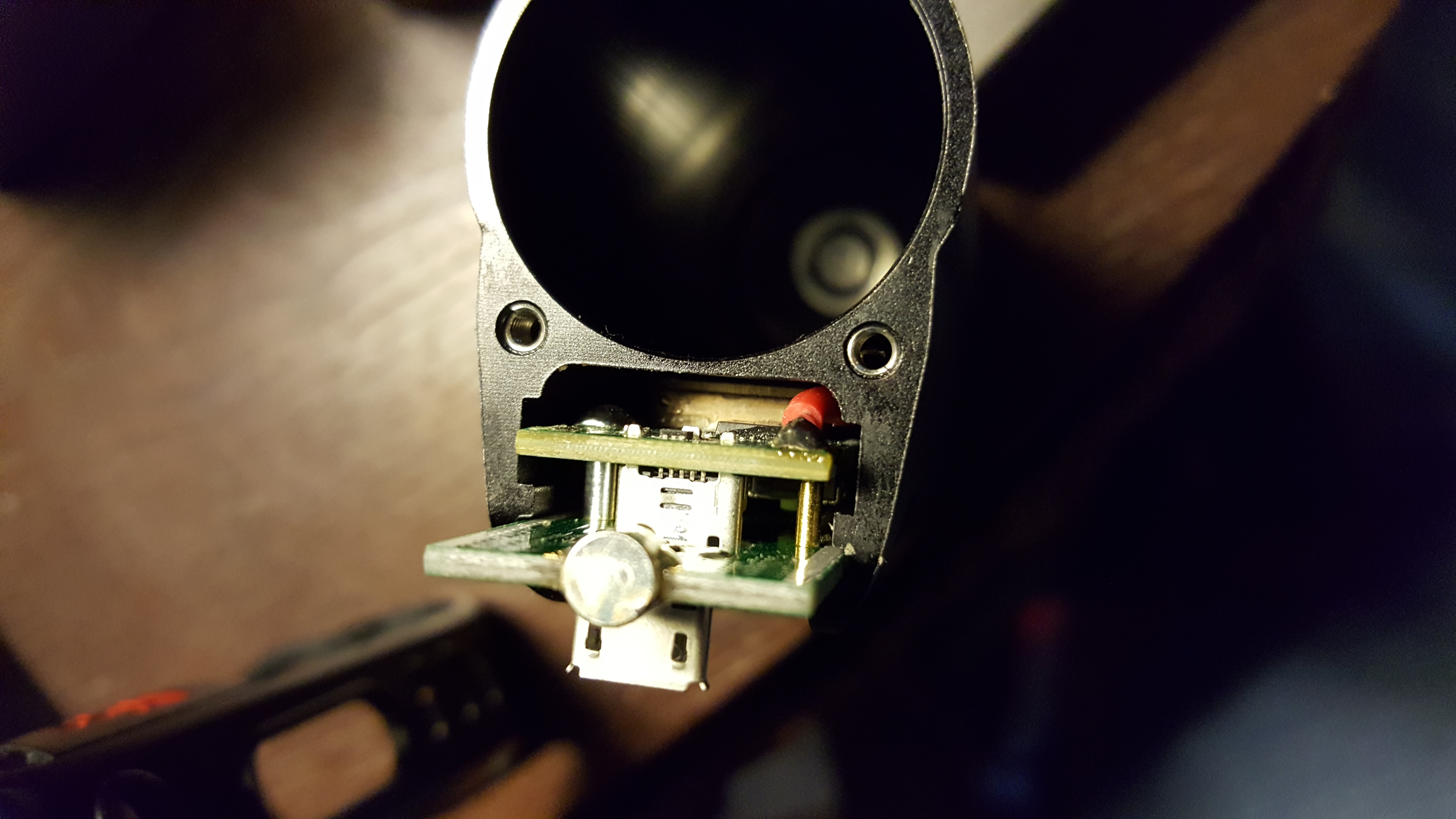

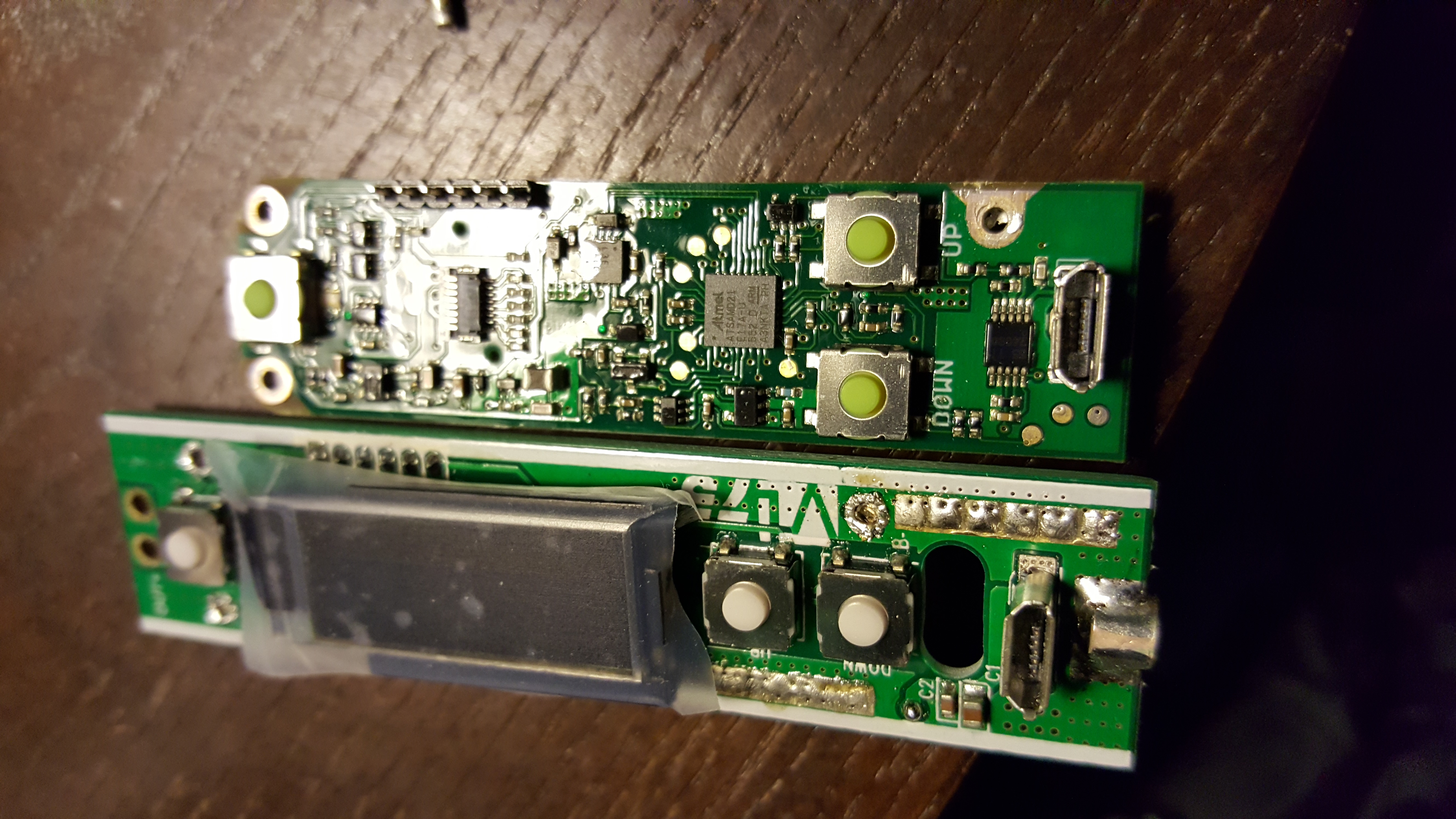

MaineVapes Posted August 11, 2016 Author Report Share Posted August 11, 2016 I've had the same battery issues with both my dna 75 devices, with my vt75 I've pulled the board. Only paid $50 for it so trying to fit it to a cnc g+ enclosure dual parallel but it's tight. So if I can't get that to work I'll make it into a squonk box. Here's some pics of how hcigar installed the board. They installed there own board on top of the dna75 Link to comment Share on other sites More sharing options...

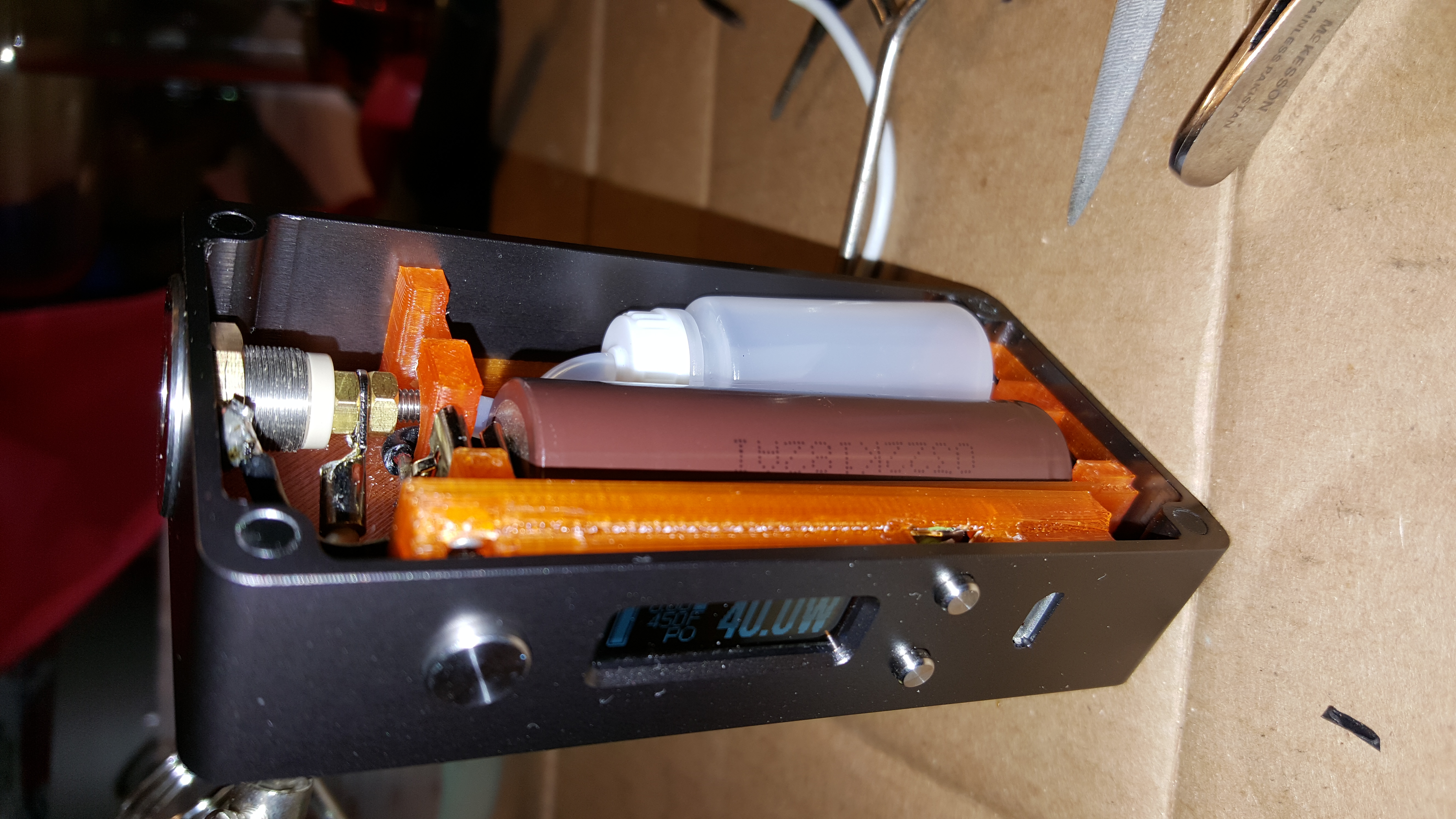

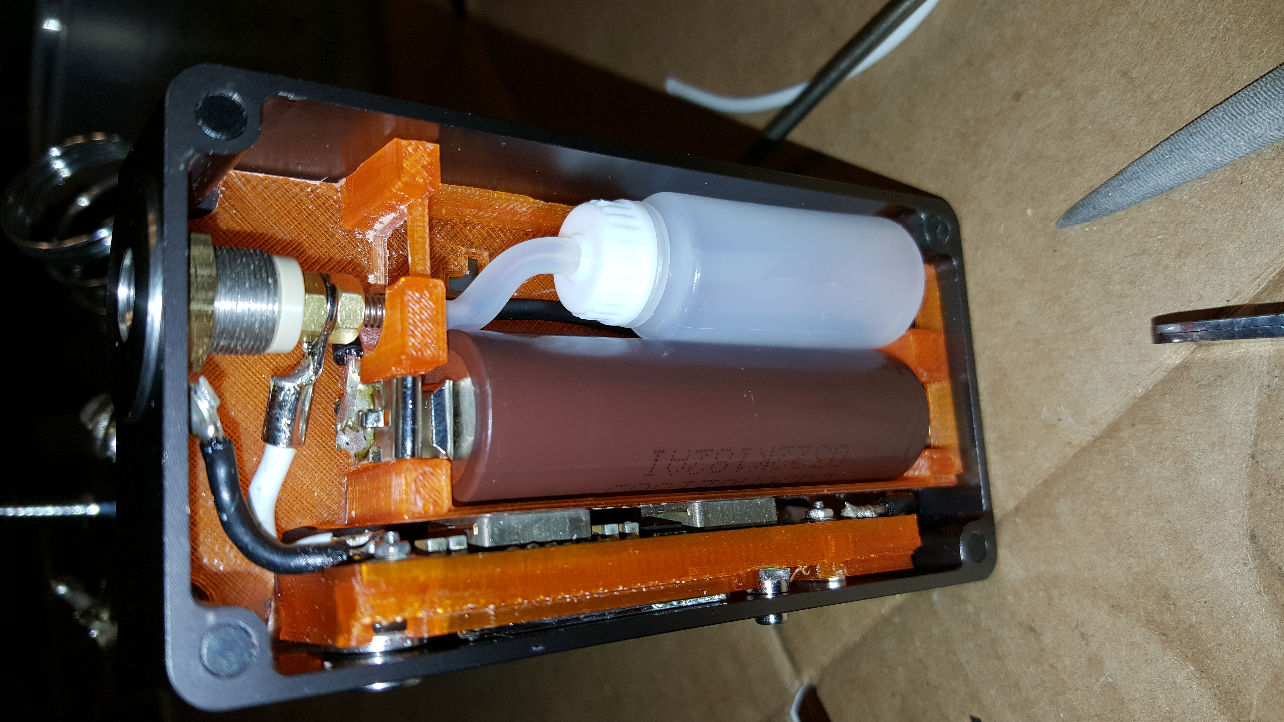

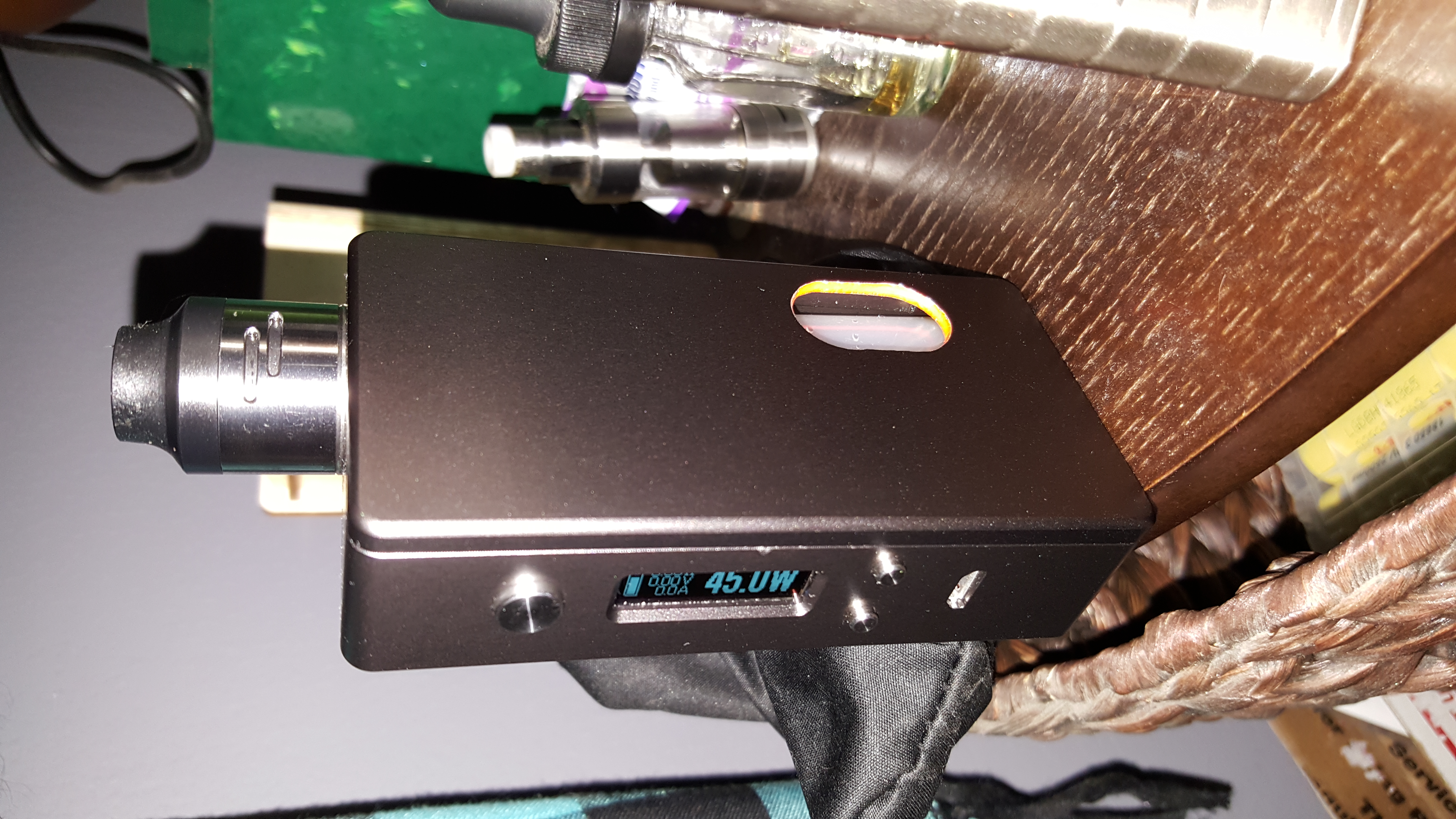

MaineVapes Posted August 14, 2016 Author Report Share Posted August 14, 2016 Still needs a little more work but almost done. This is my dna75 1590G+ squonk box. My board came out of the hcigar vt75 Link to comment Share on other sites More sharing options...
MaineVapes Posted August 14, 2016 Author Report Share Posted August 14, 2016 Dna75 1590G+ squonk box Link to comment Share on other sites More sharing options...

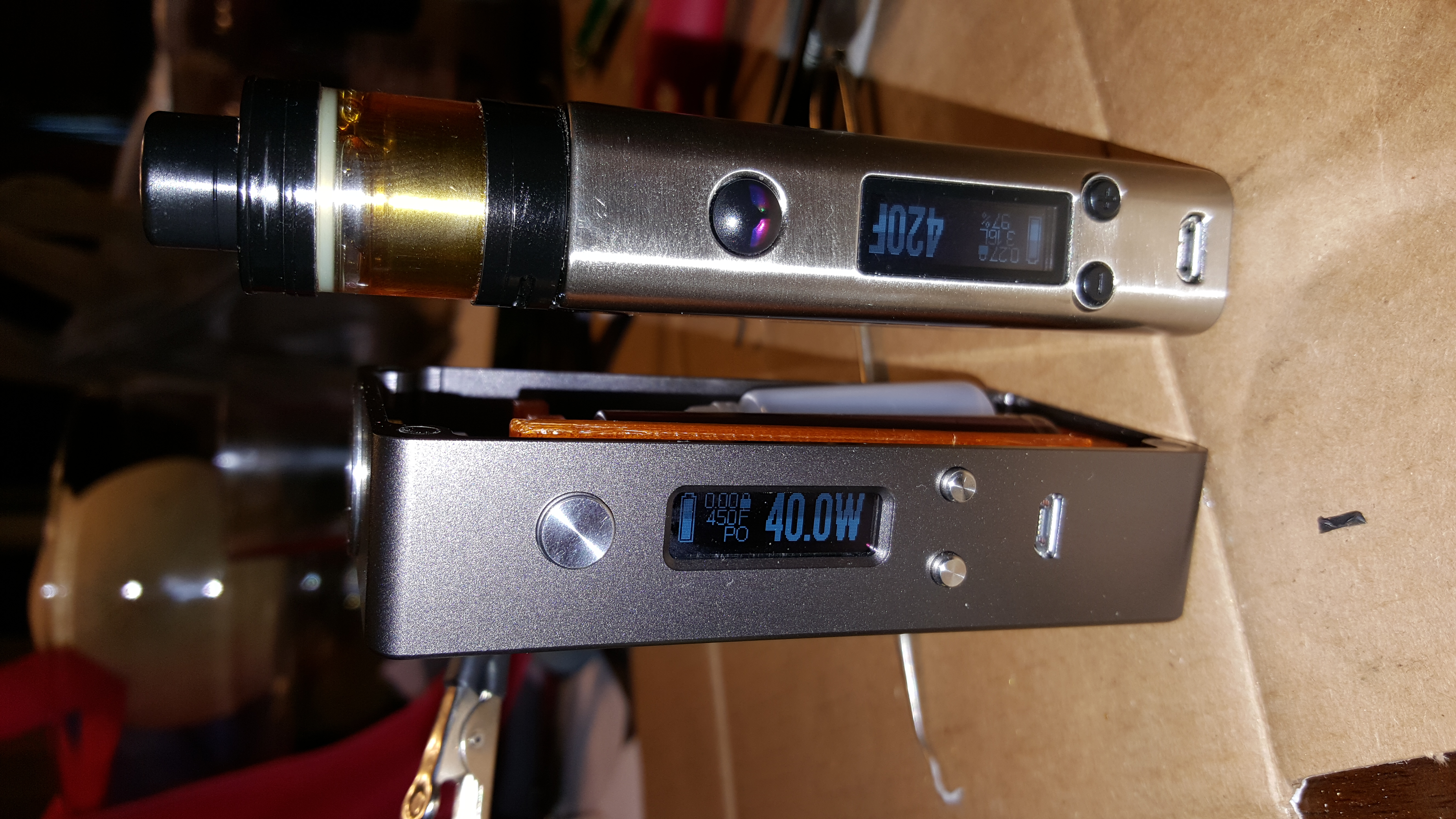

MaineVapes Posted August 19, 2016 Author Report Share Posted August 19, 2016 After using the dna75 board out of the hcigar vt75 in my squonk mod, have a big change in my opinion of the board. With no changes in escrib it's preforming like my dns200. No weak battery on any build I put on it. I'm now loving it. Most days I don't vape over 50watts and love 18650 batteries now this is the board for me. Link to comment Share on other sites More sharing options...
