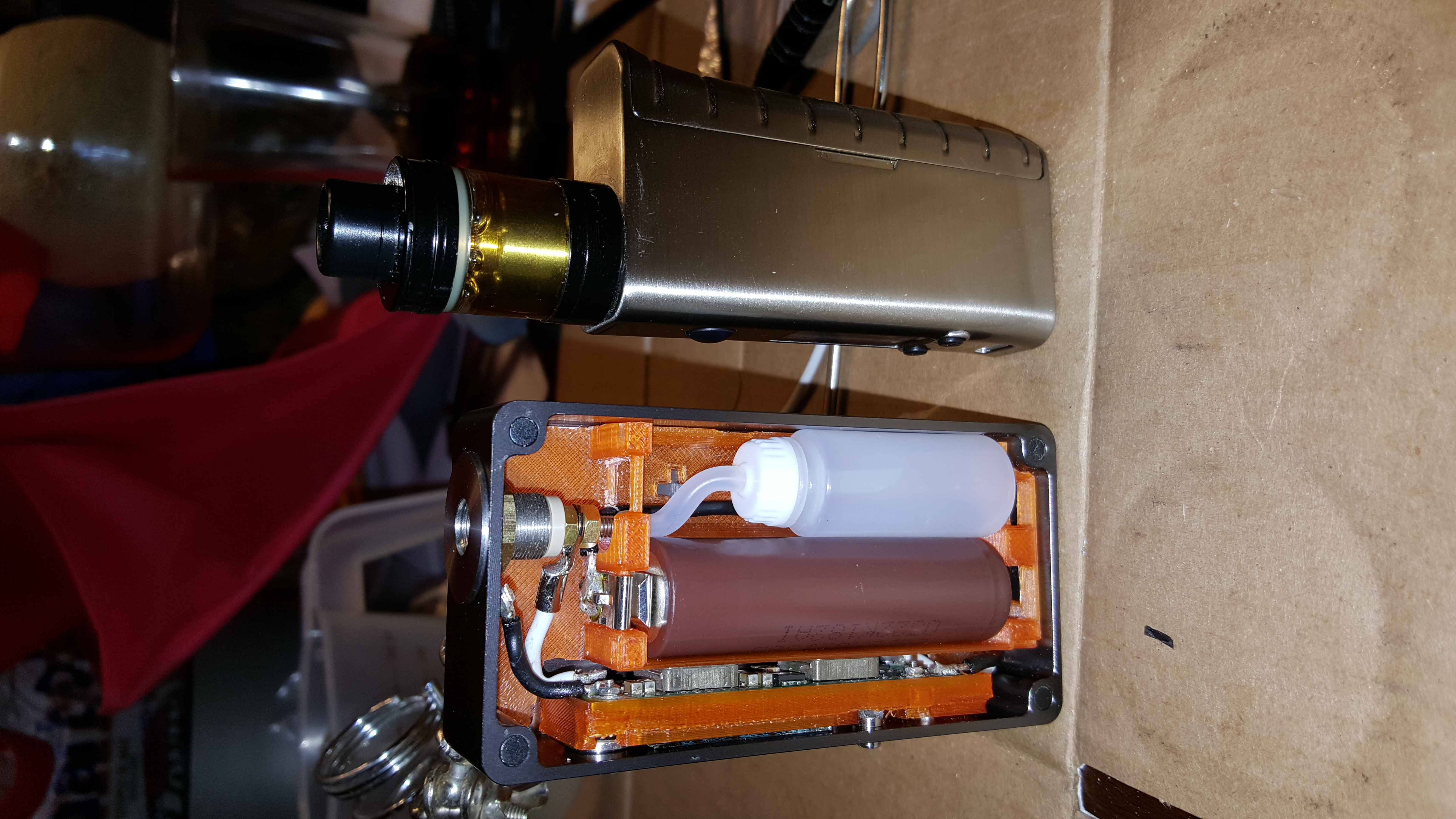

After using the dna75 board out of the hcigar vt75 in my squonk mod, have a big change in my opinion of the board. With no changes in escrib it's preforming like my dns200. No weak battery on any build I put on it. I'm now loving it. Most days I don't vape over 50watts and love 18650 batteries now this is the board for me.
Still needs a little more work but almost done. This is my dna75 1590G+ squonk box. My board came out of the hcigar vt75
I've had the same battery issues with both my dna 75 devices, with my vt75 I've pulled the board. Only paid $50 for it so trying to fit it to a cnc g+ enclosure dual parallel but it's tight. So if I can't get that to work I'll make it into a squonk box. Here's some pics of how hcigar installed the board. They installed there own board on top of the dna75
