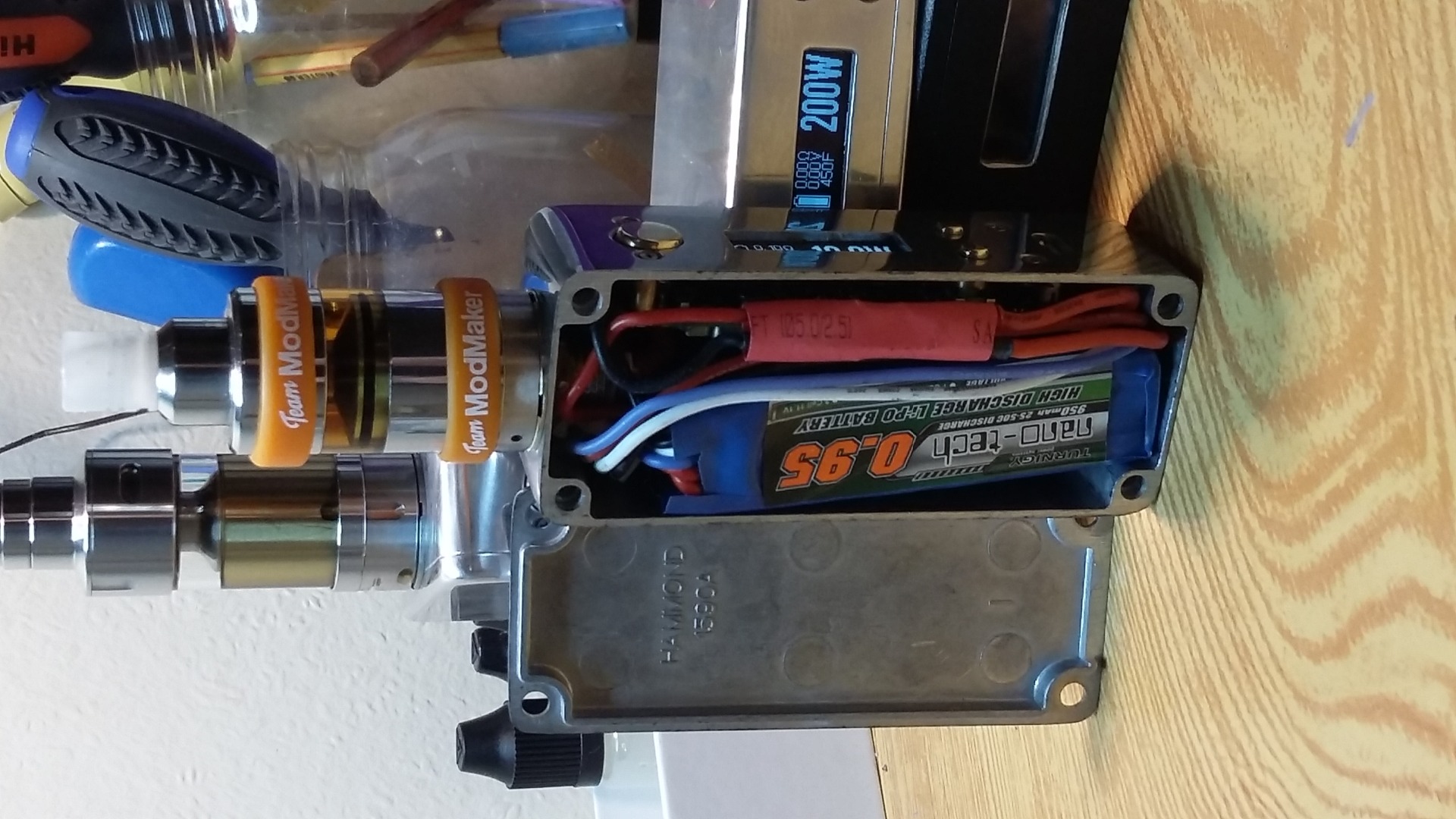

black lace Posted August 9, 2016 Report Posted August 9, 2016 I like my hammond 1590a boxes with an equivalent 900mah lipol in, but theyr not everyones cup of tea because they are not true square, the sides are slightly slanted, but i love that because of the way they sit comphy in my hand and back pocket, modmaker sell em or you can copy the dimensions and they do simular boxes to thoes measurments, i use modmaker & stealthvape theyre both very good, im planning on doing a dna75 with the fatboy box ect like i said above, i havnt checked the sizing for a dna200 in it and am on mobile at the moment, but im prety sure theres plenty of room and theyr also some 1000 mah tripple graphine powere paks coming in now.. people are changing over from the lipol..

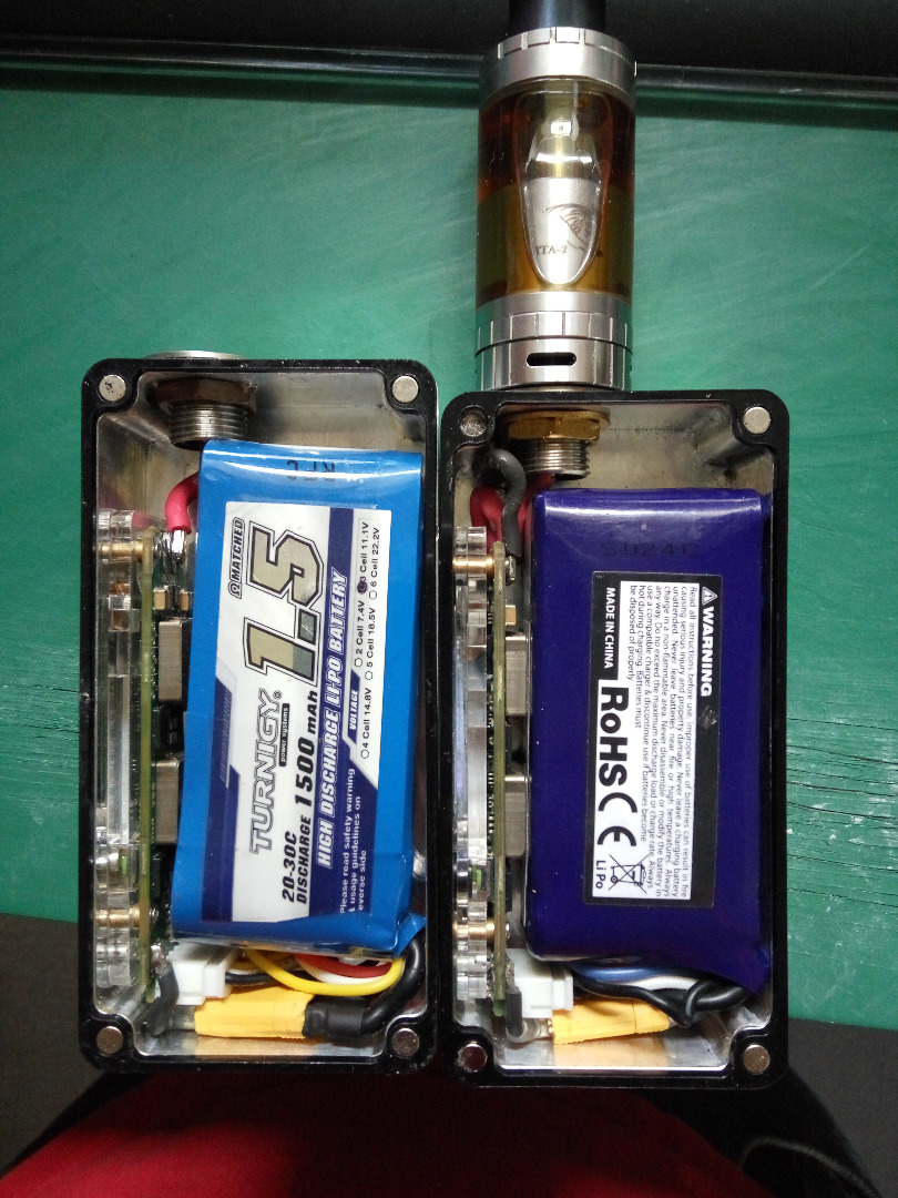

lugh23 Posted August 10, 2016 Author Report Posted August 10, 2016 Another guy suggested this? http://www.hobbyking.com/hobbyking/store/__11903__Turnigy_nano_tech_1300mah_3S_25_50C_Lipo_Pack.html which would fit perfectly into the casing I am thinking of getting, is it okay? He also sent me a pic of a 1500mah in his mod though the casings height is 22mm and the exact same battery I checked was 28mm so dunno how it fitted.

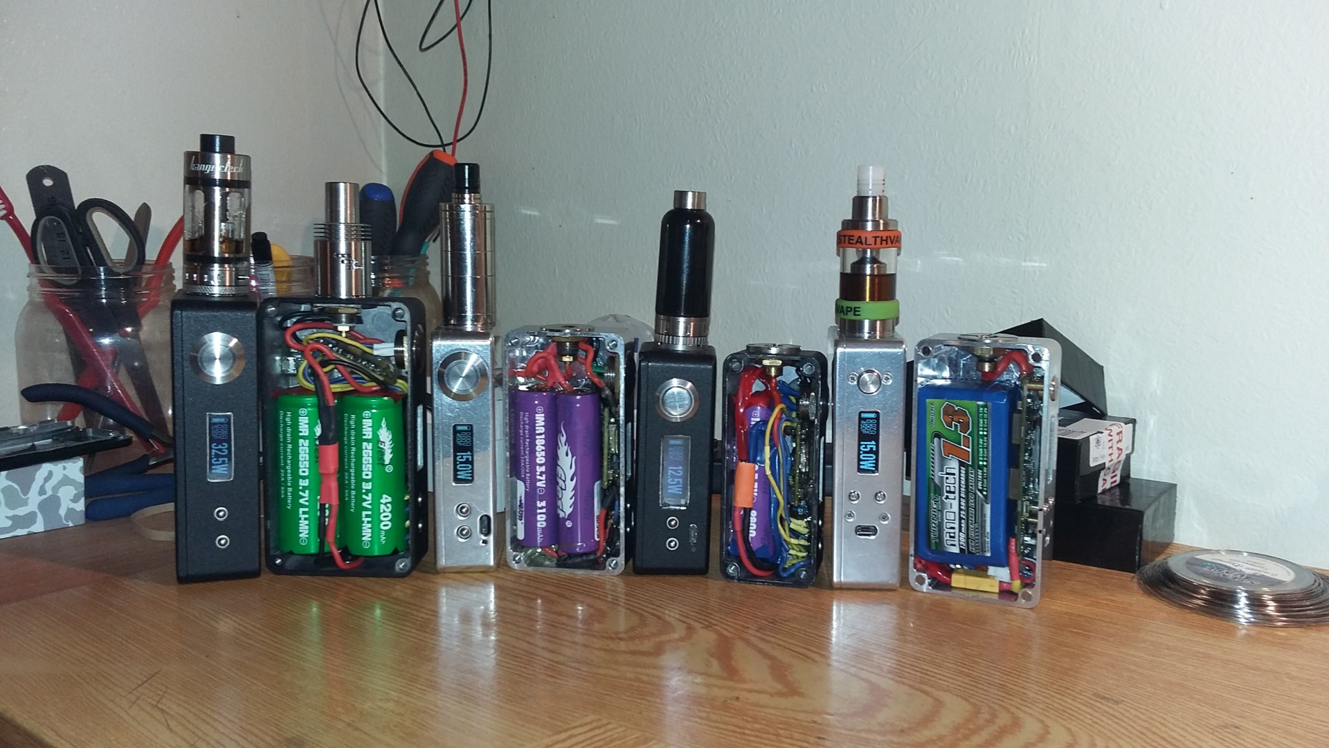

black lace Posted August 10, 2016 Report Posted August 10, 2016 Probly a spacer gasket.. and yes i use them or thoes batteries, you know the boards got a 1amp charger and you can allways give it a twenty minit blast or whatever to top up, no disrespect but dont let battery size do your head in, most are using 900 / 1300.. i like the way hes got the 510 nut butted against the corner post to help keep it firm. I prefer mine in the centre and would have put my jsth connector on leads so it would tuck in down by my xt connector giveing better clearence at the top, but were all bonifide builders and the 200 is the best tool to have in a mod.
