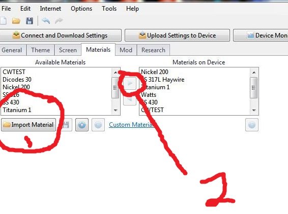

tennisguru1 Posted September 20, 2018 Report Posted September 20, 2018 26 minutes ago, dwcraig1 said: I just tried it with Google Chrome browser and it didn't work. Then I tried Internet Explorer and that worked. Thanks, it works perfect in IE. So much to learn, so different than stock. Trying to load a .cvs file from my buddy who told me to get this Evolve platform. Not quite understanding this upload a .cvs file? I have it on my computer, can I not just upload it to the mod or evolve first then the mod?
dwcraig1 Posted September 20, 2018 Report Posted September 20, 2018 Import it into Escribe then upload settings to mod using "up load settings" button in Escribe.
tennisguru1 Posted September 20, 2018 Report Posted September 20, 2018 8 minutes ago, dwcraig1 said: Import it into Escribe then upload settings to mod using "up load settings" button in Escribe. I can't see the .cvs file , it is in the folder?
tennisguru1 Posted September 20, 2018 Report Posted September 20, 2018 11 minutes ago, tennisguru1 said: I can't see the .csv file , it is in the folder? There is no load .csv option anywhere? I just keep going in circles. I get an Volcano_LavaBox_M_75.ecig but the .csv file is in same folder and cant see it?
dwcraig1 Posted September 20, 2018 Report Posted September 20, 2018 What is the purpose of the file? profile, battery, ect.
tennisguru1 Posted September 20, 2018 Report Posted September 20, 2018 4 minutes ago, dwcraig1 said: What is the purpose of the file? profile, battery, ect> Is it really this hard to lad a simple .csv saved file? This is really frustrating? It is just an atomizer setting of TCR values. I see these files everywhere. Here is the file Sai Donut.csv

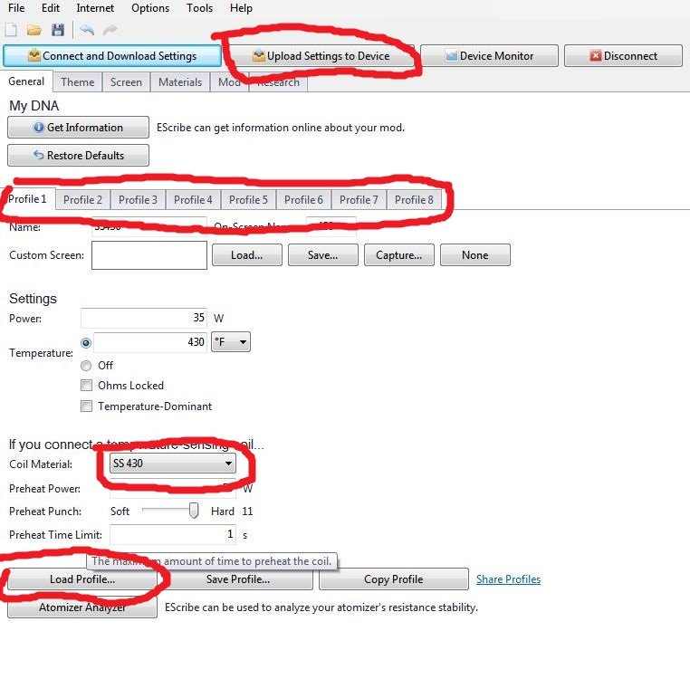

tennisguru1 Posted September 20, 2018 Report Posted September 20, 2018 (edited) Ok Thanks I got it on the device now it says, but not showing up in profile? I guess 1 more step? How do I move the .csv file to profile 1? so close, yet so far away, lol. Thanks for your patience, I really appreciate this. I was ready to just give up as this is way to hard to do with deep knowledge. nothing intuitive about this process, I would be lost without your kind help. ty Edited September 20, 2018 by tennisguru1
dwcraig1 Posted September 20, 2018 Report Posted September 20, 2018 Pick which way.... profile or material Note: the mod can only store 8 materials, materials can not be deleted if used in a profile so change to another material as needed first when the occasion arises.
tennisguru1 Posted September 21, 2018 Report Posted September 21, 2018 8 minutes ago, dwcraig1 said: Pick which way.... profile or material 9 minutes ago, dwcraig1 said: Pick which way.... profile or material Note: the mod can only store 8 materials, materials can not be deleted if used in a profile so change to another material as needed first when the occasion arises. Note: the mod can only store 8 materials, materials can not be deleted if used in a profile so change to another material as needed first when the occasion arises. I,m sorry, just lost me. My head hurts & my 71 yr old eyes are screaming. I'm so close, I just want this one profile, nothing else. I'm stuck, makes no sense how do I chose profile or material I just want one that works and goes on mod, Whew you are so Awesome. I would have hit me in the head if I were you by now.
dwcraig1 Posted September 21, 2018 Report Posted September 21, 2018 select profile number and "Load Profile" button....upload settings
