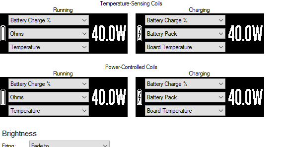

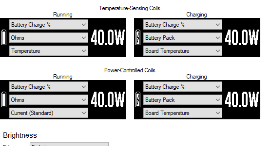

DJSiLites Posted August 28, 2016 Author Report Share Posted August 28, 2016 Hi Thanks for your reply. I have to select the same display information in both to get that info on device. If I have different items for power and temp modes the device randomly selects one of the two options to display. 1st pic shows 3rd info line as temp in temp mode and current in power mode when I upload to device most of the time it shows current in both power and temp modes but sometimes it will show temp in both modes. The only way to guarantee that the info on device is the same as set is to make both power and temp screens the same second pic. Thought USB current may be only on 200, do you know if there is an options comparison list available to show differences between 200 and 75. Thanks for your helpCheersSi Link to comment Share on other sites More sharing options...

Spector NS5 RD Posted August 28, 2016 Report Share Posted August 28, 2016 strange why you can't display different field options in power and tc screens. i can have completely different boxes for all and have them upload fine. maybe you think you're leaving tc mode and going into plain power but you're not. as for a list i'll list what i can remember.....dna 200 - 9v limit dna 75 - 6.2v limit usb current displayable no usb current displayable manual input of watt hours not able to input wh's manually no programmable LED's programmable LED watt hour based batt meter voltage based batt meter no reverse batt protection (fuse) reverse batt protection (mos) buck dc dc only buck - boost dc dc 97% efficient 85% efficient more options in device monitor less options in device monitor usb voltage displayable no usb voltage displayable usb power displayable no usb power displayable watt hour charge % displayable no wh charge % charge displayablethere's more but those are the major differences i can think of for now. Link to comment Share on other sites More sharing options...

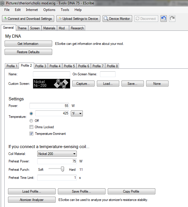

cholis211 Posted August 30, 2016 Report Share Posted August 30, 2016 hi, i already escribe my DNA75, with custom image on profile.but it can't show on my device.my device only show PRESET 1 and COIL MATERIAL ONLY (PRESET 1 on all coil material) Link to comment Share on other sites More sharing options...

Spector NS5 RD Posted August 31, 2016 Report Share Posted August 31, 2016 cholis211 said:hi, i already escribe my DNA75, with custom image on profile.but it can't show on my device.my device only show PRESET 1 and COIL MATERIAL ONLY (PRESET 1 on all coil material) are you "uploading" your custom screens to your mod once you load them in escribe? you can't load custom screens for materials, only custom screens for the 8 profiles, if that makes sense. press and hold -/+ to lock power/temp then double tap - or + to scroll through your 8 profiles. your custom screens will be in there. Link to comment Share on other sites More sharing options...
cholis211 Posted August 31, 2016 Report Share Posted August 31, 2016 ChunkyButt200 said:are you "uploading" your custom screens to your mod once you load them in escribe? you can't load custom screens for materials, only custom screens for the 8 profiles, if that makes sense. press and hold -/+ to lock power/temp then double tap - or + to scroll through your 8 profiles. your custom screens will be in there. Thanks for reply, got it Link to comment Share on other sites More sharing options...
