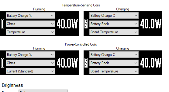

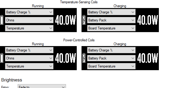

  2. Hi Thanks for your reply. I have to select the same display information in both to get that info on device. If I have different items for power and temp modes the device randomly selects one of the two options to display. 1st pic shows 3rd info line as temp in temp mode and current in power mode when I upload to device most of the time it shows current in both power and temp modes but sometimes it will show temp in both modes. The only way to guarantee that the info on device is the same as set is to make both power and temp screens the same second pic. Thought USB current may be only on 200, do you know if there is an options comparison list available to show differences between 200 and 75. Thanks for your help Cheers Si
  3. Hi I am not sure if this is a fault or simply not a feature but when setting up display options on my new hcigar dna75 there are some differences to my vaporshark DNA 75. When selecting which data to display in temp and power modes (screen tab) if you try and set charge or using screens to display different settings in power/temp mode (bottom line watts in temp and current in watts) will not work. You have to change in both modes together to get display to change on device. This is handy and works on my 200. As I said not sure if this simply is not just a feature on the 75 or a bug. I am dotting the tick box only in temp profiles. Also there is not an option on the 75 to display USB charge current when charging like the 200 but again this may only be a feature on the 200 or indeed just feature of vaporshark. Does anyone no what features differ on stock 200 and 75 boards? Cheers Si
