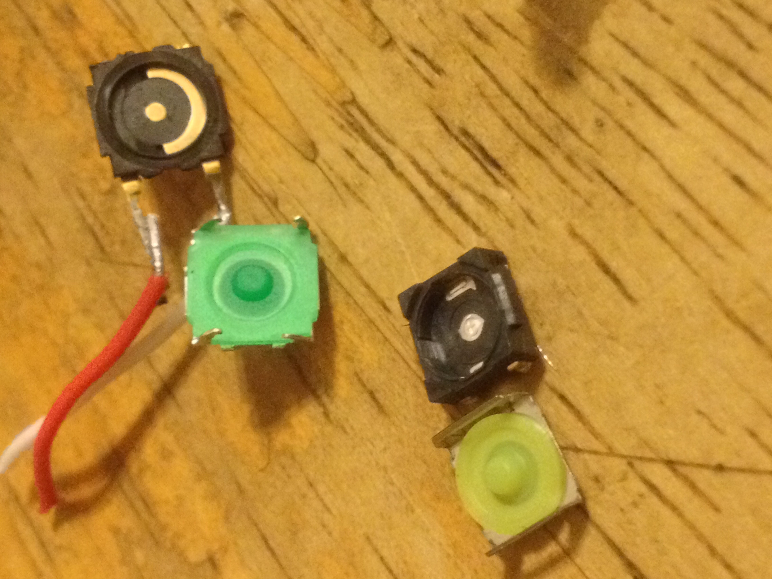

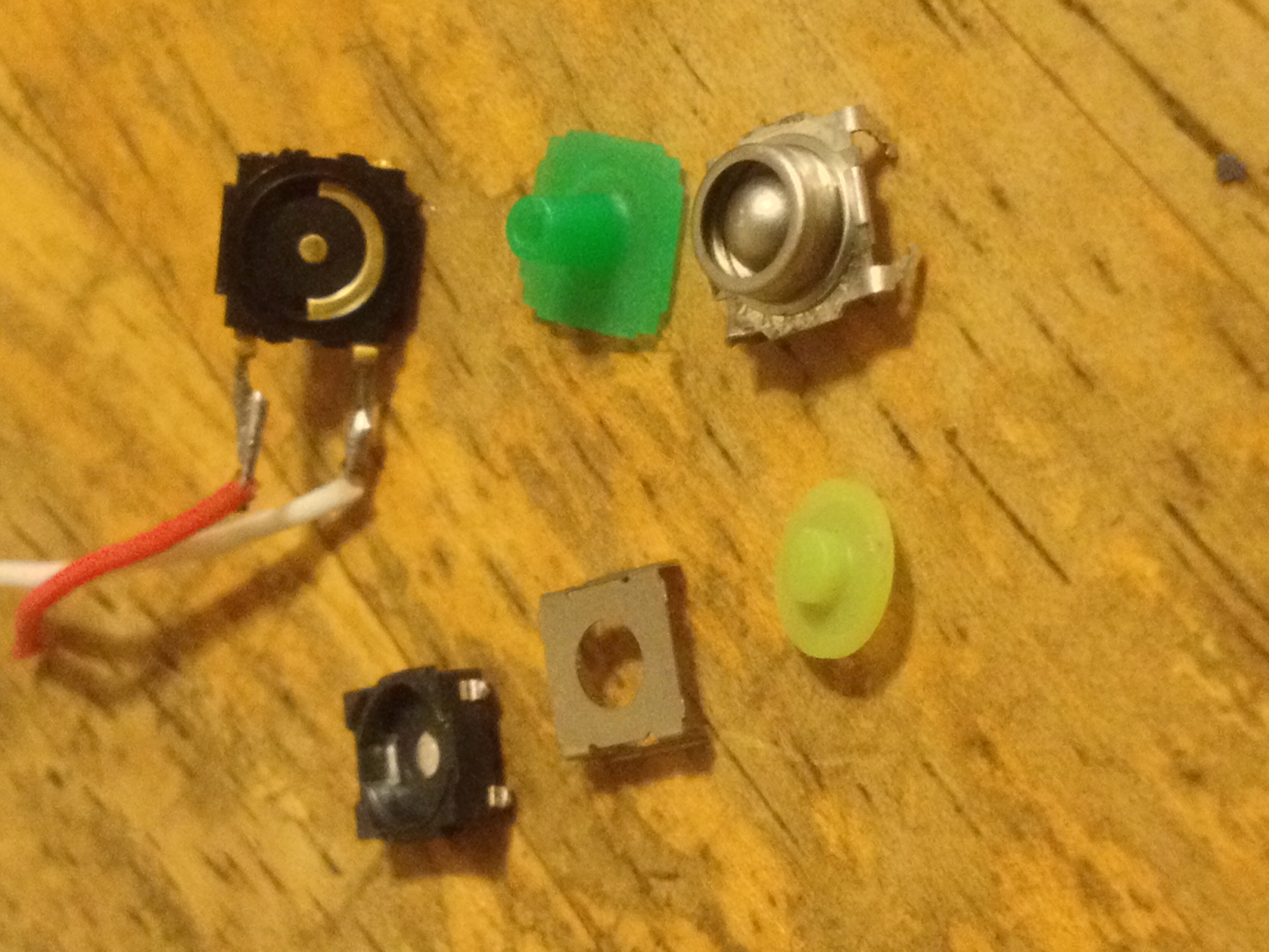

turbocad6 Posted August 16, 2015 Report Posted August 16, 2015 the dome tact's are not waterproof I searched for waterproof micro switches like this and never found anything good. these are said to be waterproof, meaning there def not just the cheapest switches, there probably higher quality than the ball tact's really would be my guess.

Guest Posted August 21, 2015 Report Posted August 21, 2015 turbocad6 said:the dome tact's are not waterproof I searched for waterproof micro switches like this and never found anything good. these are said to be waterproof, meaning there def not just the cheapest switches, there probably higher quality than the ball tact's really would be my guess.they look no different then the ones on the board
Brandon Posted August 25, 2015 Report Posted August 25, 2015 We use waterproof Omron buttons (IP67) on the 200. Rather than remove the buttons, you could remove the button enclosure and rubber actuator which would be easier and protect against accidental button presses.

turbocad6 Posted August 25, 2015 Report Posted August 25, 2015 the cheap little bb type buttons are NOT ip67 rated which is why I think the onboard buttons are probably better than the external bb buttons, and they do feel better to me than the bb's
