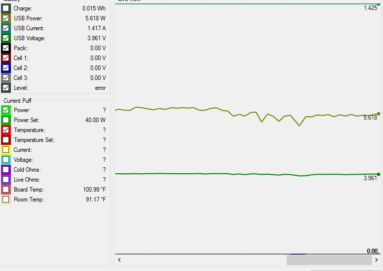

Synoptex said:
Having the exact, exact, exact same issue with my brand new Triade. Only 2 puffs were made. Changed all the wirings to copper. Checked the fuse with multimeter - working. Any suggestions? I'm just wondering if it is a Chip or outside chip wirings/connections.
it shouldn't be drawing more than .5 amps when connected to escribe. you also have no cell voltages. you could of damaged the board while replacing the wires, can't say for sure. i do know for a fact the dna 200 onboard charger will NOT draw more than 1 amp while charging, ever, so that's a cause for concern. take it all back apart and double check your wiring and solder joints. also check the board for any missing/damaged components. can i ask, why did you feel the need to change the wiring?
