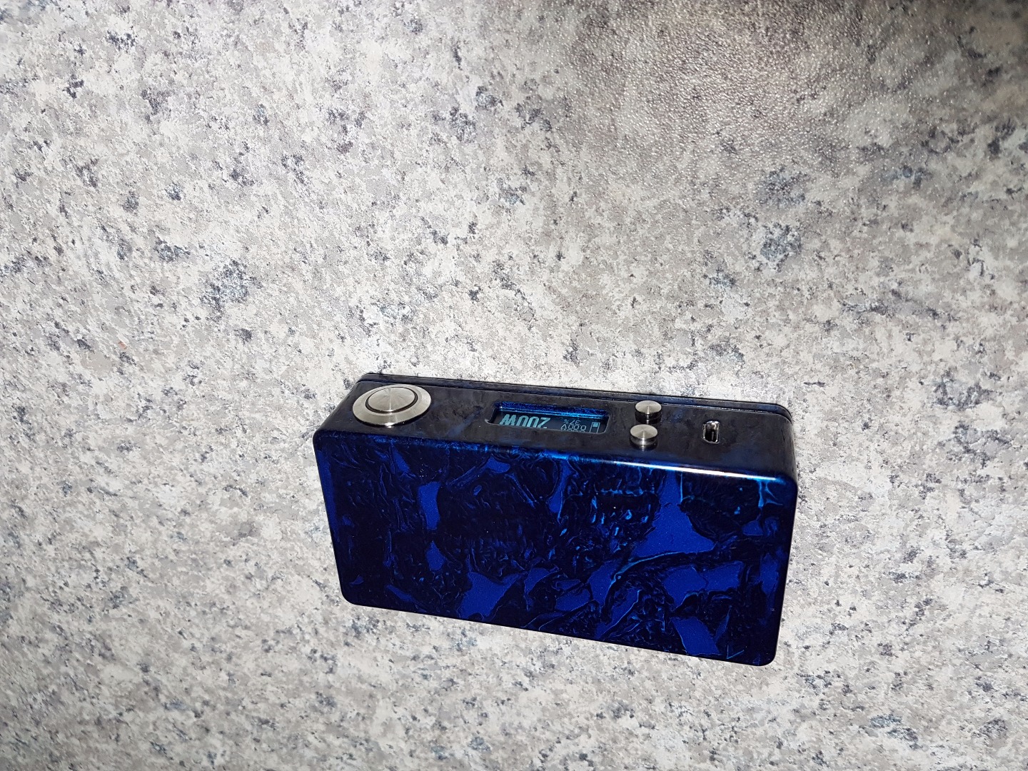

John la Posted November 10, 2016 Author Report Posted November 10, 2016 I put the board into a gbox with a mitech switch and it works like a dream again
black lace Posted November 11, 2016 Report Posted November 11, 2016 Nice looking build mate, you have no issues with the screen ribbon with that extra bit of clearance from the switch up there, still a biytch to assemble though "" i bet ""
