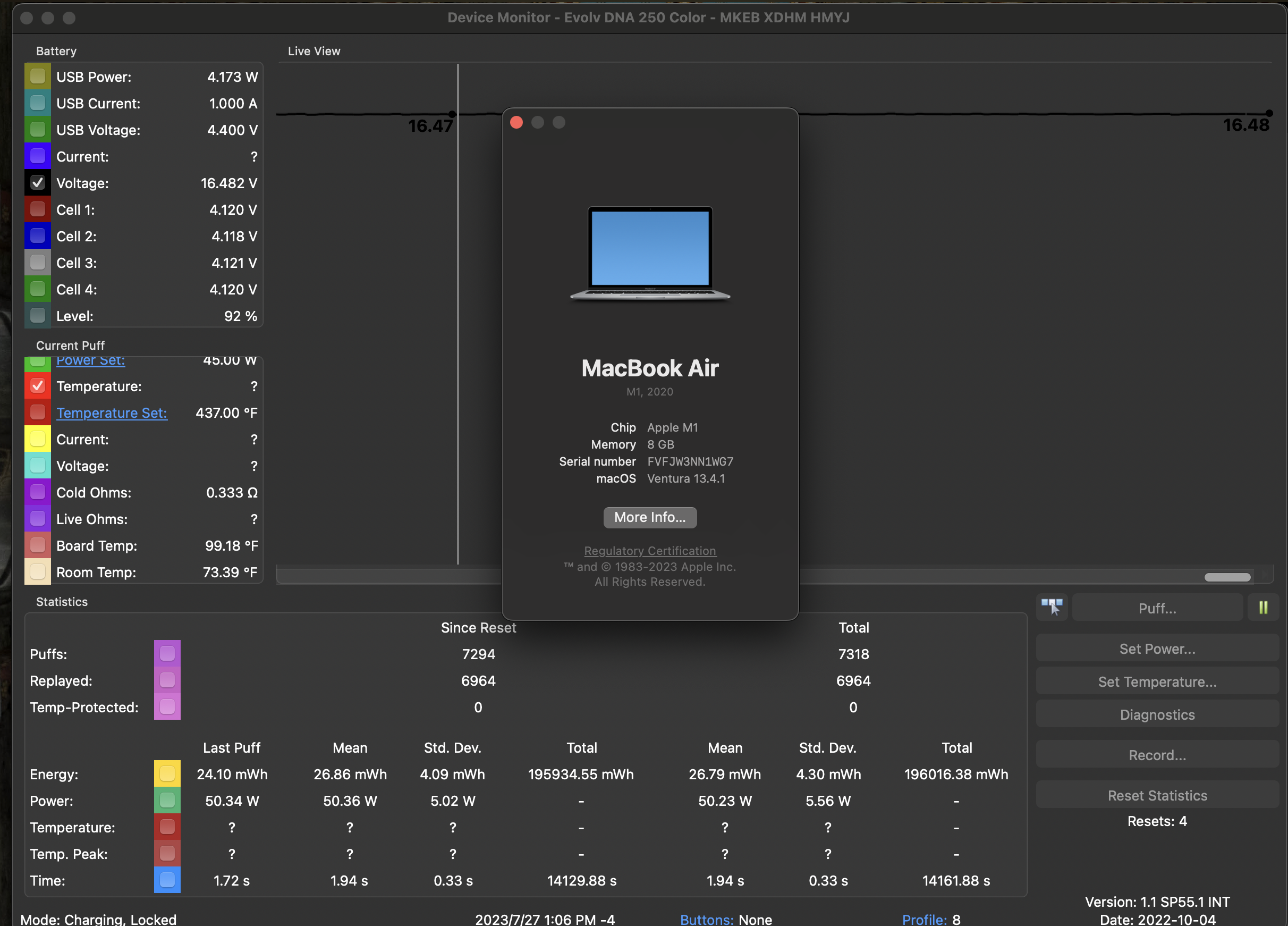

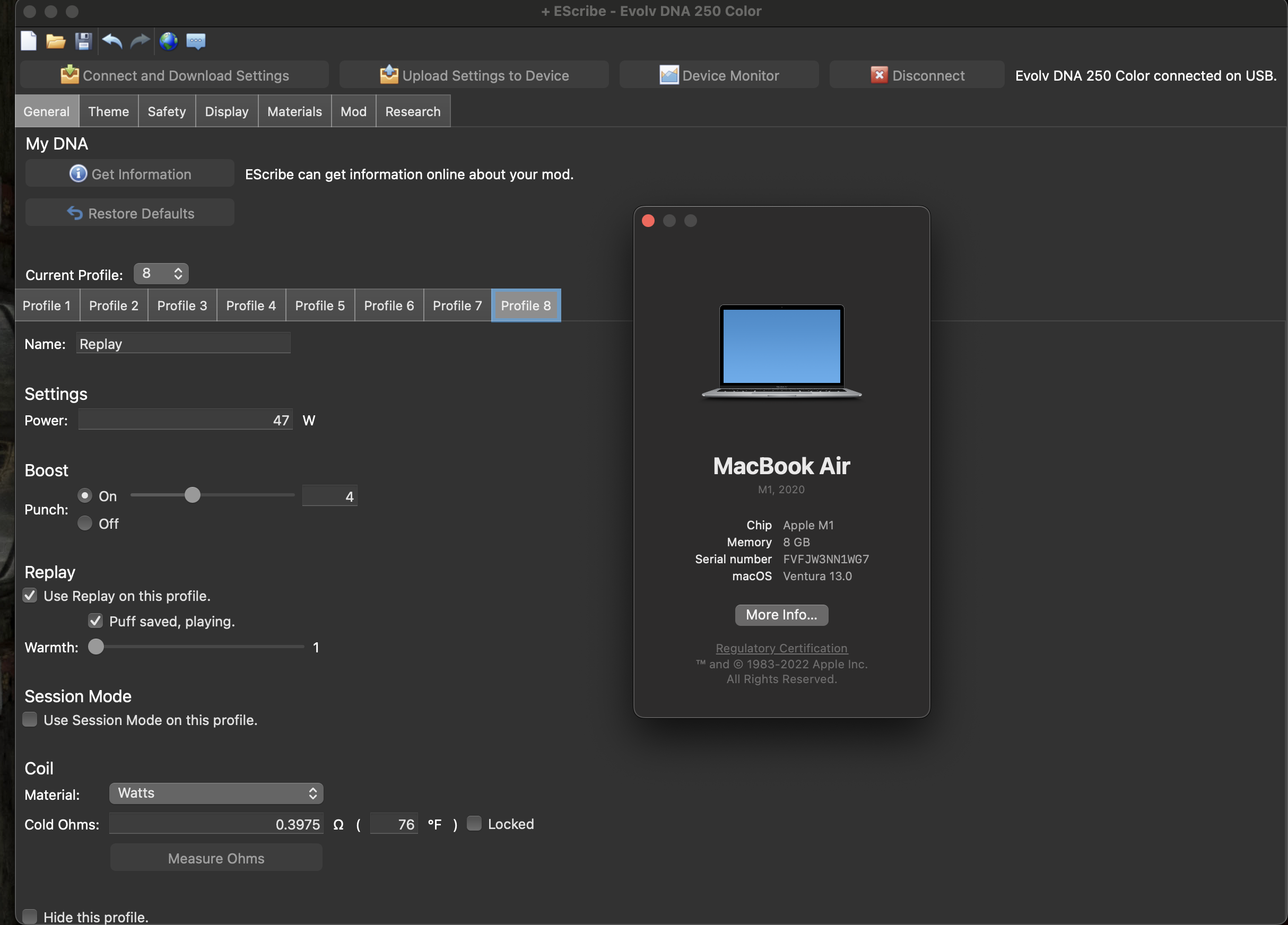

Wayneo Posted July 12, 2023 Report Share Posted July 12, 2023 @NavyChiefRetired My daughter has an M1, I'll see if she'll let me borrow it. Did it ever work on that Air, or was this a first time try? I'm going to load the latest SP50 INTL version. 1 Link to comment Share on other sites More sharing options...
Wayneo Posted July 12, 2023 Report Share Posted July 12, 2023 M1 running 13.0 and SP50 INT started up just fine. She'll upgrade within 24 hours. Plugged in via a single USB A to micro. 1 Link to comment Share on other sites More sharing options...

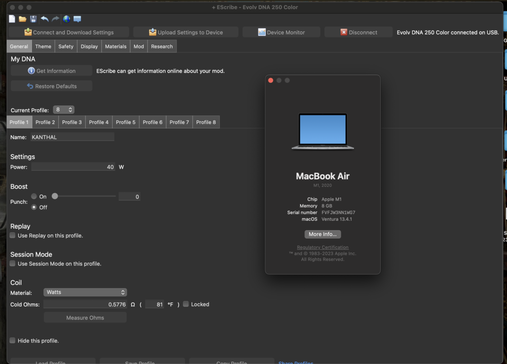

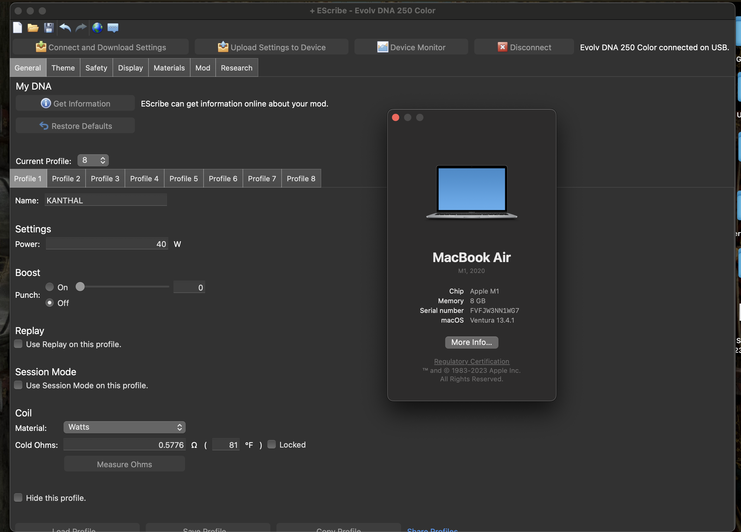

NavyChiefRetired Posted July 13, 2023 Report Share Posted July 13, 2023 (edited) 2 hours ago, Wayneo said: @NavyChiefRetired My daughter has an M1, I'll see if she'll let me borrow it. Did it ever work on that Air, or was this a first time try? I'm going to load the latest SP50 INTL version. First time installing it on this computer 2020 M1 MacBook Air running Ventura 13.4.1. It'll start up just fine but as it's downloading the mods settings (Paranormal DNA 250) Escribe just shuts down without showing any errors. Escribe SP50 runs perfectly fine on my old Intel MacBook Pro with the same mod and usb cable. Edited July 13, 2023 by NavyChiefRetired Link to comment Share on other sites More sharing options...
NavyChiefRetired Posted July 15, 2023 Report Share Posted July 15, 2023 (edited) Still not able to get any version of Escribe to run without crashing on my 2020 M1 MacBook Air Ventura 13.4.1. Any assistance from anyone would be much appreciated. Thanks Edited July 15, 2023 by NavyChiefRetired Link to comment Share on other sites More sharing options...
Wayneo Posted July 27, 2023 Report Share Posted July 27, 2023 Super late reply and it worked completely fine at 13.4.1 1 Link to comment Share on other sites More sharing options...
NavyChiefRetired Posted July 28, 2023 Report Share Posted July 28, 2023 Yes, I can load the monitoring portion, but I am unable download, change, and upload any of the setting. Program crashes when downloading the settings from my DNA mod. Right when it reaches 100%... boom it crashes. Link to comment Share on other sites More sharing options...

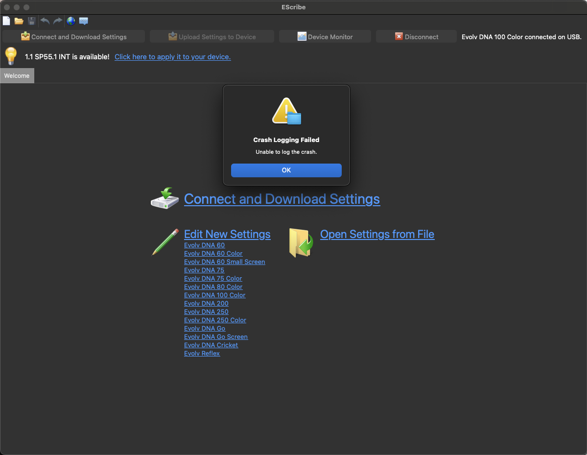

JAB Posted January 8 Report Share Posted January 8 (edited) Hello, I would like to share my experience installing and using the latest version of eScribe SP57 INT on my 2024 Mac mini (M4/32GB, macOS Sequoia 15.1.1). The installation process itself went smoothly, with no issues encountered during setup. However, I faced a recurring issue when attempting to connect my new (New Old Stock) Evolv DNA 100 Color device, which was paired with a brand-new Samsung 40T 21700 battery (4000mAh, ~15% charge). I used a high-quality Anker USB-C to USB-C cable to connect the device to my Mac. Upon connection, eScribe successfully recognized the device and initiated the settings download. The download progressed as expected until it reached 100%, but then I encountered a persistent error message: “Crash Log Failed – Unable to log Crash”. Clicking “OK” would return me to the main interface, but the only available option was to retry the connection and download, which resulted in the same crash each time. To troubleshoot, I switched to a Windows 11 Virtual Machine, installed the Windows version of eScribe, and connected the same device via USB. This approach worked flawlessly—the settings download completed without issues, and I was able to update the firmware to 1.1 SP55.1 INT without further complications. Given this, I am unsure if the issue on macOS was caused by the low initial battery level (~15%) or perhaps a compatibility problem specific to the macOS version or USB interface. It’s worth noting that after some time connected to the Mac mini, the device likely charged slightly, which may have contributed to more stable behavior when switching to the Windows environment. I would prefer to avoid using a virtual machine for routine updates or tweaks, so I hope future updates might address this behavior on macOS. Despite this hiccup, I appreciate the robust functionality of eScribe on Windows and the flexibility it provides once properly connected. Thank you for your ongoing support and development of this software. If additional logs or details would help in diagnosing the issue, I am happy to provide them. Warm regards Edited January 8 by JAB Link to comment Share on other sites More sharing options...
