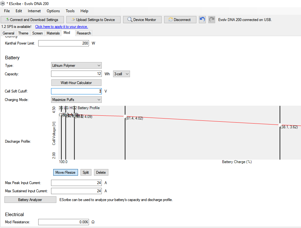

Spector NS5 RD Posted December 10, 2016 Report Share Posted December 10, 2016 under the "mod" tab of EScribe, you would need to change from 2-cell to 3-cell operation - input the watt hours of the lipo (around 12 wh's) - set the "cell soft cutoff" to 3v. also make sure "kanthal max power limit" is set to 200.the "mod" tab is only in the advanced and manufacturers UI under "OPTIONS" at the top of EScribe. 1 Link to comment Share on other sites More sharing options...

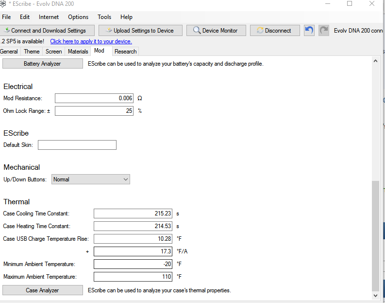

fibercarbon Posted December 10, 2016 Author Report Share Posted December 10, 2016 did those settings. what about the CSV or any of the rest of the settings on the MOD Tab?? Link to comment Share on other sites More sharing options...
Spector NS5 RD Posted December 10, 2016 Report Share Posted December 10, 2016 you can search around for someone else's CSV for an 1100 mah lipo or you can run BA yourself. i can post my VT200's CSV for you to use in the mean time, if you'd like. it's kind of close to 1100 mah (11.28 wh's).edit - never mind, i don't have the CSV anymore. Link to comment Share on other sites More sharing options...

fibercarbon Posted December 10, 2016 Author Report Share Posted December 10, 2016 so stick with 12? escribe came up with 12.21 when set at 3 cells and Nominal packk voltage of 11.1? Link to comment Share on other sites More sharing options...

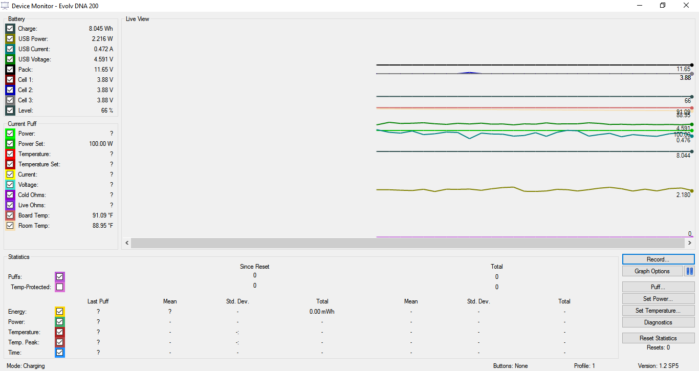

fibercarbon Posted December 10, 2016 Author Report Share Posted December 10, 2016 the usb current on this mod is capped at 1a i think but not sure? it is charging sloww. 1 Link to comment Share on other sites More sharing options...
VapingBad Posted December 10, 2016 Report Share Posted December 10, 2016 fibercarbon said:so stick with 12? escribe came up with 12.21 when set at 3 cells and Nominal packk voltage of 11.1?Yeah I believe that LiPos curves are all similar unlike 18650s, it is only to make the battery gauge more accurate, nothing to stress about, but the cell number and battery type are though they need to be right. 1 Link to comment Share on other sites More sharing options...
Spector NS5 RD Posted December 10, 2016 Report Share Posted December 10, 2016 some people are OCD about their settings. i for one get it close and call it "good to go". EScribe gave you a calculated number. in real life/real world use, you'll see anywhere from 11-12.21 wh's. that's why BA is there, to get your specific battery's CSV curve and watt hour capacity. Link to comment Share on other sites More sharing options...

Spector NS5 RD Posted December 12, 2016 Report Share Posted December 12, 2016 LOL, it's only been 2 days since you posted about the lipo, fiber! give it a little longer for response from here and for a response to your email from Starss. you can still use the lipo in the meantime. you won't hurt anything. in EScribe, set the battery fields to "lithium polymer", "3 cell", throw in "12" for the watt hours and "3" for the cell soft cutoff voltage. upload those settings to your devices and BINGO BANGO you're vaping on a lipo. 1 Link to comment Share on other sites More sharing options...
