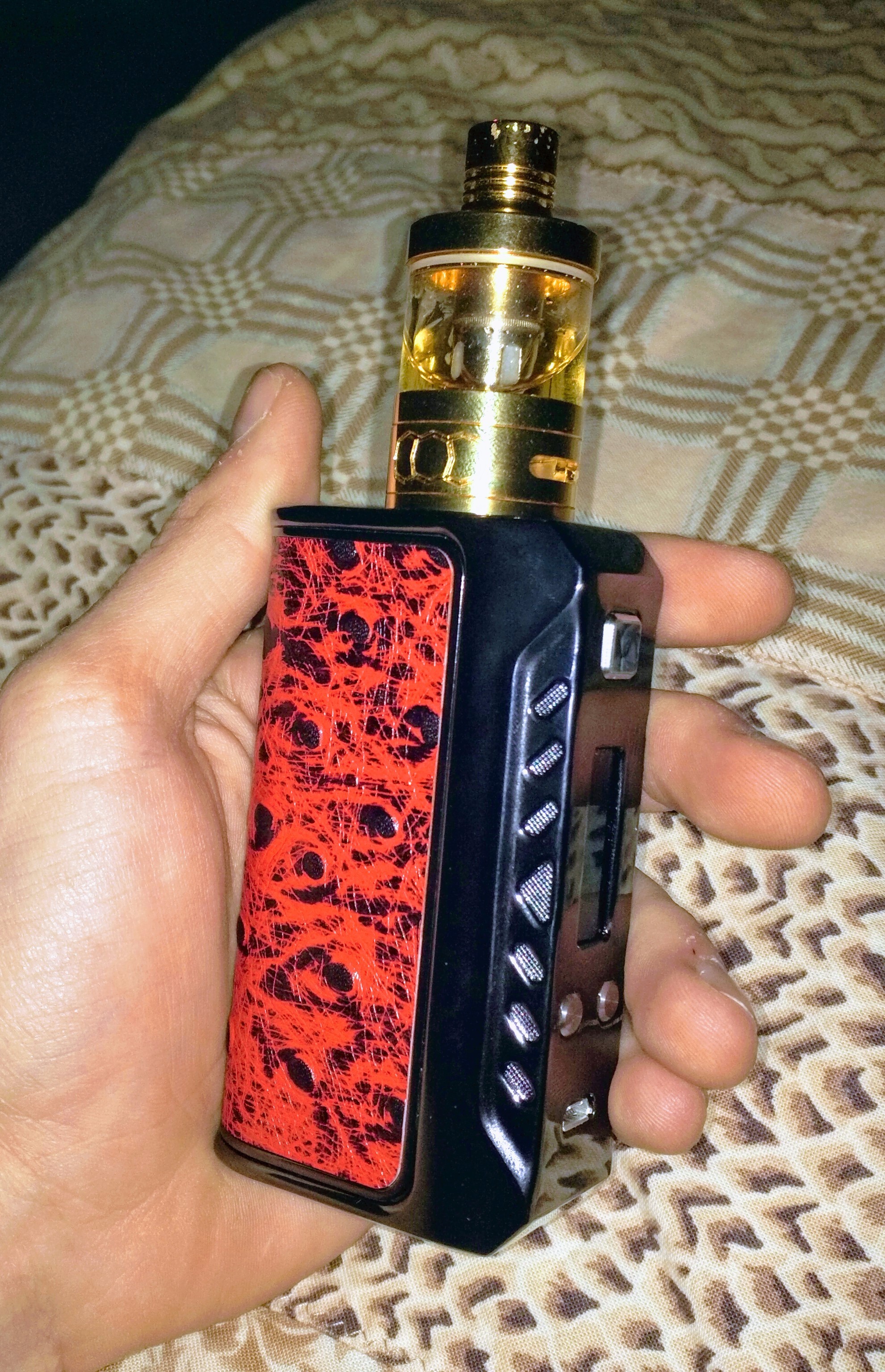

Theplasticbling Posted December 24, 2016 Author Report Share Posted December 24, 2016 Thanks for all the advice guys! My mod just came in today, and I'm loving it so far! One last quick question, in the manual it says the max charge current is 1 amp, but says you can adjust it in escribe. How would I go about changing the current to 2 amps? Thanks again everyone, happy holidays! Link to comment Share on other sites More sharing options...
Spector NS5 RD Posted December 24, 2016 Report Share Posted December 24, 2016 Theplasticbling said:Thanks for all the advice guys! My mod just came in today, and I'm loving it so far! One last quick question, in the manual it says the max charge current is 1 amp, but says you can adjust it in escribe. How would I go about changing the current to 2 amps? Thanks again everyone, happy holidays!sweet looking device. If it's A DNA 200 It's 1 amp max, adjustable from 0 to 1 amp. If it's A DNA 250 it's 2 amps max, adjustable from 0 to 2 amps. Link to comment Share on other sites More sharing options...
dywersant Posted December 24, 2016 Report Share Posted December 24, 2016 Its 2 amp charging. Just dont use the cable they provide, it can only go up to 1 amp (crappy cable) Link to comment Share on other sites More sharing options...

Theplasticbling Posted December 25, 2016 Author Report Share Posted December 25, 2016 My mod is actually the 133, which I think is the dna200 and not 250. So it would only be capable of 1 amp charging? Bummer, but not a huge deal. It's still faster than my external charger. Are there any advantages of the 200 over the 250 to make me feel better about myself lmao? I don't think I've ever gone past 120 watts anyways so the extra power isn't too big of a deal to me. Link to comment Share on other sites More sharing options...
