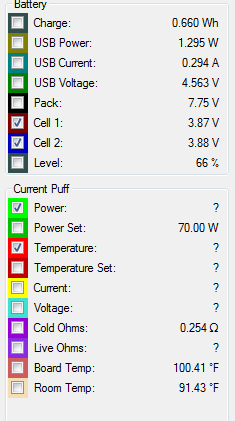

joseph1203 Posted December 26, 2016 Author Report Posted December 26, 2016 VapingBad said:Did you look at the cells under load (when firing) in Device Monitor to see if one is hitting the 2.8 V cut-off? that my battery profile under device monitor. how can i test the one that you've said?Did you look at the cells under load (when firing) in Device Monitor to see if one is hitting the 2.8 V cut-off?
joseph1203 Posted December 26, 2016 Author Report Posted December 26, 2016 ok sir i'll let you know if i already done it and i will screenshot it. did you find any issue regarding my screen capture of my device monitoring?
joseph1203 Posted December 26, 2016 Author Report Posted December 26, 2016 joseph1203 said:ok sir i'll let you know if i already done it and i will screenshot it. did you find any issue regarding my screen capture of my device monitoring? also on your device graph wheres the cell cut off be located?
VapingBad Posted December 26, 2016 Report Posted December 26, 2016 The soft cell cut-off is set on the mod tab, it doesn't show as such in DM, IIRC you already said yours was set to 2.8 V so look in DM to see if one cell is sagging that low when you take a puff. If it is just one cell swap their position and see if the same cell # in EScribe is sagging to 2.8 V then it is that connection, if it swaps to the other cell (the same battery) in EScribe it's the physical battery. If both are sagging that low it could be weak batteries or connections, those LGs aren't the punchiest battery but they should have no trouble at 60 W at 50% charge.

joseph1203 Posted December 27, 2016 Author Report Posted December 27, 2016 joseph1203 said: hi sir vaping bad ive notice when my battery was down to 35% battery check appeared. also while in battery analyser ive notice that my 2 cells reading was are 2.8V below when firing. my question is, is it normal now or any issue on my mod or cells? the cut off reaches however i have 35% more battery life and i need to charge right away even if i have 35% battery life?
VapingBad Posted December 27, 2016 Report Posted December 27, 2016 It seems you would be better with more punchy batteries, I don't have any of those LGs but if they have been ran hard it is quite possible they have degraded enough to struggle at 35%. 60 W on a DNA 133 is not running that hard only 30 W per cell, only maxing at 11 A, if they are new are you sure they are genuine LGs?
