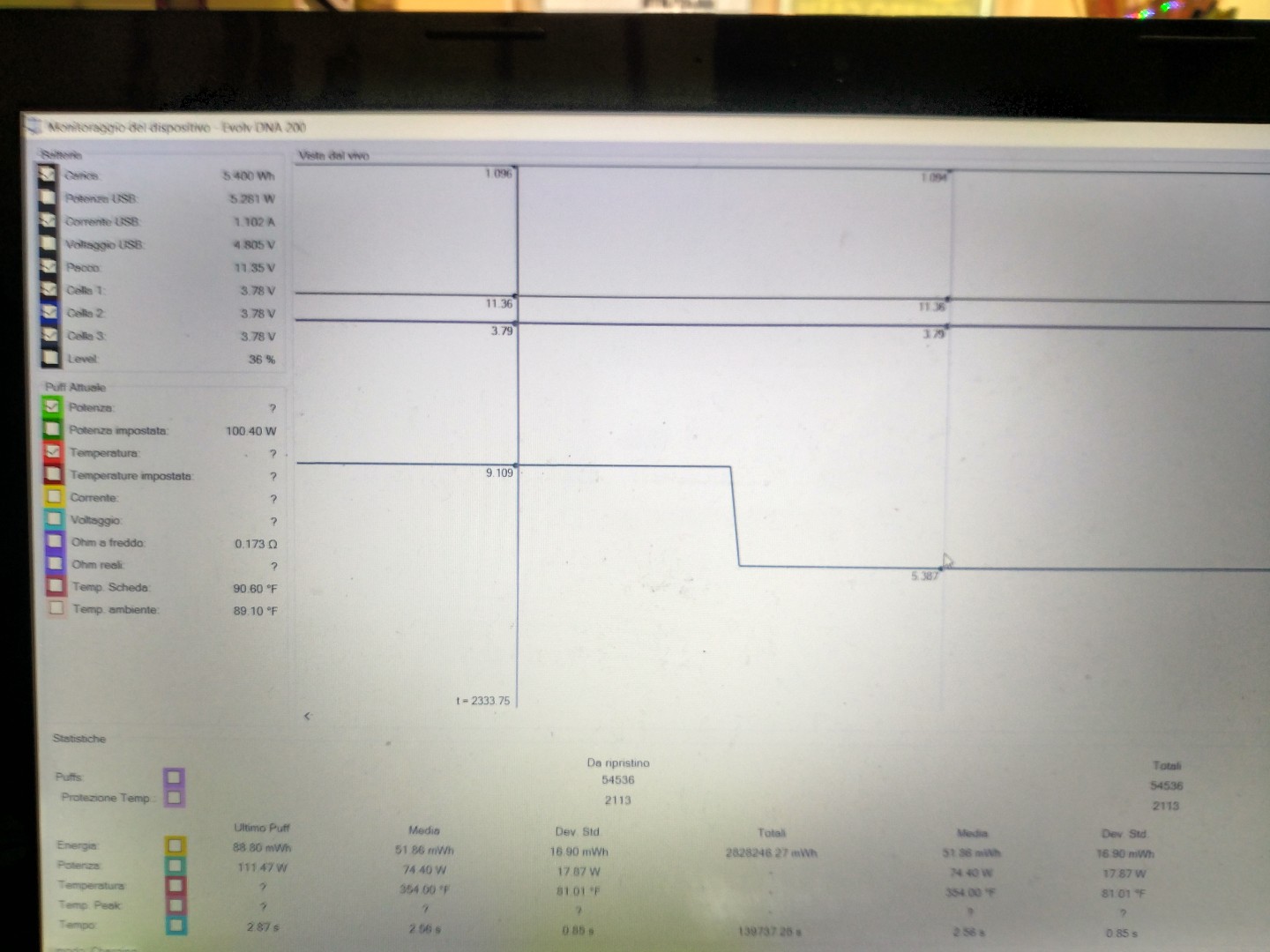

alemaz Posted January 18, 2017 Author Report Posted January 18, 2017 hi, i have a problem with my dna 200 (vtbox 200). The box was about a year and has been working with its original battery, a few days ago began to behave strangely, not reloading, if you reloaded is discharged immediately (for example by 10Wh after activation down to 5WH). I bought a new battery but behaves the same way, loading the lipo rc battery charger is charged with 4.2v for cell, inserted into the box works well. If i connect the box to escribe the box charges the battery (theoretically), the charge value rise but the cell voltages no, remains fixed to the moment I connected. After charging escribe and boxes give me 100% charge after some activation, wh me back to the moment I attached to escribe. I did a thorough cleaning of the circuit using the ultrasonic washing machine, I checked the welds but it looks okay. I'm waiting for a new battery to make the ultimate test ... died the charging circuit? you have any idea?Attached is the portion of the track where it is seen that the charge came to 9.1 wh and immediately drops to 5.3wh.sorry for my English, I used google translated

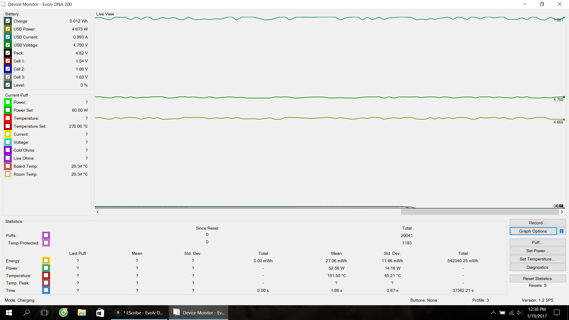

Spector NS5 RD Posted January 19, 2017 Report Posted January 19, 2017 xlaws said:I had the same problem with my efusion Mini. I bought a new battery but the problem not resolved.can you suggest me some solutions ? Thanks !sorry for my bad english !post a screenshot of Escribe's Device monitor with ALL of the battery boxes ticked.

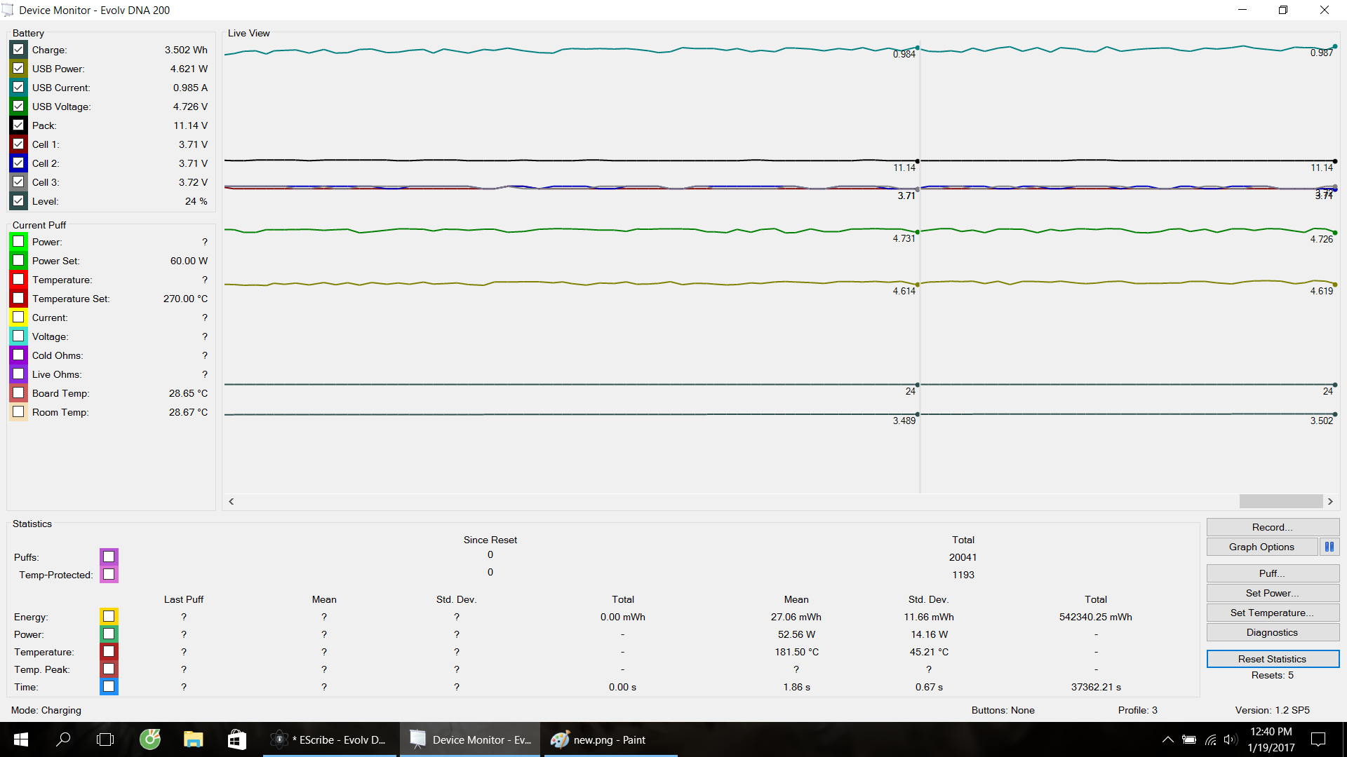

xlaws Posted January 19, 2017 Report Posted January 19, 2017 ChunkyButt200 said:post a screenshot of Escribe's Device monitor with ALL of the battery boxes ticked.this is my new battery and old battery.

VapingBad Posted January 19, 2017 Report Posted January 19, 2017 xlaws said:this is my new battery and old battery.It looks like the new battery is too low to accept a normal charge @ 1.6 V (cell) and you need to do USB recovery charge to bring it above 2.5 V to charge normally. Tools - Diagnostics - Perform USB Recovery Charging...
xlaws Posted January 19, 2017 Report Posted January 19, 2017 VapingBad said:It looks like the new battery is too low to accept a normal charge @ 1.6 V (cell) and you need to do USB recovery charge to bring it above 2.5 V to charge normally. Tools - Diagnostics - Perform USB Recovery Charging...I did that before my new battery drained to 0% but it not resolved. And i have a BYZ charger cable (display blue led when discharging and red led when charging) but it always display blue led for both batteries at every time.Sory for my bad english
VapingBad Posted January 19, 2017 Report Posted January 19, 2017 xlaws said:I did that before my new battery drained to 0% but it not resolved. And i have a BYZ charger cable (display blue led when discharging and red led when charging) but it always display blue led for both batteries at every time.Sory for my bad english You may need to do it several times as it has a time limit for safety.
