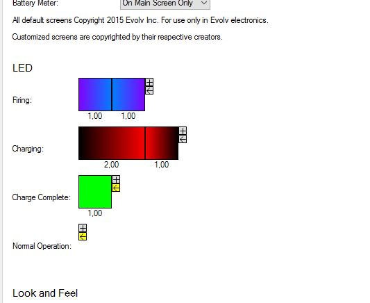

Spector NS5 RD Posted January 27, 2017 Report Posted January 27, 2017 ekspermesut said:h? all charge is completedno green light why ?help me please if it's a DNA 75, it will turn green, just give it time. Assuming your LED is set correctly in EScribe.
ekspermesut Posted January 27, 2017 Author Report Posted January 27, 2017 That's the settingbut no green light

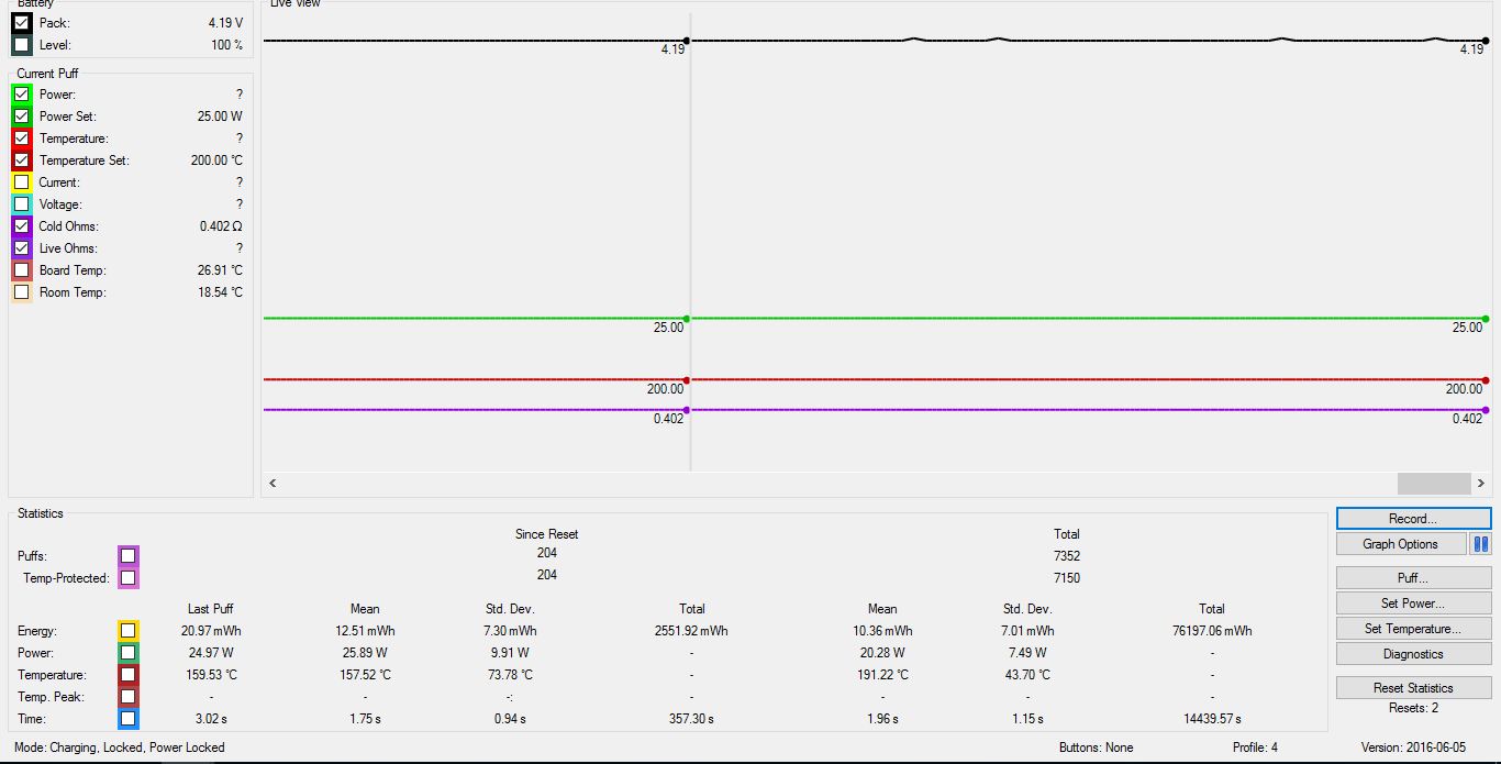

retird Posted January 27, 2017 Report Posted January 27, 2017 Can you post a screenshot of Device Monitor with the boxes checked for "Pack" and "Level"? Screenshot when the battery is fully charged....
giz_60 Posted January 27, 2017 Report Posted January 27, 2017 I have a couple of 75 devices. The device screen may read 100% & device monitor as well, depending on the battery settings. However, it is probably still charging..may it be ever so slightly, but still charging. The light will turn green eventually when the device senses the battery drawing no more charging current. As ChunkyButt200 stated...give it time!

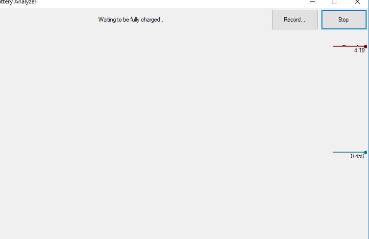

giz_60 Posted January 27, 2017 Report Posted January 27, 2017 According to the battery analyzer, your battery is still charging....
James Posted January 27, 2017 Report Posted January 27, 2017 4.2V does not mean charge is complete.Just as there is a voltage drop when you pull power from a battery, there is a voltage rise when you push power into a battery.When a battery is first charging, 1A is not enough to push the voltage to its target value. (This stage is called Constant Current charging. It takes about 2/3 of the time of charging.)When the voltage (while charging) reaches 4.2V, the charger essentially balances the voltage rise from charging with how far under the voltage would be if it weren't charging. If you click Diagnostics->Disable Charging, you can see this: the battery voltage will drop to its real level. (Be sure to enable it again. ) If the charger did not do this, as the current tapered off, it might end up above 4.2V. (This stage is called Constant Voltage charging. It takes about 1/3 of the time of charging.)This second stage is what you are seeing, most likely. It should eventually finish.
