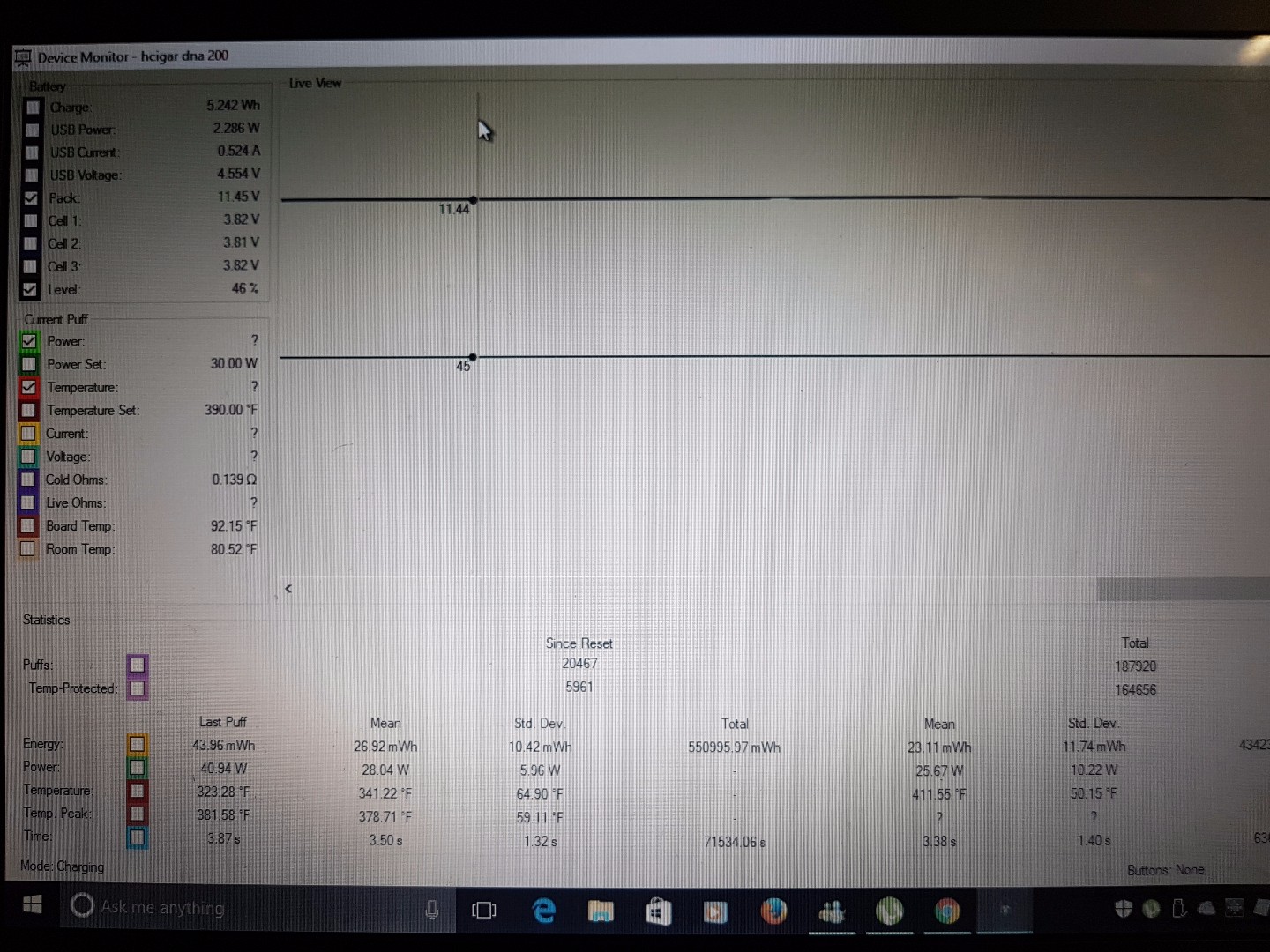

Ok, I have connected to device monitor and the battery voltage is all over the place.
One is reading at around 3.81V, the second at 3.11, and the third at 1.98V.
Putting them onto my charger shows them all to be the same voltage level.
