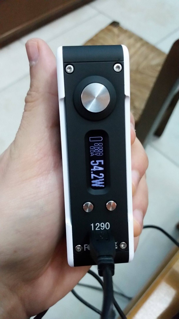

orso83 Posted January 30, 2017 Report Posted January 30, 2017 Hello!! this is my first post. Today I received the vtbox and when I connected via USB with the PC the battery was zero and no signs of life. What can I do to fix it?
VapingBad Posted January 30, 2017 Report Posted January 30, 2017 orso83 assuming your battery is connected OK (if you have a metre check the voltage at the battery lead) I would contact your vendor and demand a replacement mod or battery if it has stayed at 0 V for much time it's capacity will be reduced, it could even be dead. If that is not an option in Escribe - Options - User Interface - choose Advanced then try USB Recovery Charging from the Tools - Diagnostics menu, this may take several goes as it is time limited for safety.
orso83 Posted January 31, 2017 Report Posted January 31, 2017 hello!!I'm not resolve my problem and I thinking about changing the battery.In my vtbox 250 , it as a fullymax 1300mAh 3s 20c 11.1 v 14.4 wh . I have to buy a 20c or can I take a 30c?
Wayneo Posted January 31, 2017 Report Posted January 31, 2017 Sure, take a 30c as long as it will fit within the enclosure
orso83 Posted January 31, 2017 Report Posted January 31, 2017 excuse me for yet another question, can you tell me what should I consider for the purchase of new battery?
Spector NS5 RD Posted January 31, 2017 Report Posted January 31, 2017 orso83 said:excuse me for yet another question, can you tell me what should I consider for the purchase of new battery?here's one option...........http://www.ebay.com/itm/UPGRADE-LIPO-BATTERY-1300mAh-3S-11-1V-EFUSION-VAPECIGE-CUSTOM-EVOLV-DNA-200-250-/272517143930?var=&hash=item3f73499d7a:m:maVwXKjZiS5g_nUNSbq71Sw
dwcraig1 Posted January 31, 2017 Report Posted January 31, 2017 I used this one in my Vapecige VTbox200, it appears to be the same case. The power wires needed to be shortened and I had to change the plug to a "T" plug.Later Vapecige boxes use a XT-60 plug.https://hobbyking.com/en_us/turnigy-nano-tech-1300mah-3s-25-50c-lipo-pack.html
orso83 Posted February 6, 2017 Report Posted February 6, 2017 I have bought this turnigy nanotech but I'll have to change the connector, my vtbox 250 have a "T" plug connector. Before I'll change the connector I try to see if I can use the adapter "XT60" to "T" plug
