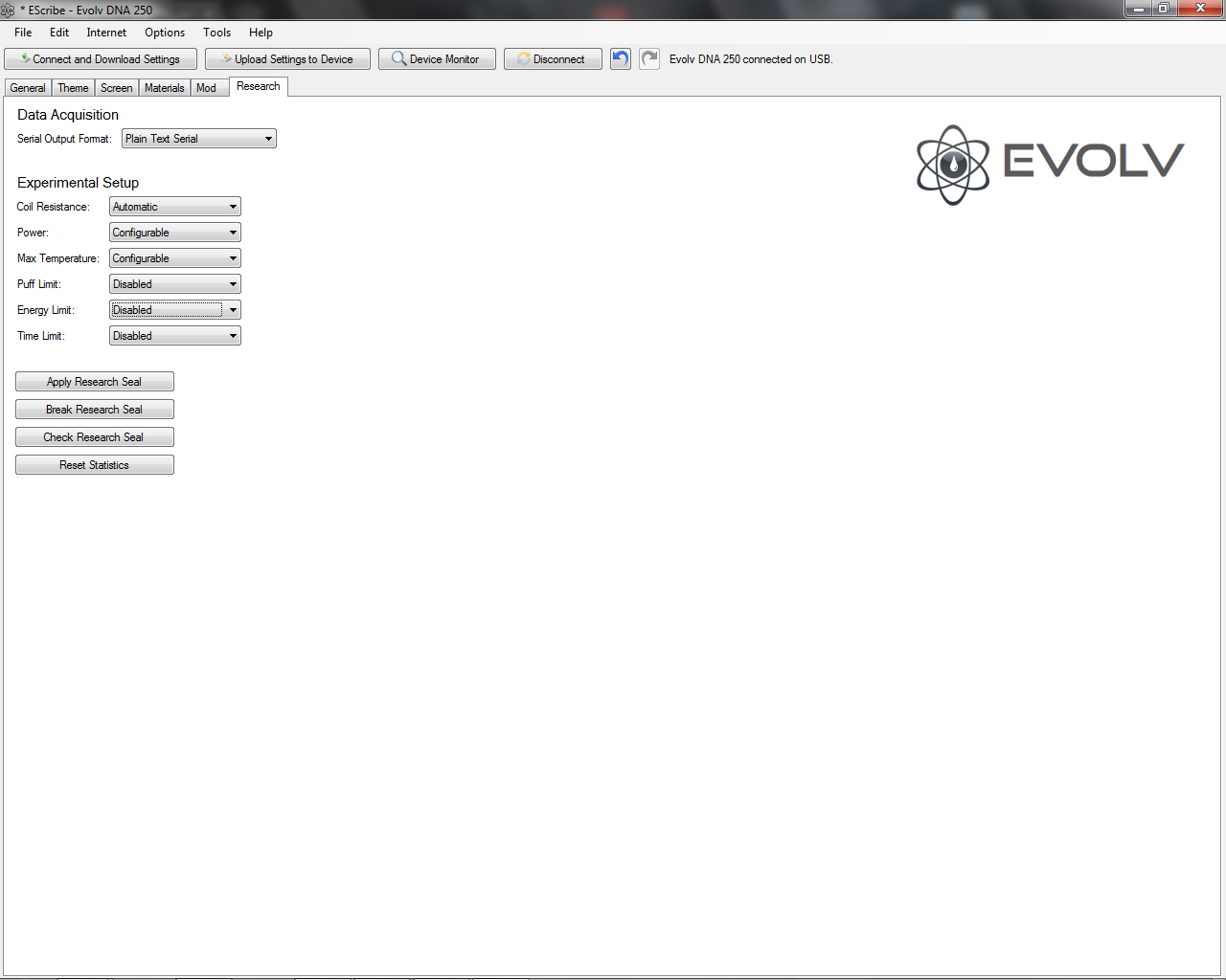

Some parameter(s)/settings on the 'Research' tab in Escribe have been met & the device is notifying you to return it to whoever set it. You may be able to clear them out there to get it going.

^ Agree.  That thing needs connected to escribe.
Options/User Interface/Manufacturer <---
Switch permissions to manufacturer, and then go to the research tab.  There have to be some kind of parameters set, and if escribe connects to the board.  It will download everything on the board and show you in escribe.  If it's tripping the research mode screen then some parameter was set and needs cleared before it will do anything.

This is the screen you want to look at.
