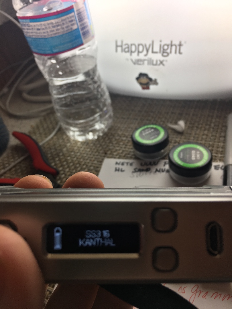

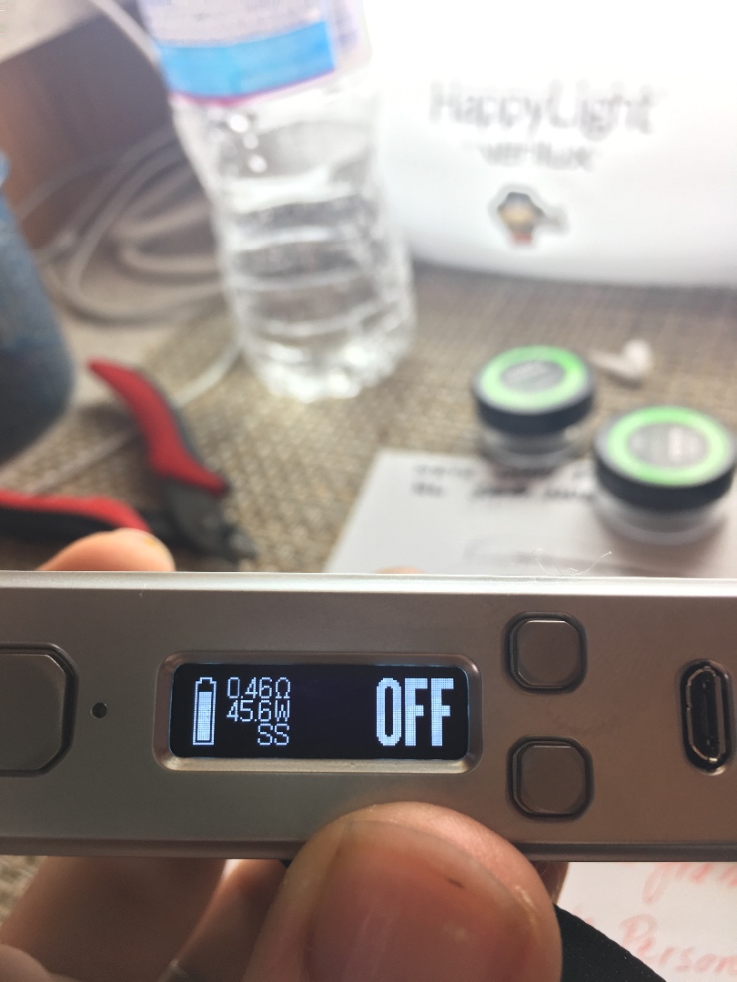

Hi I am new to the DNA. I have the Therion BF and so far I really love it, but have a question. When I change the wire type it will show ss316 and under that, the wire type. When I choose Kanthal and go back to vaping, the screen shows the ohms ----f and SS . The SS is what I am curious about. I have read and searched but have not found the answer. I have ever used escribe, and honestly don't even know how to set it up. I am going to send the Therion back, I bought it yesterday and the fire button sticks quite a bit. Seems dangerous. Sorry if this is a stupid question. I've been vaping for years but this one has me stumped. I have the Psyclone Hadaly on it and love it but, but recently im getting the check atomizer warning as well. This is my first Therion.

Hello. Yes I see now what I was doing wrong but I am still having issues. It seems like TC was working most of the time and now it's not. I've occasionally gotten the new cool question but not much anymore. I haven't tackled escribe yet because I don't know how to use it. I've been doing this for so many years and I feel like such a newbie now it's embarrassing. The wire I have is stainless Clapton wire from lightning babes I'm fortunately I don't know if it's 316 L or 403 or what. If I change the material and then I change the profile so that it says the material twice for example it doesn't say stainless steel on the top and titanium on the bottom I still don't got a temperature read and I'm not sure how to reset it so that it's a cold coil I'm not sure why am having such a hard time with this I read the documentation but it's super confusing to me I got I've been doing this for so long and this is just making me feel like an idiot.

Can't you just go check what type of wire? Either way, both are safe to use in plain ole wattage/power mode.
You should be more concerned about that sticking fire button, while still under LostVape's warranty. Good luck.

If it has 2 purple dots, then that indicates that the core & the wrap are both SS & according to the .csv file that is downloadable from their website for that wire, compared to the Steam Engine .csv...that is 316L
