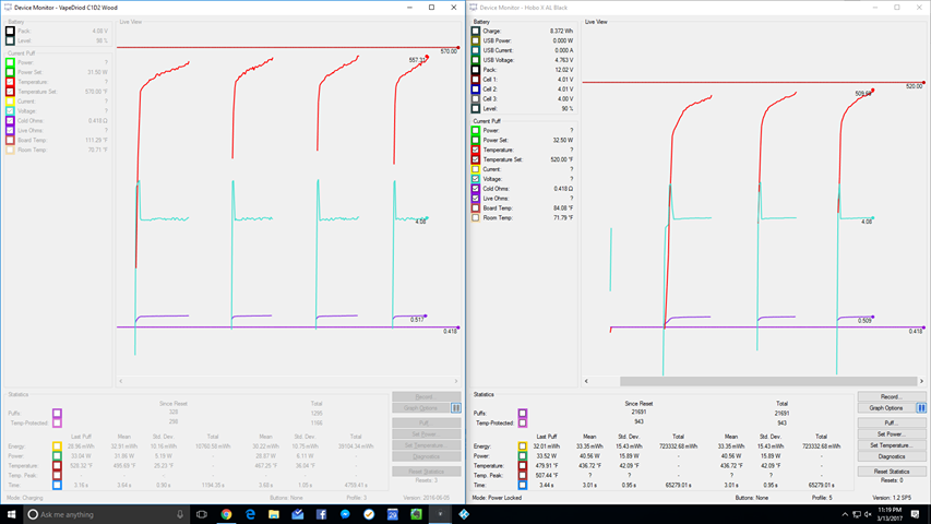

LeeWB3 Posted March 14, 2017 Author Report Posted March 14, 2017 I have a Hobo-X (actually, 3). I also have two VapeDroid C1D2s. The Hobo-Xs are at defaults and the C1D2s are calibrated for mod resistance and case numbers as closely as I can get them. I built a 5 wrap 28g/40gX2/40g SS Staggered Fused Clapton in a NarTA. The VapeDroid C1D2 and the Hobo-X are calibrated so both read it as EXACTLY 0.418 ohms cold. I have left them overnight on both devices several times and that's just what both give me. That took a 0.005 in mod resistance on the VapeDroid and a 0.004 on the Hobo-X (which is the Hobo's default). Both devices are using the exact same SS316L profile from Steam-Engine. Both are set at 50W pre-heat with 6.5 punch.With both set to a 520°F temp and a run wattage at 32.5W, the VapeDroid goes IMMEDIATELY to the 520°F while the Hobo-X never even reaches it. I dropped the wattage on the VapeDroid to 31.5W and raised the temp to 570 instead and graphed as shown in attached. Note that the C1D2 is on the left and the Hobo-X is on the right. Cold ohms were 0.418 for both during both runs..After dropping the wattage on the VapeDroid to the 31.5W instead of 32.5W, you can see that they are now applying the exact same Voltage and the curves actually start looking the same between the two - except the VapeDroid is reading 50 °F hotter because it's reading the warm ohms as 0.517 instead of 0.509. They vape the same setup this way.Is this simply unavoidable? I was big on getting the mods calibrated correctly, but this kinda implies that whole goal of correctly setting Mod Resistance so cold ohms read the same on every device doesn't necessarily actually end up in the same place because the ohms are changing more on the VapeDroid than they are on the Hobo-X. Only thing I can figure is the internal wiring and 510 of the VapeDroid at temp is adding 0.01 ohms that the Hobo-X isn't? I do see that the board temp of the VapeDroid is WAY higher than the Hobo-X.Should I just give it up and just set the VapeDroid at 570 °F and vape the darn thing? Kinda throws the "well, 470°F is good for fruits, 510°F is good for custards", etc. out the window. I'm kinda leaning toward setting up all variables on the Hobo-X (I trust them) for each atty and then installing on mod I want to use them on and adjusting temp until the curves look the same......

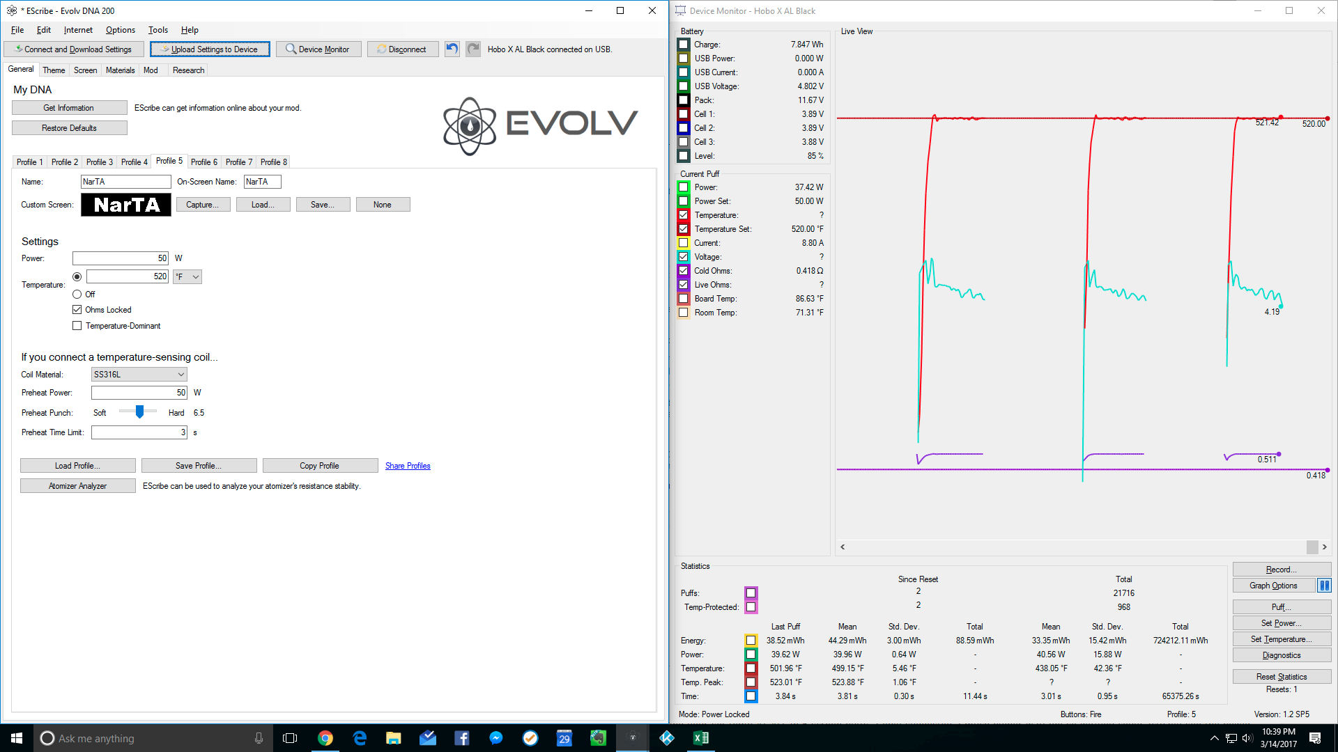

LeeWB3 Posted March 14, 2017 Author Report Posted March 14, 2017 A) As stated in the original post, the VapeDroid hits the 520°F set temperature immediately (in much less than a second) with the Pre-heat set at 50W and the run wattage set at 32.5W. I did not show that run because that doesn't illustrate the problem. As your edit surmised, the concern is basically mod calibration. Or more precisely mod calibration while firing.B) I realize it was a guess, but the specific single coil clapton (staggered 28g) doesn't need anywhere near 100W to reach temperature. Since you've asked for it, here is a Hobo run at 50W, which is plenty as you can see (note ohms were locked so I could switch back and forth between the two devices without it asking or accidentally changing to new, warm ohms). Do you need to see a run with the VapeDroid as well. I must admit I don't understand how it relates to what I'm asking but I could certainly provide. Basically it just hits faster and throttles more because it's misreading the ohms while under load. C) Not sure if you use SS much, but if you do I'm sure you know that 10 minutes is not NEARLY long enough for the coil to reach room temp in a clapton. Maybe you were more focused on the mod? I always let SS refine overnight before thinking I have a good ohm reading. Doing that for both they give 0.418 with the mod resistances I've set after 9 hours or so of cooling. The runs in the original post were done with cool mods other than the heat raised as I was firing them to get the runs (it took a couple to figure out how high to raise the temp on the VapeDroid to get it to run the same voltage without throttling.)D) All variables on the Escribe screen were given in the original post, but if it helps to see in one place, they were: Wattage: 32.5W, 520°F, 50W Pre-heat, 6.5 Punch, 3seconds. If you like it graphically, they are exactly as shown in the screen cap above, except wattage was 32.5W rather than the 50W I used to show it'll reach temp.D) To answer your edit, because this IS about calibration (more or less), as stated in the original post the Mod resistance of the VapeDroid was 0.005 and the Mod Resistance of the Hobo X was 0.004.E) If that answered your questions, perhaps restating the actual question would be helpful. The VapeDroid is calibrated cold to the same settings as the Hobo X. However, when the VapeDroid hits the same RTA/coil with the same voltage it shows a significantly higher (for SS) change in resistance. I chose to show voltage rather than the more common wattage because wattage depends upon a known ohms and that is what appears to be off. The higher change in resistance causes the VapeDroid to believe it is running significantly hotter than the Hobo X thinks it runs. Again, with identical settings.F) I am being told that the spring changing resistance in the VapeDroid 510 as it gets warm is most likely the culprit, but don't know what to do about it.
