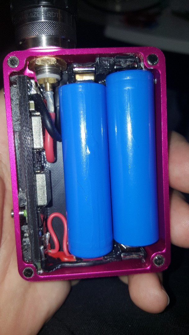

Asmodeus Posted March 19, 2017 Author Report Share Posted March 19, 2017 Ok. So there are days when I wish personal accountability wasn't an inherent counterbalance to my strong belief in personal freedom. Today is one of those days... I vaped some (new) LG HG2's down to where the car ride home had dropped the temps enough that I would touch into the check battery warning. These 20A batteries were essentially useless because around 3.8v (each) they were done-zo. I put them in the minikin v1.5 and screwed my atty on (.09 twice twisted 26g spaced). This is right around what it won't fire. No issues. Insert a long string of expletives. K. All done. I figured I'd Amazon prime up some parts and either way the DNA was coming apart... Now. Good thing my epoxy held to the anodized case - not at all. Lots of very gentle prying mm by mm and I snuck the battery tray out and began removing the contacts from it. And that's when I earned my (@ss) hat, which, I will now wear because of that infernal accountability thing... My pack bridge was... the cell tap. I went through the effort of stripping in the middle of the wire so it was exactly spaced perfectly on back side of the battery contacts, and the end perfectly soldered to the adjacent tab. And... must have been so satisfied with my cleanliness, I never actually bridged the contacts/pack with an appropriate gauge wire... So a small portion of a 22g wire resting neatly on the top side contacts was all that was letting current flow. So I'm dumb AF. Which, is usually the problem in life. Having trouble there little dude? Why yes, yes I am... It's cause you're stupid. Yes. Yes it is. After carefully balancing the tray on some tape I was able to put those same batteries back in and fire them in DM with barely any sag at all, and very little difference between them. After juicing the atty 2-3 times on the same batteries that gave me the issue before I started I declared victory, taped it back up and glued it back in with super glue. If I still have issues this tray is now almost destroyed and I will replace it. Image may not conform to the level of forum appropriateness, but it is appropriate for (me) this situation. Wearing the hat unless it genuinely bothers someone. Link to comment Share on other sites More sharing options...

JTree Posted March 19, 2017 Report Share Posted March 19, 2017 Asmodeus said:Ok. So there are days when I wish personal accountability wasn't an inherent counterbalance to my strong belief in personal freedom. Today is one of those days... I vaped some (new) LG HG2's down to where the car ride home had dropped the temps enough that I would touch into the check battery warning. These 20A batteries were essentially useless because around 3.8v (each) they were done-zo. I put them in the minikin v1.5 and screwed my atty on (.09 twice twisted 26g spaced). This is right around what it won't fire. No issues. Insert a long string of expletives. K. All done. I figured I'd Amazon prime up some parts and either way the DNA was coming apart... Now. Good thing my epoxy held to the anodized case - not at all. Lots of very gentle prying mm by mm and I snuck the battery tray out and began removing the contacts from it. And that's when I earned my (@ss) hat, which, I will now wear because of that infernal accountability thing... My pack bridge was... the cell tap. I went through the effort of stripping in the middle of the wire so it was exactly spaced perfectly on back side of the battery contacts, and the end perfectly soldered to the adjacent tab. And... must have been so satisfied with my cleanliness, I never actually bridged the contacts/pack with an appropriate gauge wire... So a small portion of a 22g wire resting neatly on the top side contacts was all that was letting current flow. So I'm dumb AF. Which, is usually the problem in life. Having trouble there little dude? Why yes, yes I am... It's cause you're stupid. Yes. Yes it is. After carefully balancing the tray on some tape I was able to put those same batteries back in and fire them in DM with barely any sag at all, and very little difference between them. After juicing the atty 2-3 times on the same batteries that gave me the issue before I started I declared victory, taped it back up and glued it back in with super glue. If I still have issues this tray is now almost destroyed and I will replace it. Image may not conform to the level of forum appropriateness, but it is appropriate for (me) this situation. Wearing the hat unless it genuinely bothers someone. Hey man, thanks for breaking the bill of that hat in. I'll be taking that from you now, as I've earned the wearing of it for a time. Ok, so this morning my build finally went nuclear and so I was of the same opinion. "I'may going in with a different, modified sled and I'm going to make this work." The battery monitor was oscillating between full and empty, and I was getting an intermittent "imbalanced" message. I started tearing stuff apart. Thankfully I never soldered the sled in (no real need to IMO, as it wants to sit right and battery swaps don'the make it move even a little). Lo and behold, as soon as I unmounted the board and pulled the sled out, the wire I had soldered from the positive to the balance tab broke right off....I had apparently gotten a little agressive when striping it and damaged most of the filaments in the core. Soldered in a new wire, screwed the board down, and my wife is back on track sacking down my juice supply. Link to comment Share on other sites More sharing options...

JTree Posted March 19, 2017 Report Share Posted March 19, 2017 You'll note that I over compensated with the new wire lol Link to comment Share on other sites More sharing options...
Asmodeus Posted March 19, 2017 Author Report Share Posted March 19, 2017 Which 510 is that? Fat daddy? I used a varitube V2 and I think it protrudes more into the enclosure. It is almost resting on my battery. I mean it is so so close. I want to do a pink or a green one. I was thinking of sanding off the anodizing in some places and using a chemical blackening agent to make it two tone. Glad you got yours figured out too. My magnets creeped out a hair as well. I used 5m epoxy. I let them sit hours and hours. Still have a teeny gap because of it. I wish there was a way to soften them up to get them out and back in. I'd really like to put the smallest film of RTV in the gap so that when the door is on and I'm dousing the atty under water it doesn't get in the door crack. Link to comment Share on other sites More sharing options...
JTree Posted March 19, 2017 Report Share Posted March 19, 2017 Yeah it's a fat daddy v4....I'd stay way from the v5s. The v4s are easy to work with. If you 2 tone yours let me know how it works out. I'very been considering playing around with home anodizing. Link to comment Share on other sites More sharing options...
JTree Posted March 19, 2017 Report Share Posted March 19, 2017 Also, I have no idea why my epoxy didn'the set completely after 10 hours, but I thought they were good, removed the clamps and they crept....argivating. i'm thinking about drilling tiny holes to eliminate the hydraulic effect next time. I used magnets on the reverse side of the door and those stayed in fine and hardened like they were suppose to. Link to comment Share on other sites More sharing options...
