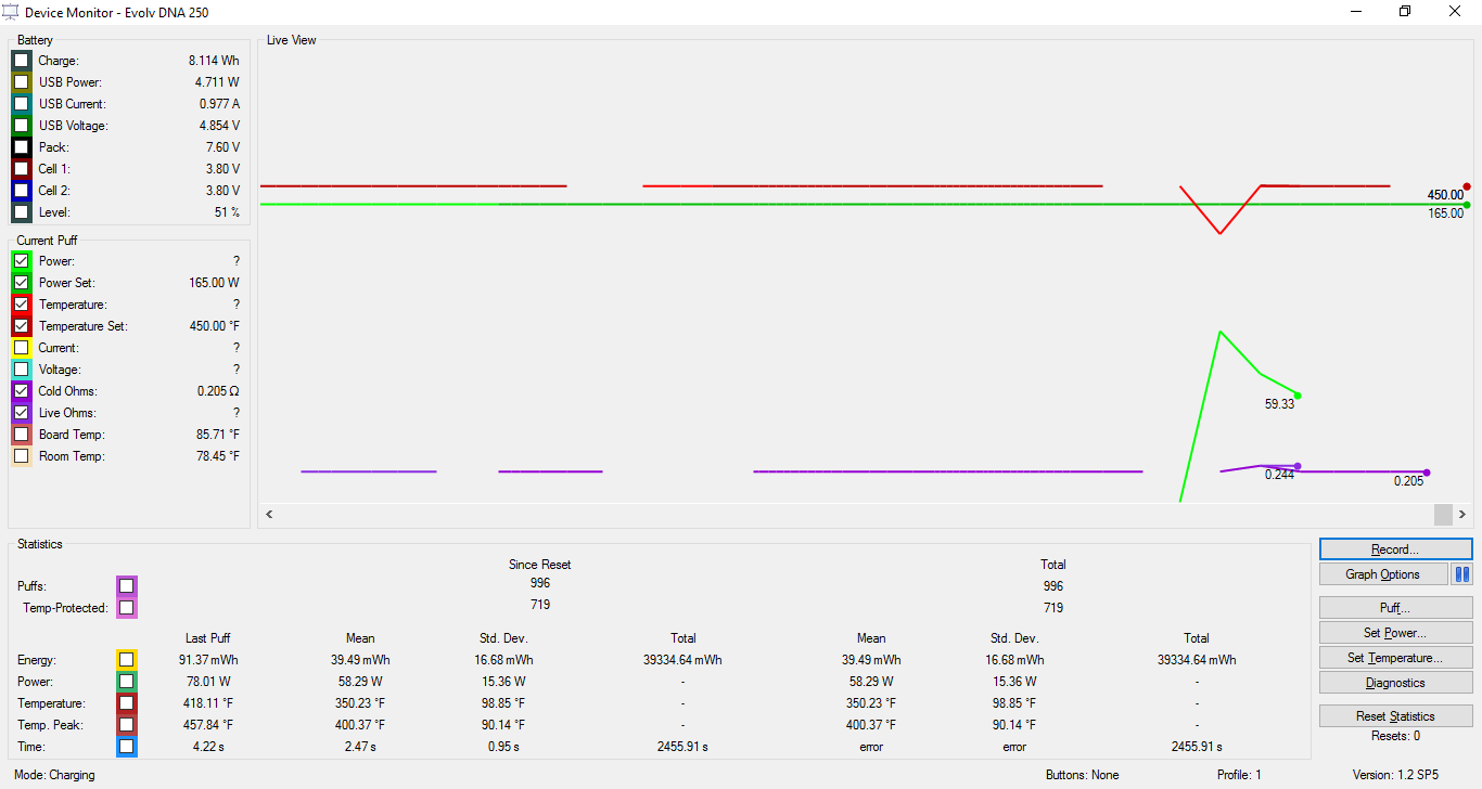

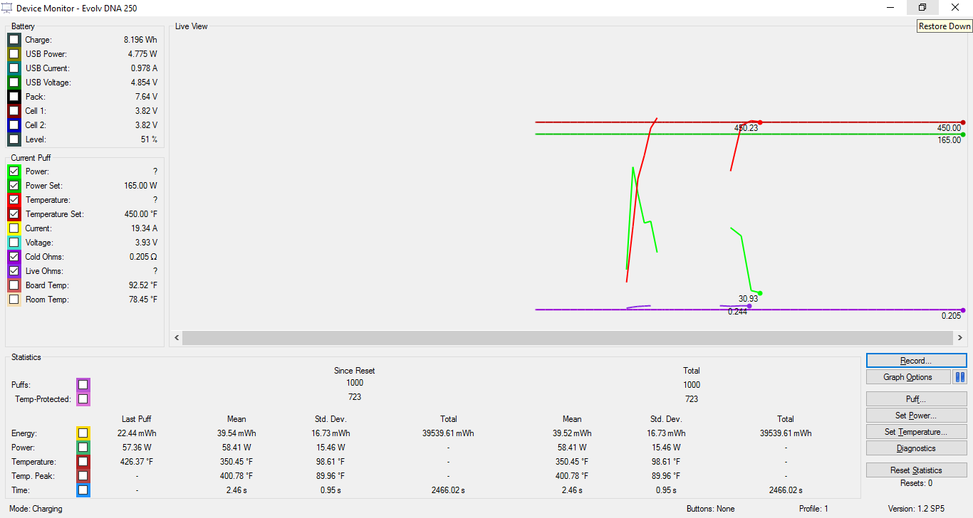

Wayneo Posted March 22, 2017 Report Share Posted March 22, 2017 @VapePanther do ya mind 1 last DM print screen for sh17s and giggles If you're getting nic'd out ... rest mod beside you ... bottom right hand corner .... puff for 4 second. Link to comment Share on other sites More sharing options...
VapePanther Posted March 22, 2017 Author Report Share Posted March 22, 2017 Sure Link to comment Share on other sites More sharing options...
Wayneo Posted March 22, 2017 Report Share Posted March 22, 2017 Alrighty then, so it looks like your coil needs somewhere around what your 'power' line shows (inverted green 'v') to maintain that temp. If that's sort of YOUR typical coil build, you can lower those maximums to more reasonable values. If you don't want as quick a ramp up, lower your punch slowly till you find your sweet spot. Once you set your 'thermal' calibration, it gets even more consistent Link to comment Share on other sites More sharing options...
VapePanther Posted March 22, 2017 Author Report Share Posted March 22, 2017 Wayneo said:Alrighty then, so it looks like your coil needs somewhere around what your 'power' line shows (inverted green 'v') to maintain that temp. If that's sort of YOUR typical coil build, you can lower those maximums to more reasonable values. If you don't want as quick a ramp up, lower your punch slowly till you find your sweet spot. Thanks for the tip. Link to comment Share on other sites More sharing options...

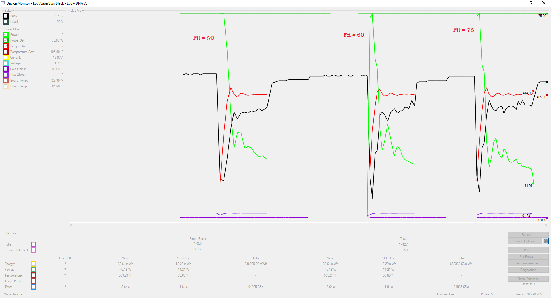

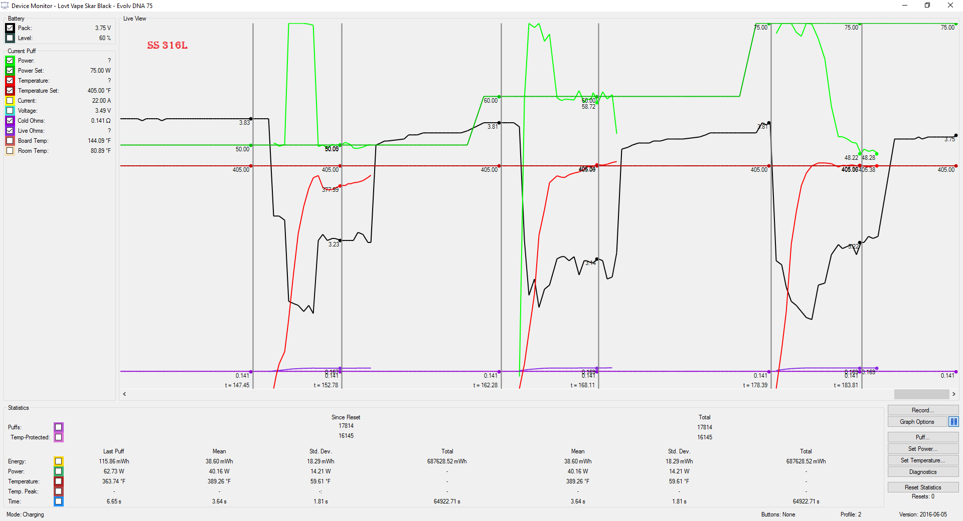

Spector NS5 RD Posted March 22, 2017 Report Share Posted March 22, 2017 just a side note, if your SET wattage is equal to or exceeds your preheat power setting, all of your preheat settings (power, time, punch) become ineffective. Link to comment Share on other sites More sharing options...
Wayneo Posted March 22, 2017 Report Share Posted March 22, 2017 Thanks man, I knew I forgot to mention that Link to comment Share on other sites More sharing options...

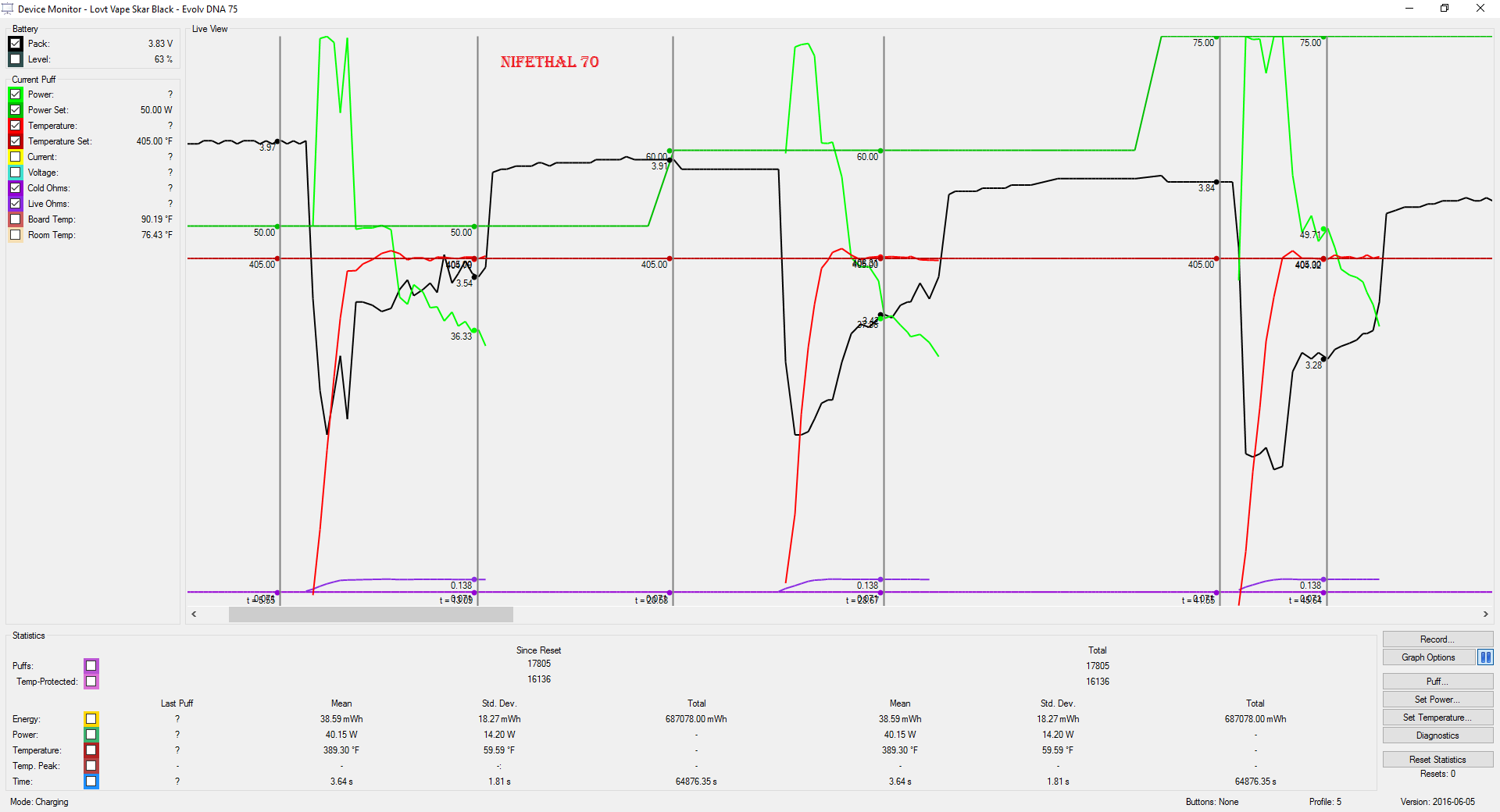

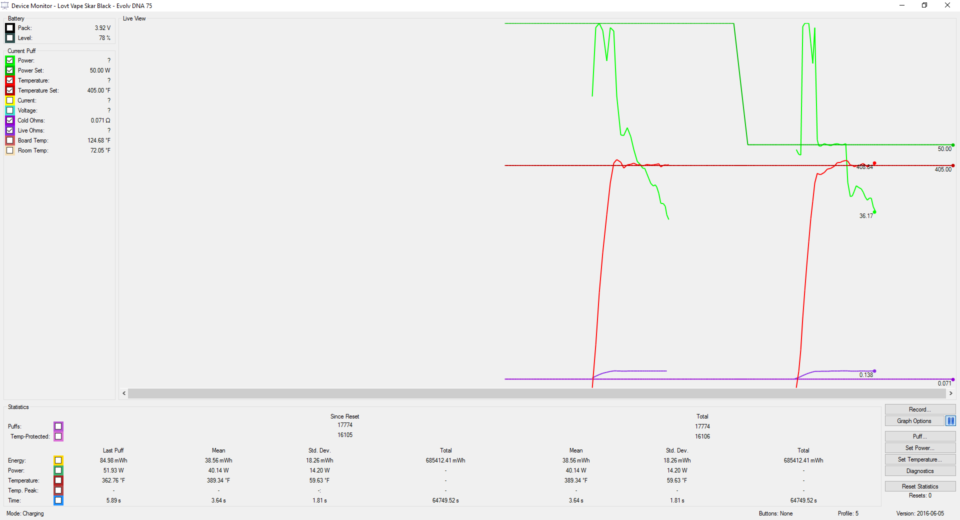

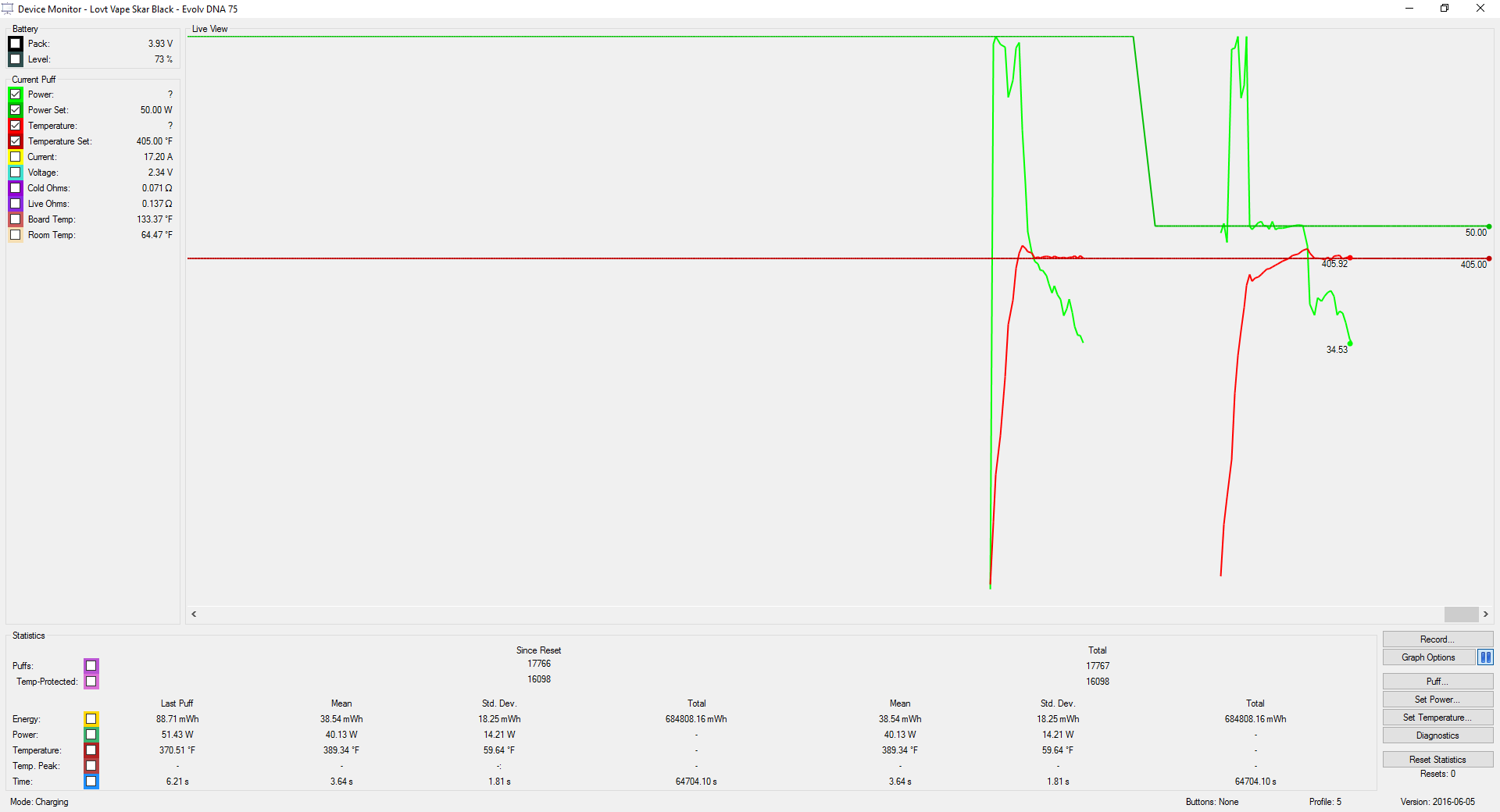

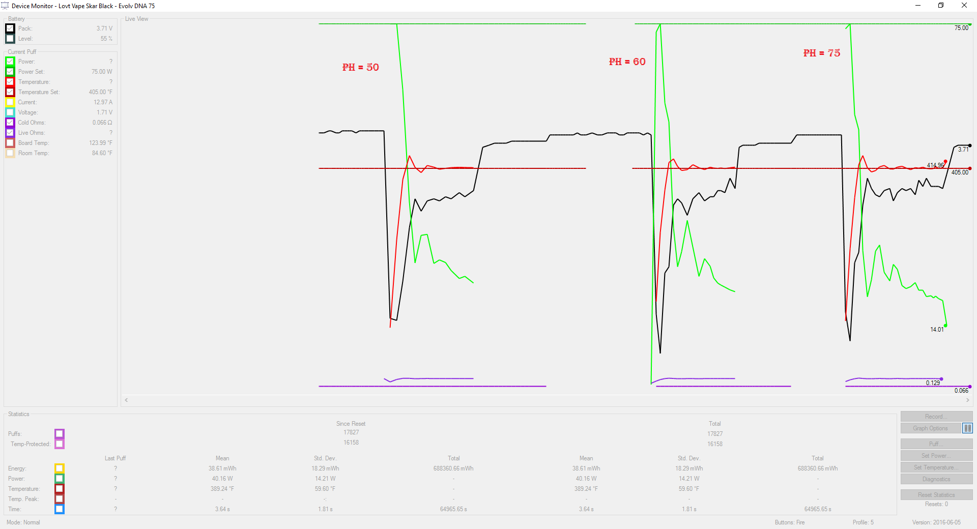

giz_60 Posted March 22, 2017 Report Share Posted March 22, 2017 ChunkyButt200 said:just a side note, if your SET wattage is equal to or exceeds your preheat power setting, all of your preheat settings (power, time, punch) become ineffective. That's probably true with 316L, but I have found that with Nifethal 70, which I use exclusively & which has a much lower resistivity than SS, if I lower the SET power below the preheat power, it takes slightly longer to reach temp. On the these screenshots, the preheat in all puffs is set at 75...but I could be missing something & it wouldn't be the first time... The last screenshot is changing the preheat power settings... CHANGING POWER (WATT) SETTING CHANGING PREHEAT POWER SETTING Link to comment Share on other sites More sharing options...
