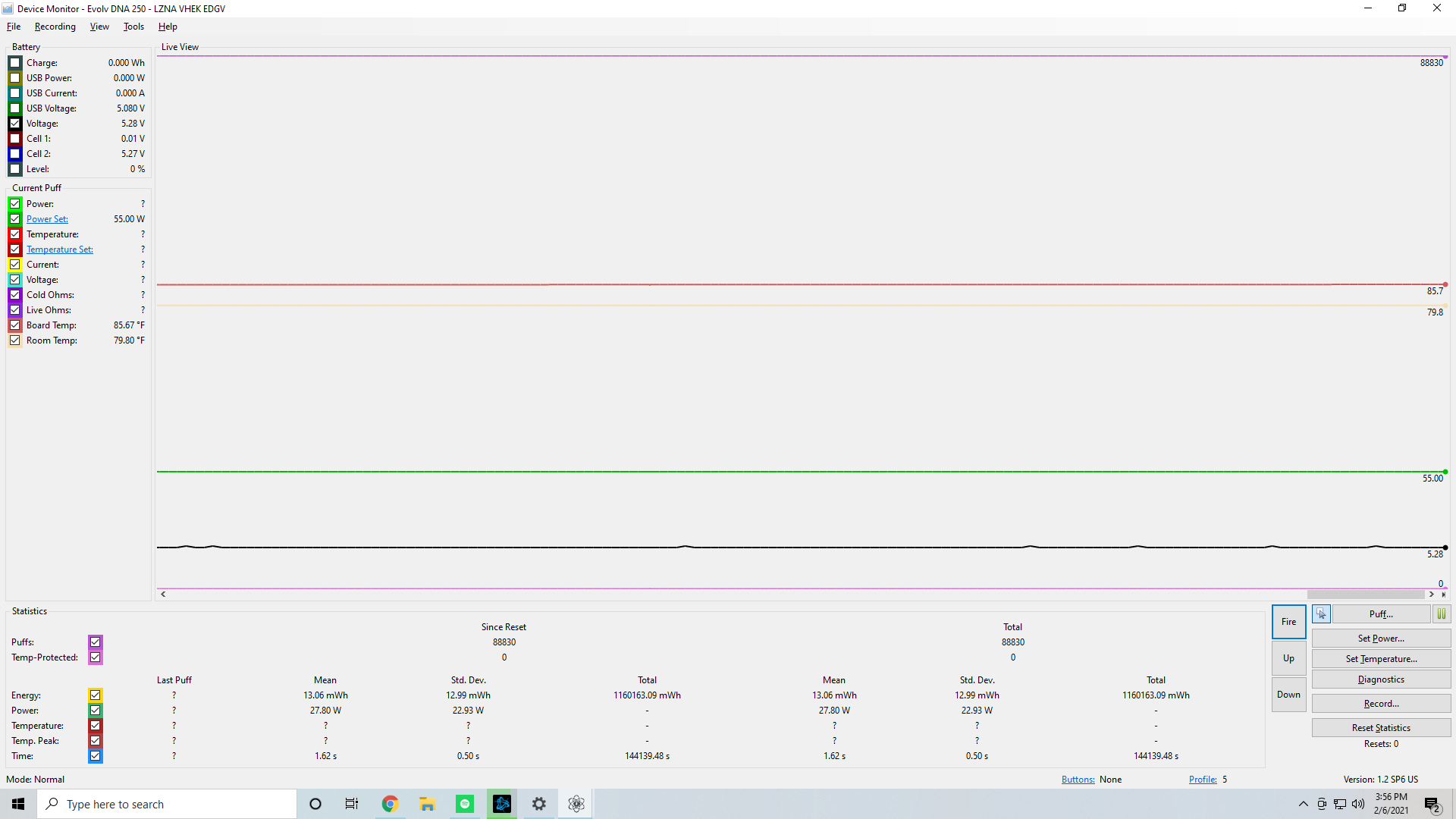

Guy Lamaison Posted February 6, 2021 Report Posted February 6, 2021 I've got the exact same problem where the screen comes on when I press the button but then shuts down again, when I have batteries in the mod and connect it to the PC it does stay on but then all the values on the screen are 0.00. in device monitor cell 1 says 0.01v but cell 2 says 5.28. seems like a battery balancing issues on the boards end as the batteries do work in other mods without any issues. The mod is a little older but I has worked fine up until 3 hours ago.
macarthurw484 Posted March 19, 2021 Report Posted March 19, 2021 В 06.02.2021 в 15:57, Guy Lamaison сказал: I've got the exact same problem where the screen comes on when I press the button but then shuts down again, when I have batteries in the mod and connect it to the PC it does stay on but then all the values on the screen are 0.00. in device monitor cell 1 says 0.01v but cell 2 says 5.28. seems like a battery balancing issues on the boards end as the batteries do work in other mods without any issues. I`m just want to work with worktime employee monitoring software.The mod is a little older but I has worked fine up until 3 hours ago. Did you find a solution?
Wayneo Posted March 19, 2021 Report Posted March 19, 2021 1 hour ago, macarthurw484 said: Did you find a solution? Can you post a full screenshot from 'Device Monitor'
