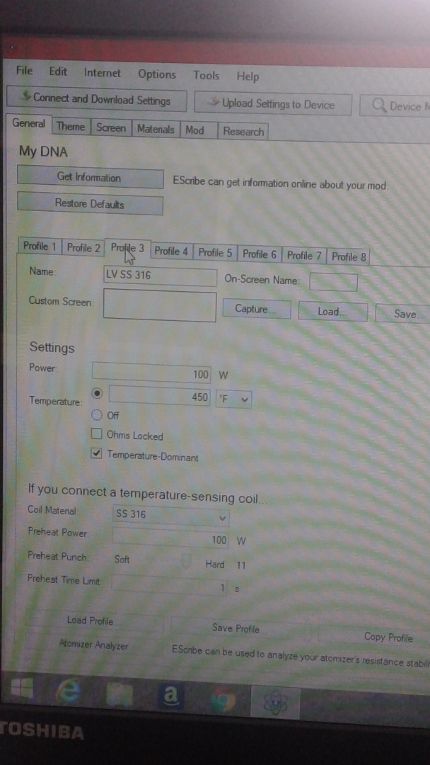

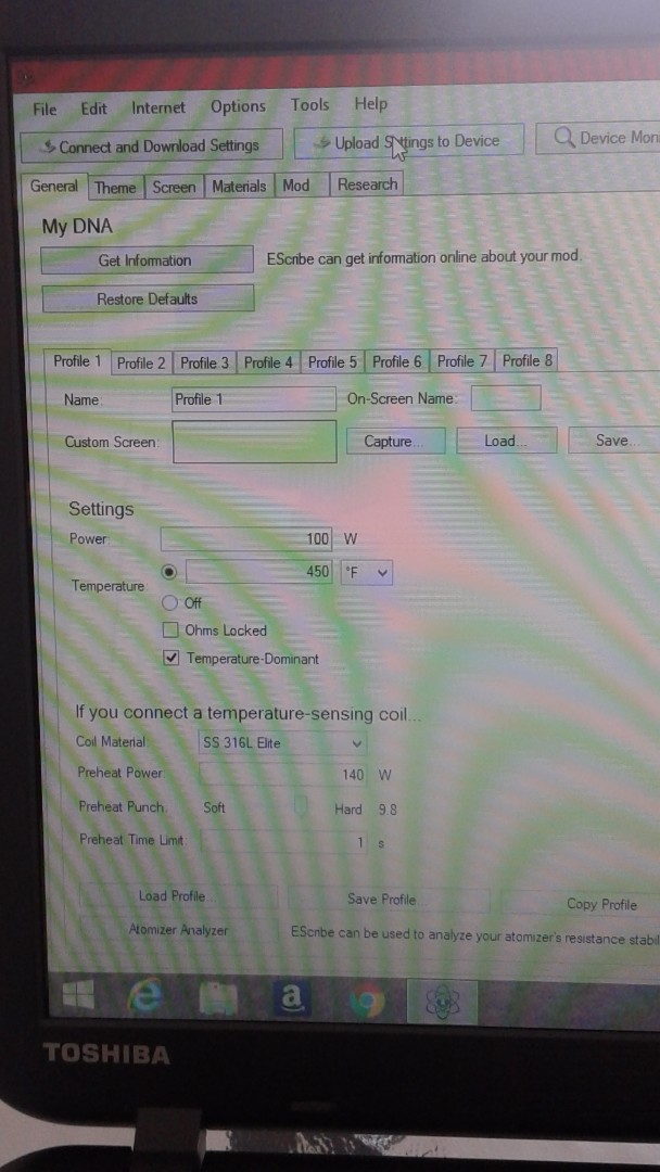

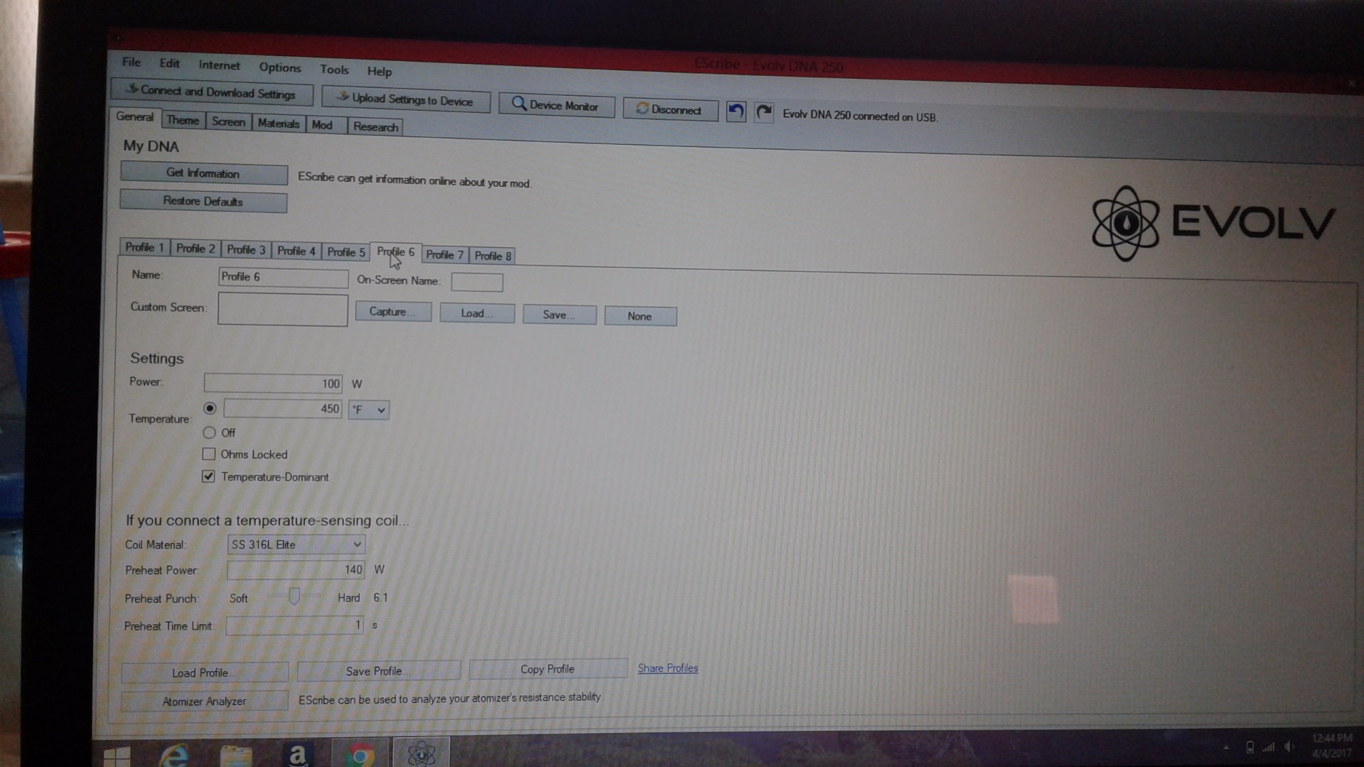

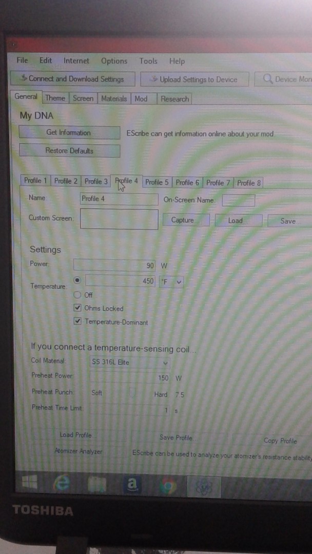

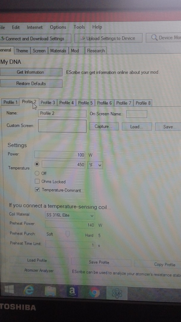

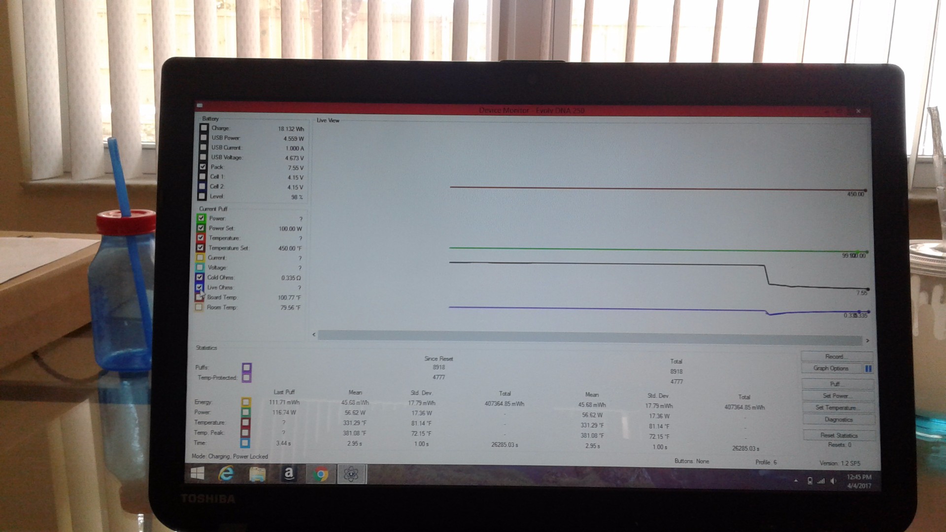

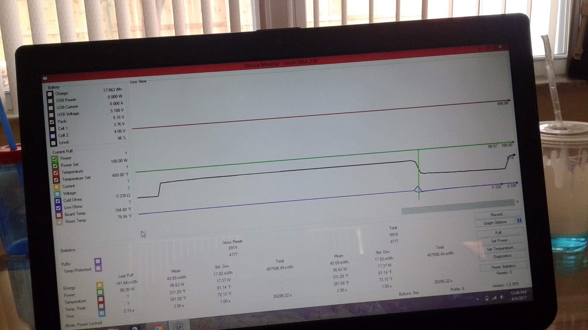

Can you post a couple of screenshots from Escribe...'Mod' tab & the device monitor while firing with the following boxes checked...power, power set, temperature, temperature set, cold ohms & live ohms...
Posted

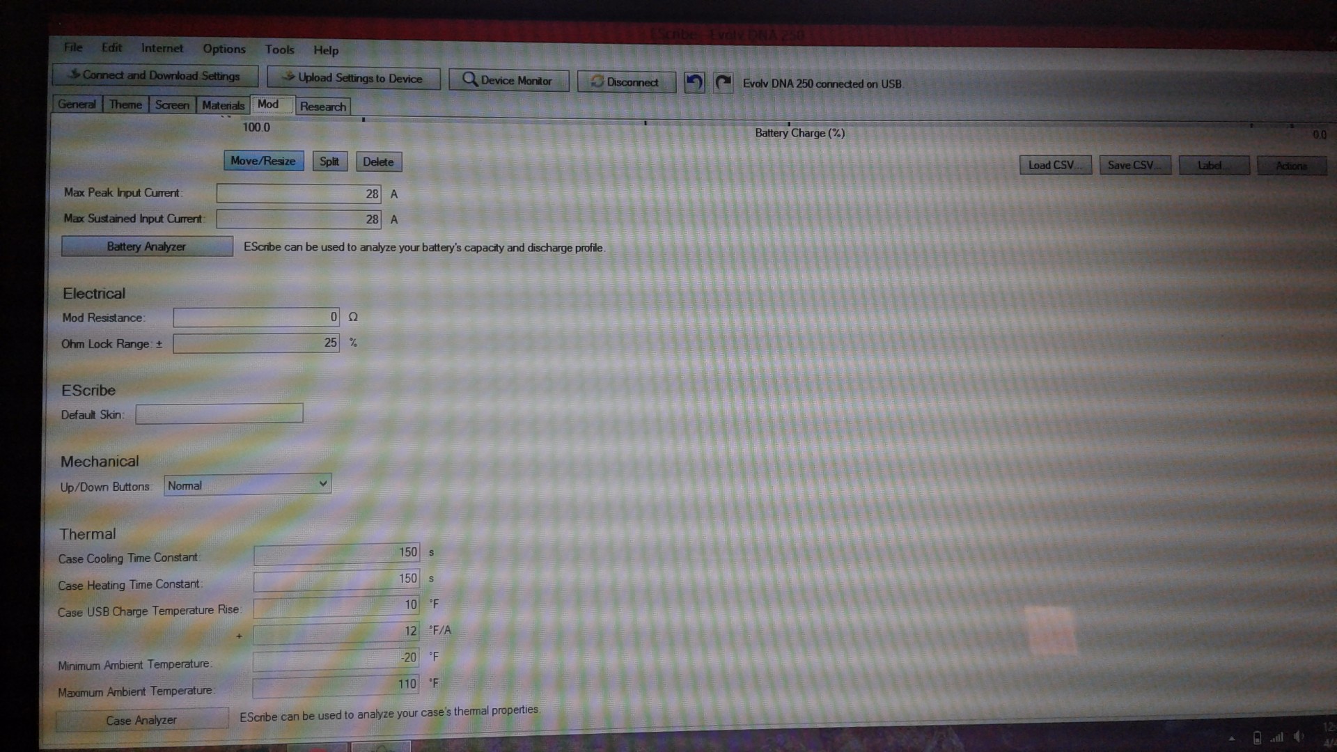

'Off' means the device is switching to Power mode...your resistance is not stable...first screen shot, .330...second screen shot. .335 & while firing, it should never drop as it is in both screen shots...make sure atty is cold before setting the cold ohms...need to check all connections...tight screws...clean 510 (atty & device)...Mod resistance needs to be checked & set...case analyzer needs to be run...the device HAS to be set up properly in order for TC to work...especially when using SS

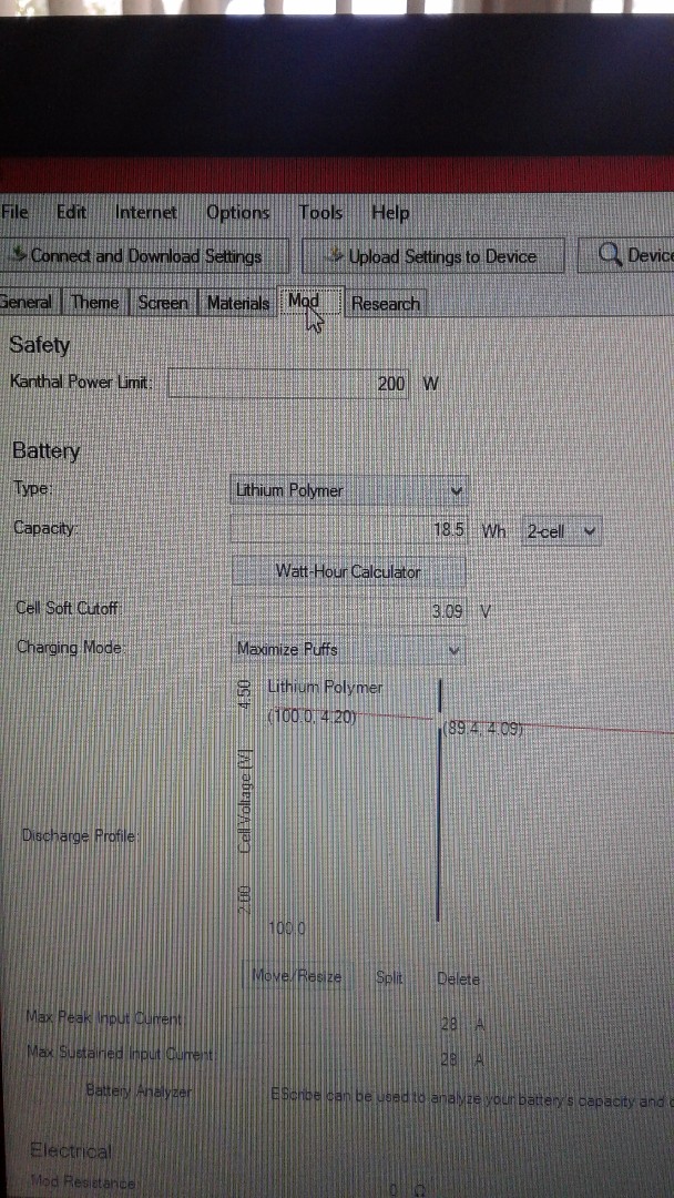

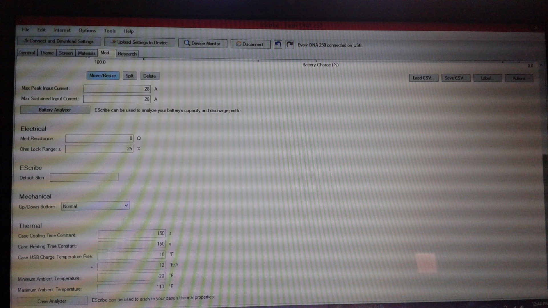

I've cleaned everything with rubbing alcohol. The screws on my goon 24 are as tight as I can get them. Mod resistance says zero? And unfortunately all the other stuff is like speaking Spanish to me. Lol. It just sucks, I like temp control, but wish I didn't get a dna. I didn't realize it was going to be this difficult. I need a cigarette after every time I mess with this thing....smh. kind of defeats the purpose.
Posted

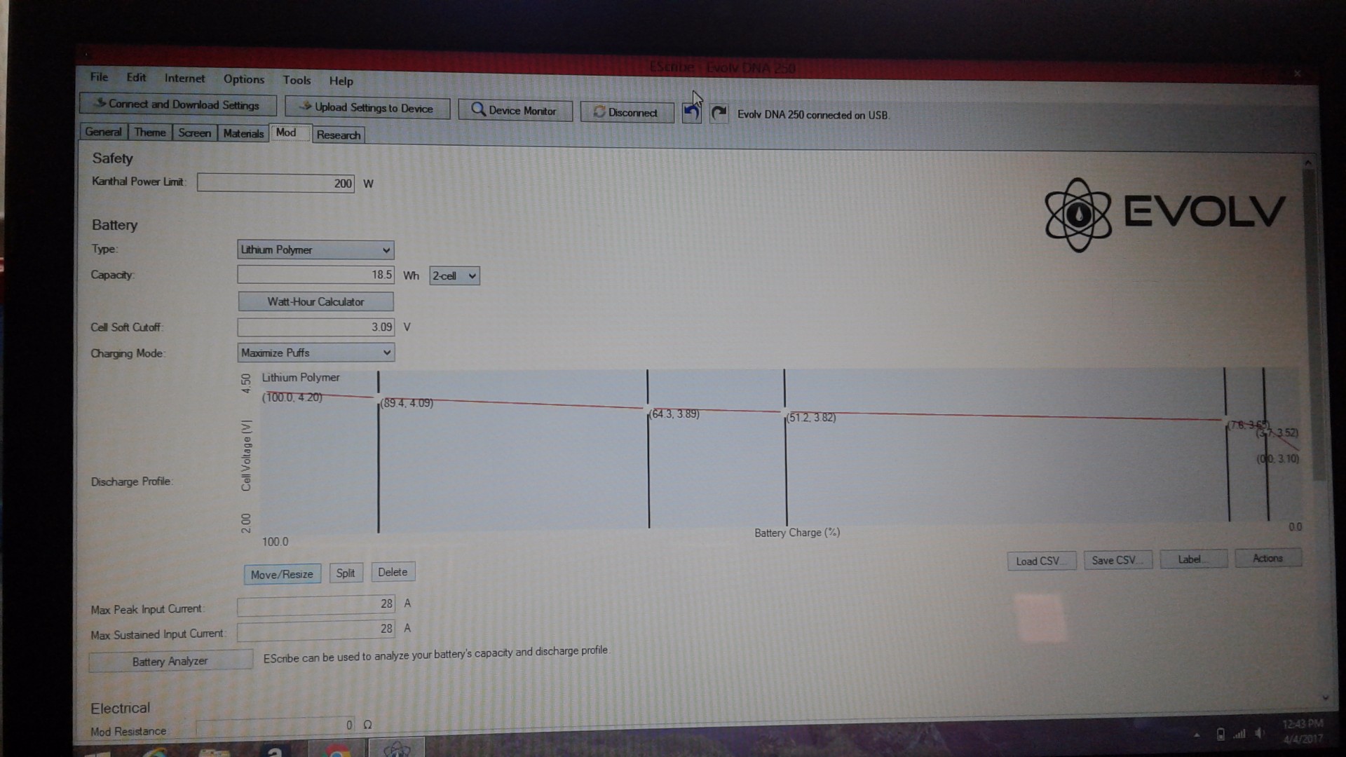

Cell soft cutoff 2.8, but thats not going to make any difference in the TC issue...Mod resistance setting in 'Mod' tab...read this thread starting at about post #72...https://forum.evolvapor.com/topic/65594-topic/
Case analyzer is at the bottom of the 'Mod' tab...just make sure your batteries are at least 50%..or less before running...
Edit: Unfortunately, the device manufacturer's don't set up all the variables to get a good TC vape, but once you have everything set up, it will work great...:thumb:

Oh, I know the battery stuff doesn't effect temp control. I just wanted to make sure my settings are correct. The first time I hooked my mod up to e scribe it seemed like a bunch of my settings got screwed up. Like it got changed to 3 cell. I didn't know if anything else got changed because I don't know what the settings are supposed to be. I can't seem to find anywhere to explain any of this in "English".
