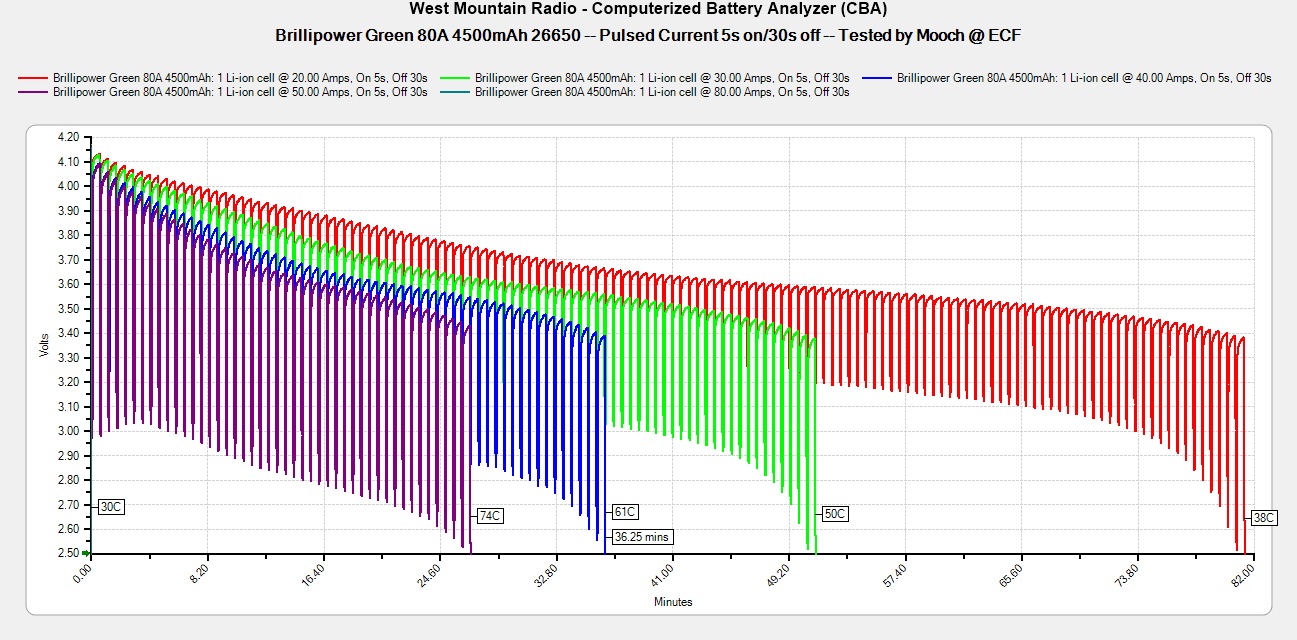

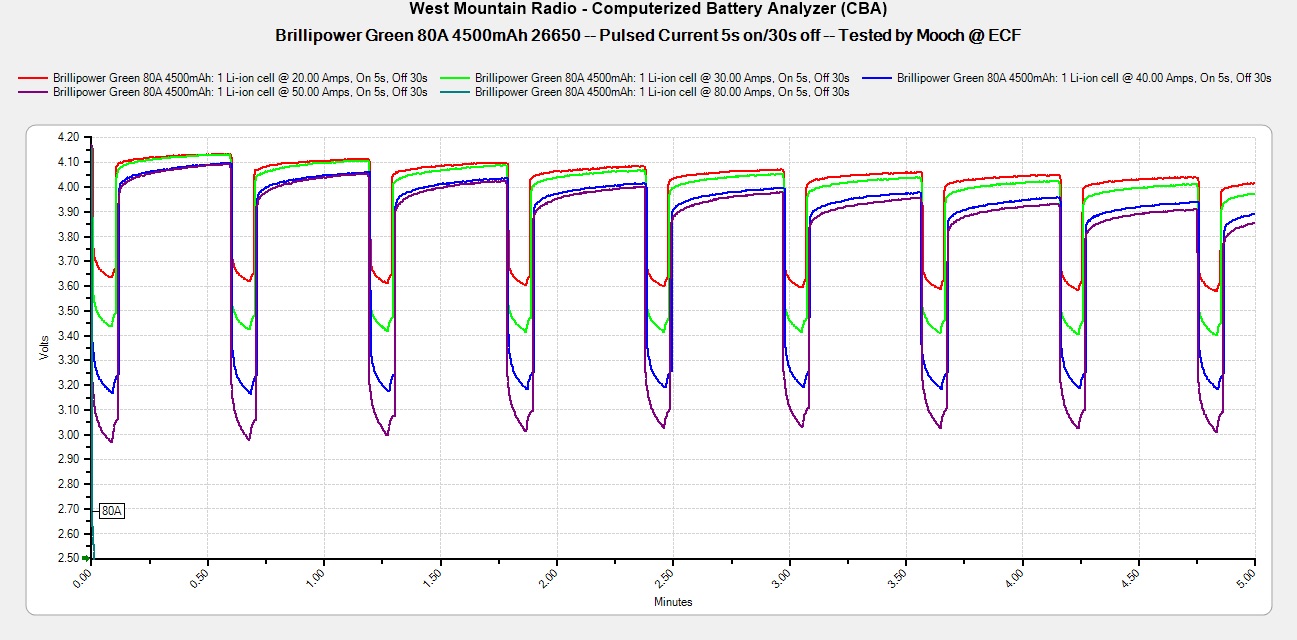

retird Posted March 24, 2017 Report Share Posted March 24, 2017 https://www.e-cigarette-forum.com/forum/threads/26650-battery-bench-test-results-and-new-ratings-table.725452/ Link to comment Share on other sites More sharing options...
IMPORTKILLR Posted March 27, 2017 Author Report Share Posted March 27, 2017 retird said:https://www.e-cigarette-forum.com/forum/threads/26650-battery-bench-test-results-and-new-ratings-table.725452/ I seen this before I bought the 26650 and from what I understood it rated in the top 5 rite next to the Basens 26650. I knew before reading this the 80 amp advertising was more than likely an exaggeration as most true cells are 30 amps. Thank you for the input! Link to comment Share on other sites More sharing options...
