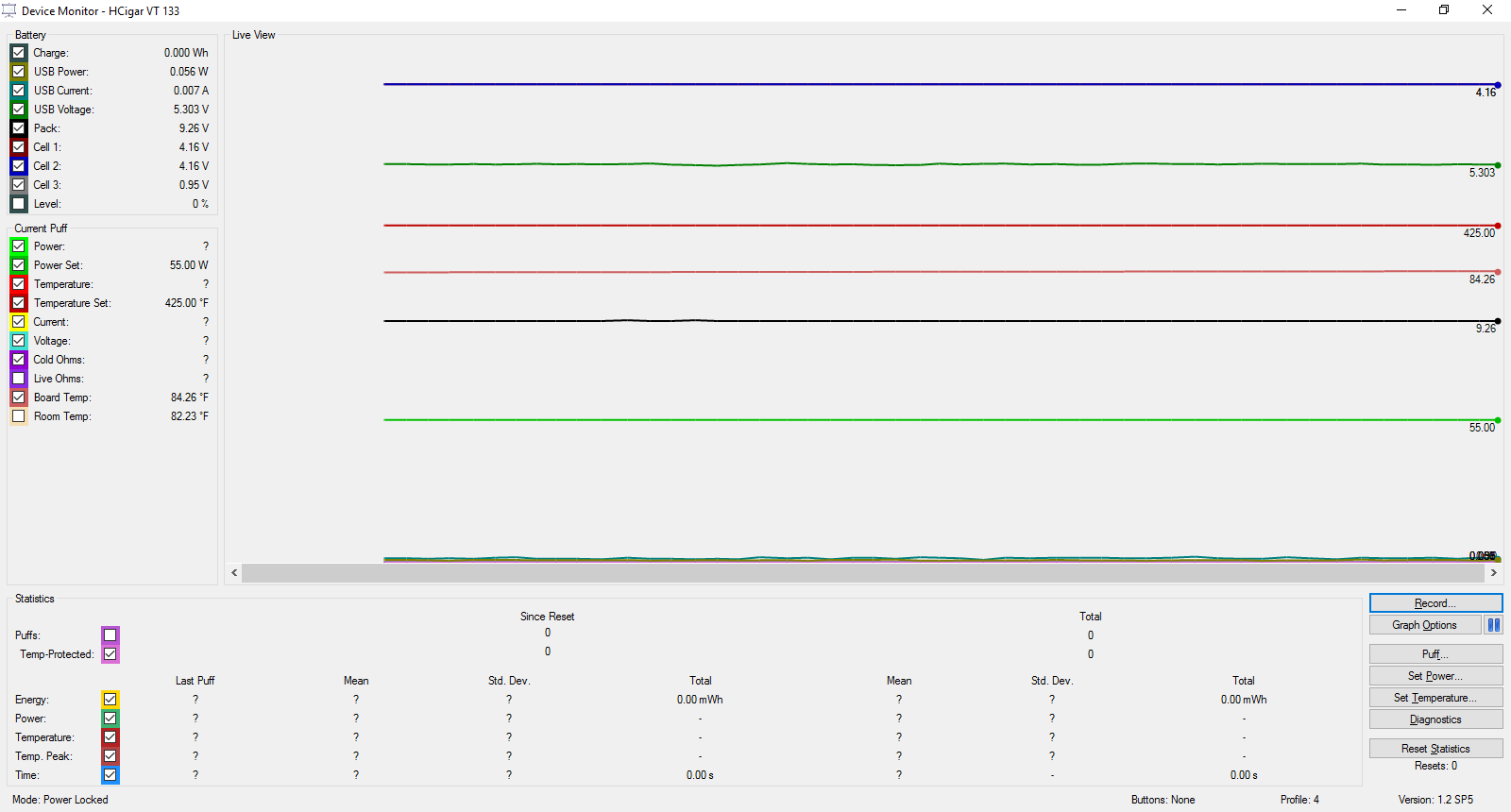

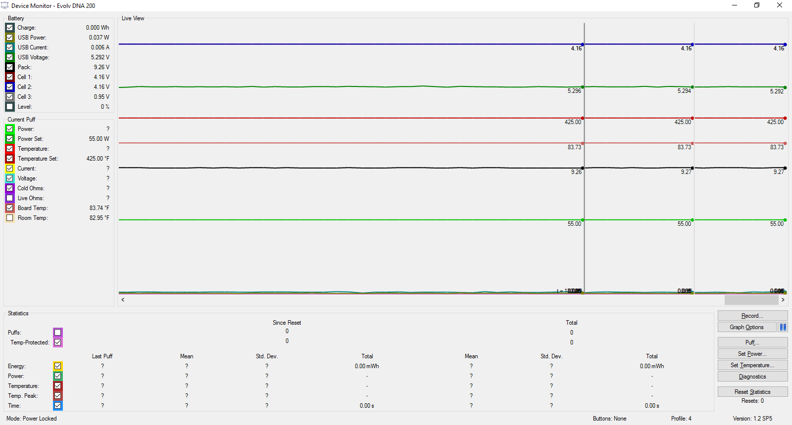

I'm not sure what that has to do with the problem. Even if you don't uncheck the 3rd cell on device monitor, it simply shouldn't show up, with 1.2 sp5. Also, it reads higher than the phantom cell that showed on device monitor, before 1.2 sp5 was released. So, it isn't normal, even if it were in 3 cell mode. Yes, it is the stock dna settings. I never attempted to customize. It won't start up, at all. Tethered to the usb, I get a screen that shows 0 ohms, and 0 battery. Otherwise, it's Evolv's stock opening screen, until you release the fire button. Then, nothing.
When you asked me to post the screen shots, did you have something in mind that you might be able to share with me?
What does the fact it fails to read ohms on an installed coil, and the 0 watt hours/0% battery showing on fully charged Samsung 30Q's tell you about the problem? Is it a hardware issue, other than the chip? That's what it seems like, to me. I was told that they simply had to realign the chip. But, this one doesn't have my settings on it. It's stock settings. I checked the serial number. And it's new. So, is it a bad chip?

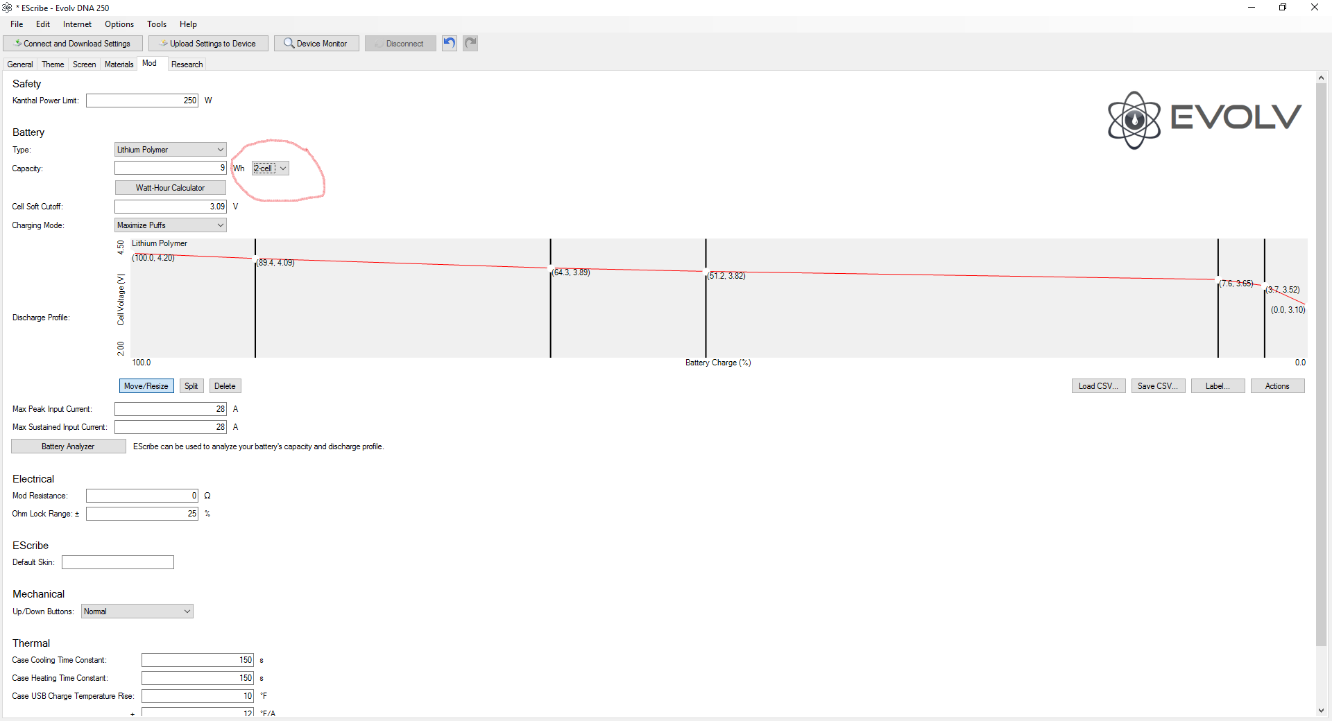

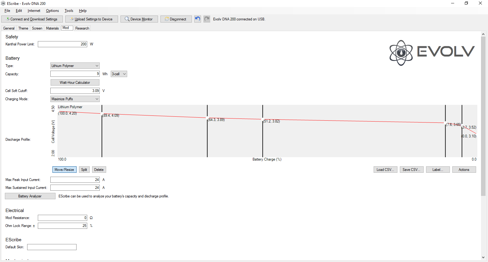

As giz_60 posted you need to install the .ecig file he posted for you... If you look on the Mod Tab you gave a screenshot of it shows 3 cells selected.  You have the Evolv Default .ecig file loaded which is for a DNA200 in your device and you should have the VT133 .ecig file installed which is 2 cells and 133 watt max...

It does matter...when it is set for 3 cells, that's telling the Mod there should be 3 cells & when the mod doesn't see the proper voltage for the 3rd cell, it won't work properly. We see this a lot when people inadvertently hit the 'Restore Defaults' in Escribe on a 133 or 166 device & it loads the Evolv defaults, which is for the 200 or 250...
Edit: Just changing it from 3 cells to 2 cells would probably make it work, but why not get the factory file loaded, then you will be back to out of the box state...even with the VT133 welcome screen...

I installed it. As I suspected, it changed nothing. The 3rd cell should not be showing, at all. Yet, there it is. It has an abnormally high reading, for a phantom cell. What about the 0 charge/watt hours, and 0 battery level on two fully charged 30Q's? What does that tell you? Is it another bad board, or did the tech break the mod, itself?
