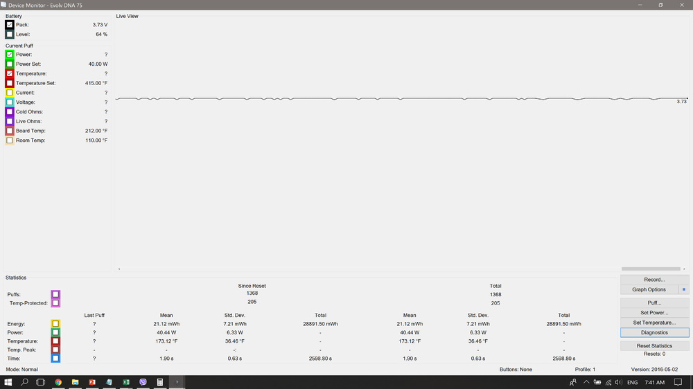

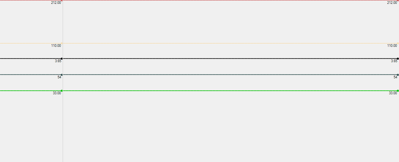

Spector NS5 RD Posted March 13, 2017 Report Posted March 13, 2017 hi Scott. can you post a screenshot of Device monitor with the "board and room temperature" boxes ticked. you might try and re-flash the current firmware you're using.
Scott Novosel Posted March 13, 2017 Author Report Posted March 13, 2017 it is reading 110 room temp...how do I reflash?thanks for reply

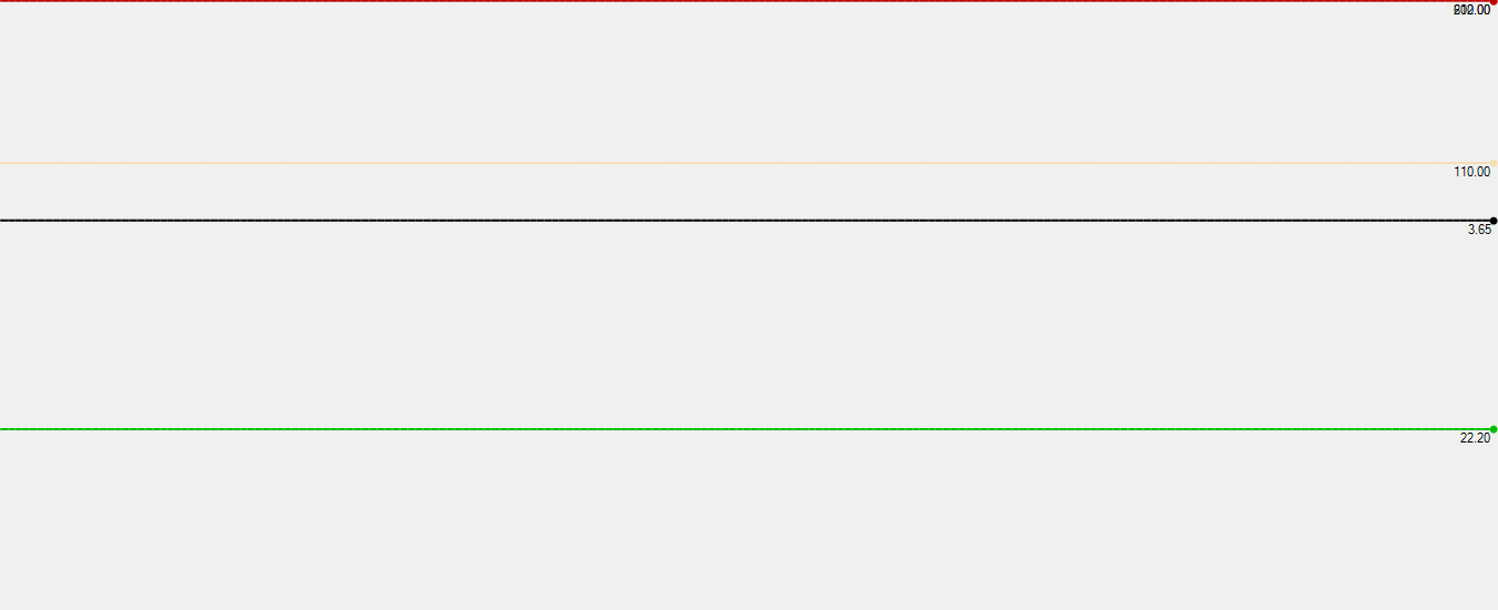

Spector NS5 RD Posted March 13, 2017 Report Posted March 13, 2017 i'm actually more interested in board temp while sitting idle. with your DNA 75 connected, in EScribe's top left hand corner "TOOLS" - "APPLY SERVICE PACK" - open the DNA 75 service pack list - select the current firmware you are running on your DNA 75. it will reinstall the FW. this may or may not fix it. most likely not but worth a shot.
Scott Novosel Posted March 13, 2017 Author Report Posted March 13, 2017 it is off the charts gibberish....
Scott Novosel Posted March 13, 2017 Author Report Posted March 13, 2017 I did the service pack update...seems to not have helped. Still get too hot when pressing fire button

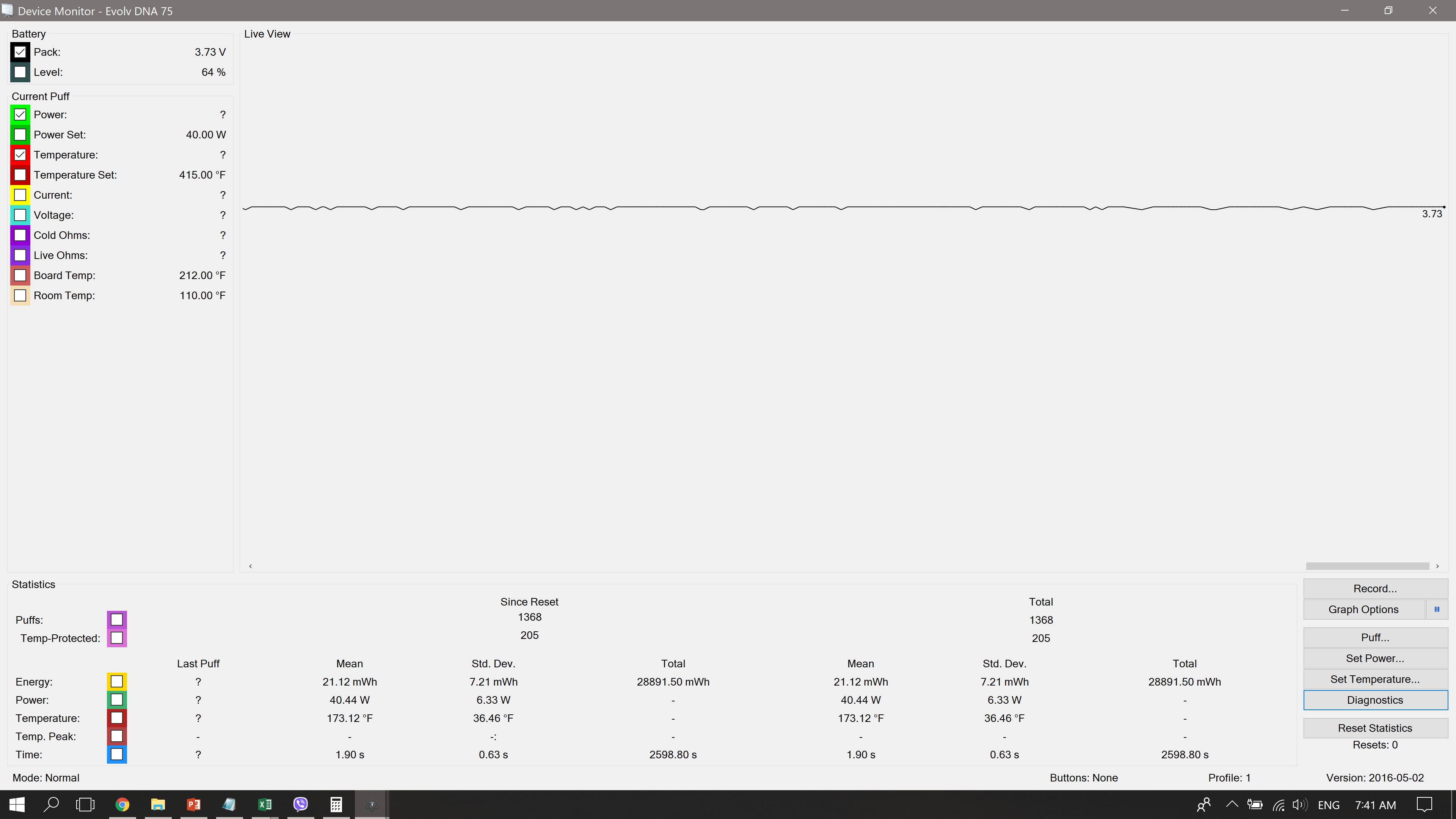

Wayneo Posted March 13, 2017 Report Posted March 13, 2017 A full print screen. All the information is valuable
Scott Novosel Posted March 13, 2017 Author Report Posted March 13, 2017 It does not include statistics in screen shot for whatever reason if that's what you mean. I click the screenshot button and that's what it gives me
Spector NS5 RD Posted March 13, 2017 Report Posted March 13, 2017 yep, sorry Scott, one of the board's on-board temp sensors has failed. is mod ridiculously hot to the touch? either way the board needs to be replaced. is the warranty from the vendor you purchased the mod from still good? if not, evolv warranties the board for 1 year from the date of purchase. i would contact Volcano first and if they don't help you, contact evolv and open a help ticket. link is my sig.edit... you get ejuice inside the mod? that could be affecting the sensor.
