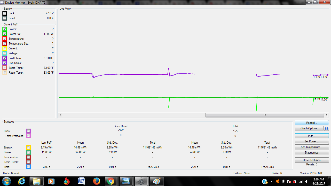

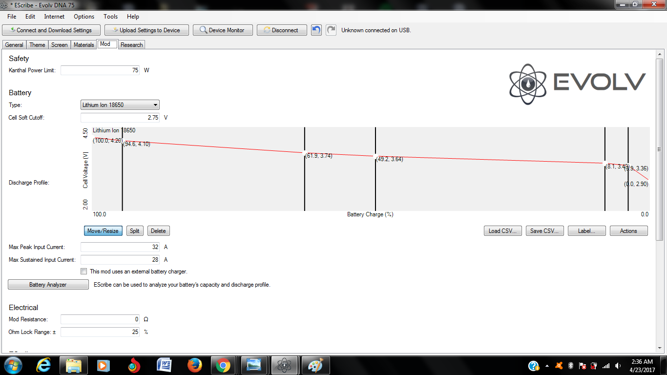

giz_60 Posted April 22, 2017 Report Posted April 22, 2017 What kind of atomizer/coil are you using? Can you post a screenshot of the 'Mod' tab in Escribe & one of the 'Device Monitor' while firing with the following checked...Power, Power Set, Temperature, Temperature Set, Cold Ohms, Live Ohms...

retird Posted April 22, 2017 Report Posted April 22, 2017 Do you mean the ohm's reading shown on the device changes as you vape and then changes back as the coil cools? It is reading live ohm's which is normal. A large variance may mean a loose or poor coil connection, poor connection at the atty connector, or a wiring issue in the device such as a poor ground. The screenshot you posted look pretty good as far as the cold and live ohms being vaped in Power Mode.....

retird Posted April 22, 2017 Report Posted April 22, 2017 So I guess you start using a new coil by making the coil and with both the device and atty at room temperature you identify the coil as a new coil. You vape and vape and at some point with the device resting it will "refine" since you haven't locked the ohm's. After refinement, with everything tight with good connection, you should not have wild swings of the ohms. If you switch atty's and the device and atty are not both at room temperature (or saying they both are not at the same temperature) then as it is vaped and refinement takes place the ohms variance will be greater. Without knowing the exact process you are using while getting the wide ohms swing that's the thoughts I have.... If we had a single screenshot of Device Monitor showing the wide variance while vaping it would be helpful. You could, if you want and have the skill and the proper meters, and the device is not in warranty, you could open the device and check the connections, grounding, 510 connector, and etc. Opening a device mostly voids a device warranty.
