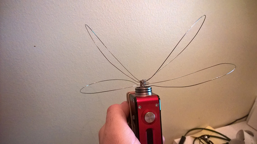

bingbling Posted September 30, 2015 Author Report Posted September 30, 2015 Right, so I don't have access to those kinda testbeds john is talking about. The thread you linked suggests air cooled coils, so quad coils with 24gauge should be able to handle the heat from 50watts.Something like this? They should barely get warm, if at all. What do you think about that?
Mad Scientist Posted September 30, 2015 Report Posted September 30, 2015 bingbling said:Right, so I don't have access to those kinda testbeds john is talking about. The thread you linked suggests air cooled coils, so quad coils with 24gauge should be able to handle the heat from 50watts.Something like this? They should barely get warm, if at all. What do you think about that?If you just use a big circular loop of thick wire in free air, it doesn't get that hot. Making a coil reduces cooling efficiency and allows heat transfer from loop to loop. If you have 24, try twisting 3 or 4 strands (what will fit in your atty) into one large circular loop.

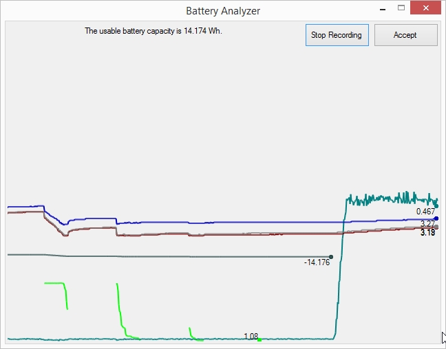

FiB3R Posted October 2, 2015 Report Posted October 2, 2015 Time to be surprised, Popeye. 14.17 x 1000 / 11.1 = 1276.5765765765771276 mAh, right?
FiB3R Posted October 2, 2015 Report Posted October 2, 2015 I recorded a couple of log files while doing this.One while it still needed charging first, and was going to take too long at 0.5AAnd a second one where it was almost ready to rock, and just needed a little extra before beginning the test.Anyway, my question is, how do you correctly read the time stamps? It seems messed up to me.http://ge.tt/9QpfT7P2
