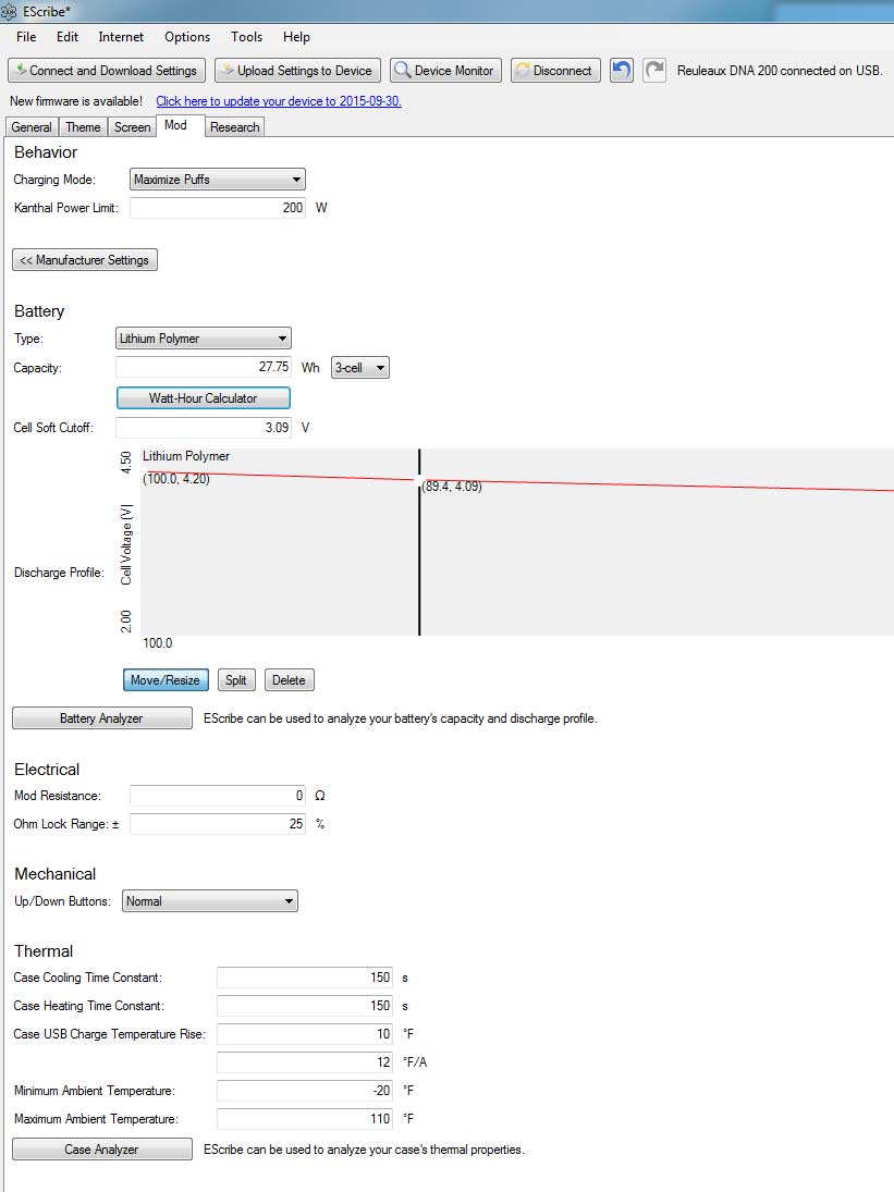

Jaquith Posted November 18, 2015 Report Posted November 18, 2015 To all, Reuleaux just posted their 'official' standardized settings http://www.wismec.com/product/reuleaux-dna200NOTE: It will completely erase all of your settings if you Upload to device. If your Mod is setup how you like it then I'd probably use these settings plus the appropriate Battery Analyzer settings; theirs is some generic 3x18650's. At the minimum I would back yours up: File / Save .. name it.Official Battery and Case Analyzer numbers:

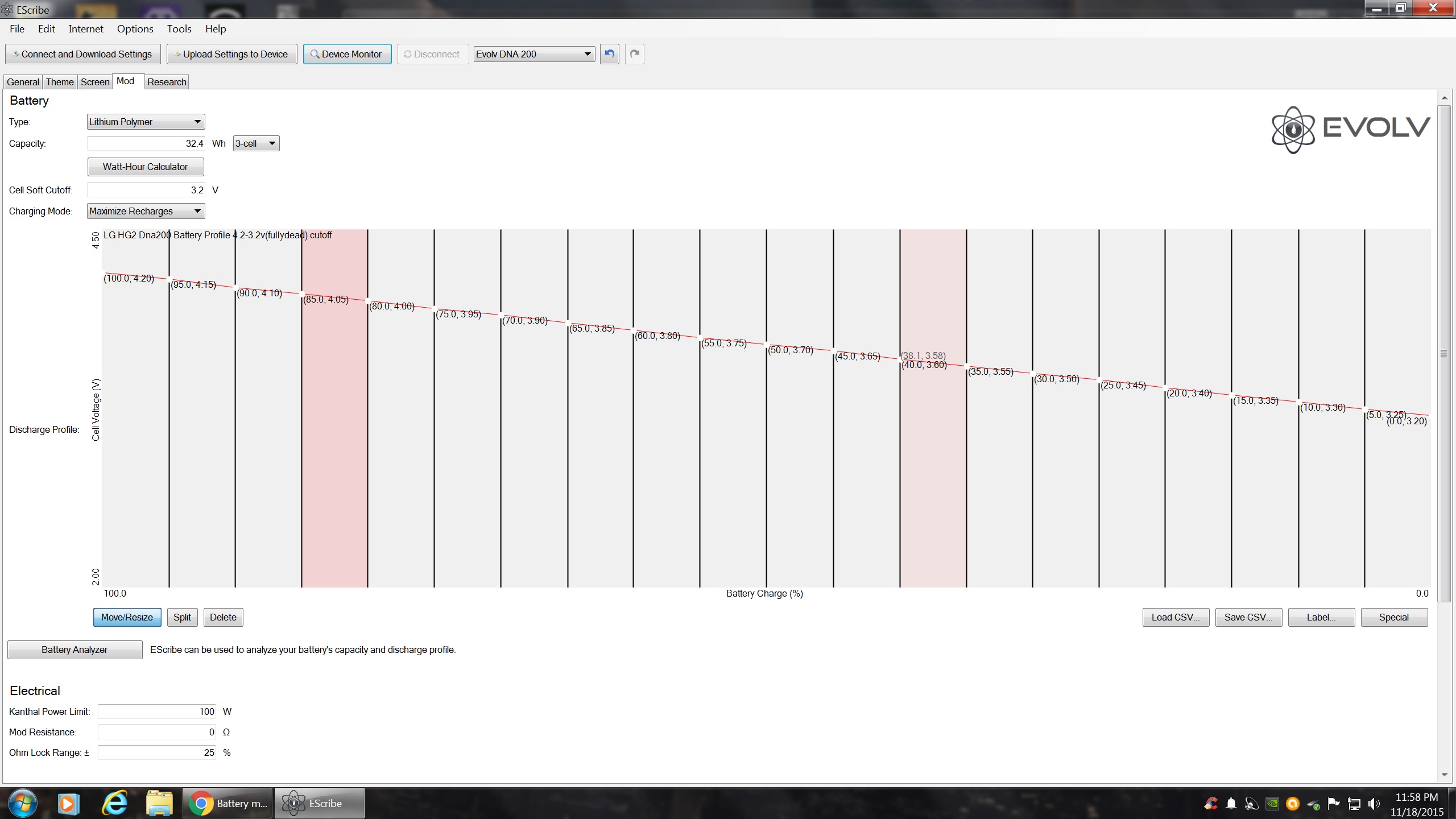

WickedTLC Posted November 19, 2015 Report Posted November 19, 2015 Under Mod section for LG HG2 battery users, use Watt-Hour Calculator, I just input 3000mah and 10.8v(3.6 times 3). It will come out to be 32.4wh. I've also selected Charging Mode into Maximize Recharges. For discharge profile and more accurate reading of battery life display I've posted a picture.100% - 4.2v95% - 4.15v90% - 4.10v85% - 4.05v80% - 4.00v75% - 3.95v70% - 3.90v65% - 3.85v60% - 3.80v55% - 3.75v50% - 3.70v45% - 3.65v40% - 3.60v35% - 3.55v30% - 3.50v25% - 3.45v20% - 3.40v15% - 3.35v10% - 3.30v5% - 3.25v0% - 3.20vI've set Cell Soft Cutoff to 3.2v. With this discharge profile my battery goes down by 1 tiny little square boxes at a time on the Wismec Reuleaux display, and if I wanted to or choose to recharge them at the safest volt 3.5-3.6 for max battery life cycle, I would take them out around 1/3 of battery life being displayed. With this, I would have a choice to know when its going to hit under 3.5v and that I am making a small sacrifice in in terms of max life cycle of my LG HG2 battery.Please correct me if i've made an mistake with this set up. Thank you guys. 1
