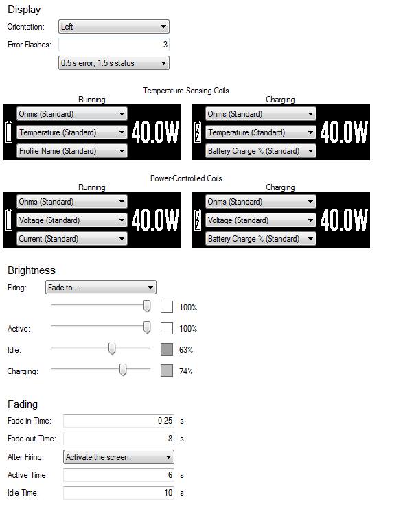

helloimage Posted September 9, 2016 Author Report Posted September 9, 2016 Howdy! Hope someone can assist. I'm having issues with my DNA75 not ever "sleeping."settings are as follows.After 10 seconds, my dna75 goes into the charging screen (not connected to USB and no bolt through the batt.)Although, the bolt is present and my display switches to the 'charging' profile when I plug the device to a power supply. All that works. My issue: It will never 'sleep.'There are two main screens (From screen tab in escribe): 1. While Running 2. While chargingI'm getting the 'While Charging' screen after firing and idle times! And the mod never sleeps.- I understand the device doesn't ever power down - I have no USB cable connected - I have hard/soft reset - I have re-flashed 05 and 06 firmware versions - used escribe deployed with DNA75s and the latest 1.2 - reset default profile, loaded various othersFrom the above screen shot of the 'screen settings: 1. Mod fires (Brightness=100) 2. at t=6 goes idle (Brightness=63) 3. at t=10 it should sleep.......But it doesn't. ---------it goes to the 'while charging' display (Brightness=74) and NEVER sleeps potentially the cause of a drained battery over night.Just not sure why my screen never sleeps, is this by design? Any idea on cause or any troubleshooting tips?Thanks in advance, folks!

helloimage Posted September 10, 2016 Author Report Posted September 10, 2016 Thanks for the info. Which settings did you revert in escribe? The defaults on the general tab, or the defaults on the Theme page? Unfortunately, I tried restoring defaults on the general tab, but the defaults have Charging brightness = 0. This only hides my problem, as the mod looks as though it sleeps, but is in 'charging mode.'
txmonkey214 Posted September 10, 2016 Report Posted September 10, 2016 I don't own any DNA 75's, but if you don't have the screen set to zero when charging a DNA 200, it won't go to sleep, until it's fully charged. I have one mod that won't charge past 98%, unless you unplug it, then put it back in. If it's at 98%, it won't go to sleep.
helloimage Posted September 10, 2016 Author Report Posted September 10, 2016 Thanks, txmonkey24! Totally understand; but my issue is that I'm NOT charging it, and it is in charge display mode...I am not plugged in, my DNA device goes from Active->Idle->Charging(no bolt) never sleeping.

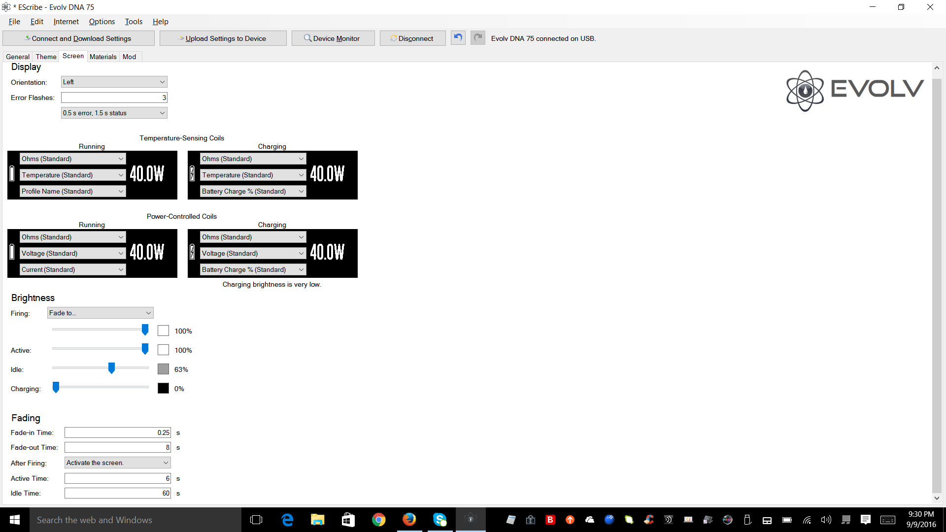

retird Posted September 10, 2016 Report Posted September 10, 2016 So when you have only default settings (no changes made whatsoever) on the Theme Tab and on the Screen Tab it still never sleeps? Can you post screenshots of the Theme and Screen Tab's showing all DEFAULT Settings?
helloimage Posted September 10, 2016 Author Report Posted September 10, 2016 retird said:So when you have only default settings (no changes made whatsoever) on the Theme Tab and on the Screen Tab it still never sleeps? Can you post screenshots of the Theme and Screen Tab's showing all DEFAULT Settings? Sure, here they are (Uploaded to Device, soft reset, and hard reset performed.)The only thing is, this default profile will 'appear' as though it sleeps because the <Charging Brightness> = 0. So, if I change the <Charging Brightness> to greater than 0, this would be the only way to test my case.
retird Posted September 10, 2016 Report Posted September 10, 2016 OK, when you change only the Charging brightness to 50% what happens? What does it do while plugged in to charge and also not plugged in to charge?
helloimage Posted September 10, 2016 Author Report Posted September 10, 2016 When plugged in, it acts as expected. Remaining in charging display mode with 50% and bolt through battery. When unplugged, it does the same as above with no bolt through the battery. Never sleeping after 60s.
retird Posted September 10, 2016 Report Posted September 10, 2016 Ok, I am doing the same thing here as you are doing there. When plugged in to charge it is doing what it should and you should see a red LED light (and lightning bolt) while charging turning to green (and no lightning bolt) when charged. With the Charge brightness set at 50% and not plugged in to charge the screen should go out after 60 seconds or so. So the original ecig file that came installed in the device has not been changed? If it has then it may be the ecig file you installed may have an issue. If the ecig file wasn't replaced from the original then you may have a board issue. That's my best guess from what you are seeing. Has it done this from the start as a brand new device?What device is your DNA75?
