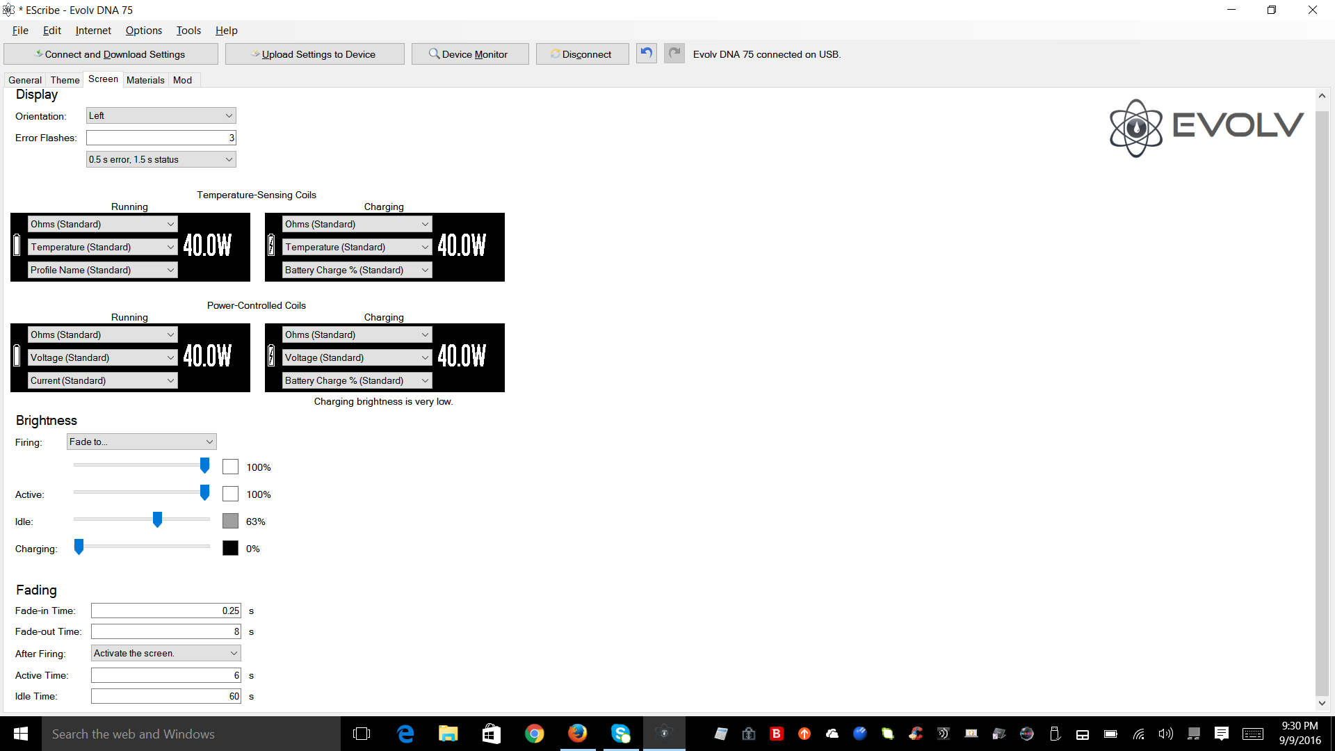

Sure, here they are (Uploaded to Device, soft reset, and hard reset performed.)The only thing is, this default profile will 'appear' as though it sleeps because the <Charging Brightness> = 0. So, if I change the <Charging Brightness> to greater than 0, this would be the only way to test my case. -

Thanks for the info. Which settings did you revert in escribe? The defaults on the general tab, or the defaults on the Theme page? Unfortunately, I tried restoring defaults on the general tab, but the defaults have Charging brightness = 0. This only hides my problem, as the mod looks as though it sleeps, but is in 'charging mode.' -

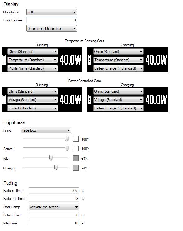

Howdy! Hope someone can assist. I'm having issues with my DNA75 not ever "sleeping." settings are as follows. After 10 seconds, my dna75 goes into the charging screen (not connected to USB and no bolt through the batt.) Although, the bolt is present and my display switches to the 'charging' profile when I plug the device to a power supply. All that works. My issue: It will never 'sleep.' There are two main screens (From screen tab in escribe): 1. While Running 2. While charging I'm getting the 'While Charging' screen after firing and idle times! And the mod never sleeps. - I understand the device doesn't ever power down - I have no USB cable connected - I have hard/soft reset - I have re-flashed 05 and 06 firmware versions - used escribe deployed with DNA75s and the latest 1.2 - reset default profile, loaded various others From the above screen shot of the 'screen settings: 1. Mod fires (Brightness=100) 2. at t=6 goes idle (Brightness=63) 3. at t=10 it should sleep.......But it doesn't. ---------it goes to the 'while charging' display (Brightness=74) and NEVER sleeps potentially the cause of a drained battery over night. Just not sure why my screen never sleeps, is this by design? Any idea on cause or any troubleshooting tips? Thanks in advance, folks!
