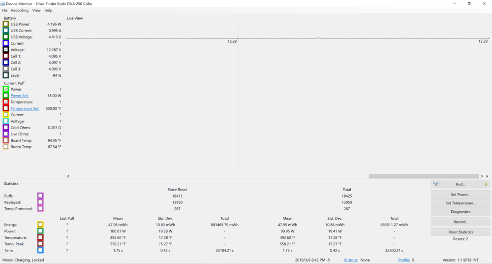

	Hello, I have two Thinkvape Finder 250c and 1 lostvape drone 250c. On both of my Finder when I put full battery, my mods show the battery at around 4.14 volts. Only for testing I put 2 of the 3 battery in my lostvape drone it shows battery at 4.19 volts. Is there something that could cause this on both of my Finder 250c?
	Ni80 isn't supported by Replay. Try using stainless steel
	There we go. At 4.09 volts for each battery, i removed my battery then put them back and i wasn't able to turn on the device. Plug it in my PC to take the screenshot and it turn on as soon as i plugged it in
