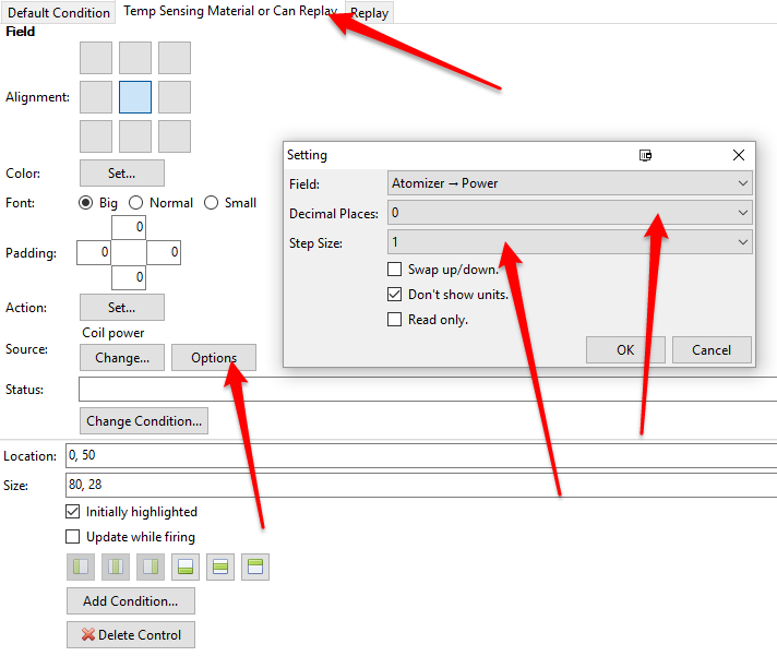

It's a tricky one to explain and not very intuitive. But in the theme designer, 1. Go to the screen that has the wattage displayed. You may have to select the tab 'Temp Sensing Material or Can Replay' depending how the theme is set up. 2. Click on the watts number 3. Click on 'options' under 'source' 4. Change decimal places to '0' 5. Change step size to '1' If you'd rather, I'm happy to change it for you if you save the theme you're using and post the file on this thread. I can amend and post it in a reply.

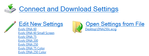

Does your PC make the USB device plugged in noise when you attach it? If not, you may be using a charge only cable. Your Escribe should look like this when you open it if you have downloaded and installed the one from the link above.
I tried the administrator thing and it didn't work. It's the version of Escribe you're using. Mine works A+ now. I know this as it's given me a headache already
